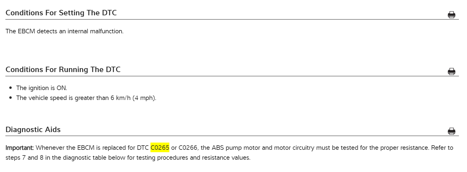

Here are the codes that came up for my ABS: CO222 which says Right Front Wheel Speed Signal missing. CO226 which says Left Front Wheel Speed Signal missing and CO265 which says Solenoid Control Monitor Error. My family mechanic thinks the first two codes are a result of the third code. Any suggestion on how to fix this. In case a new rep reads this I did have both front sensors replaced but the ABS light won't go off.

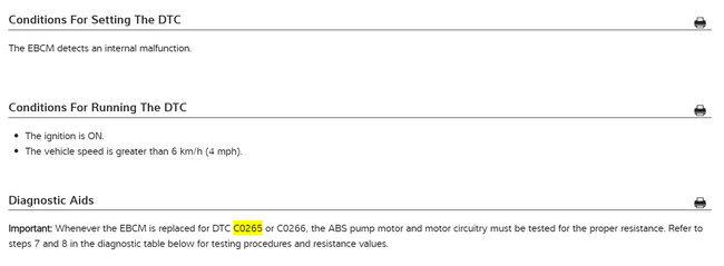

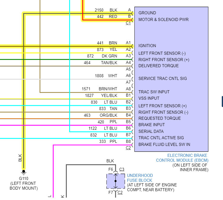

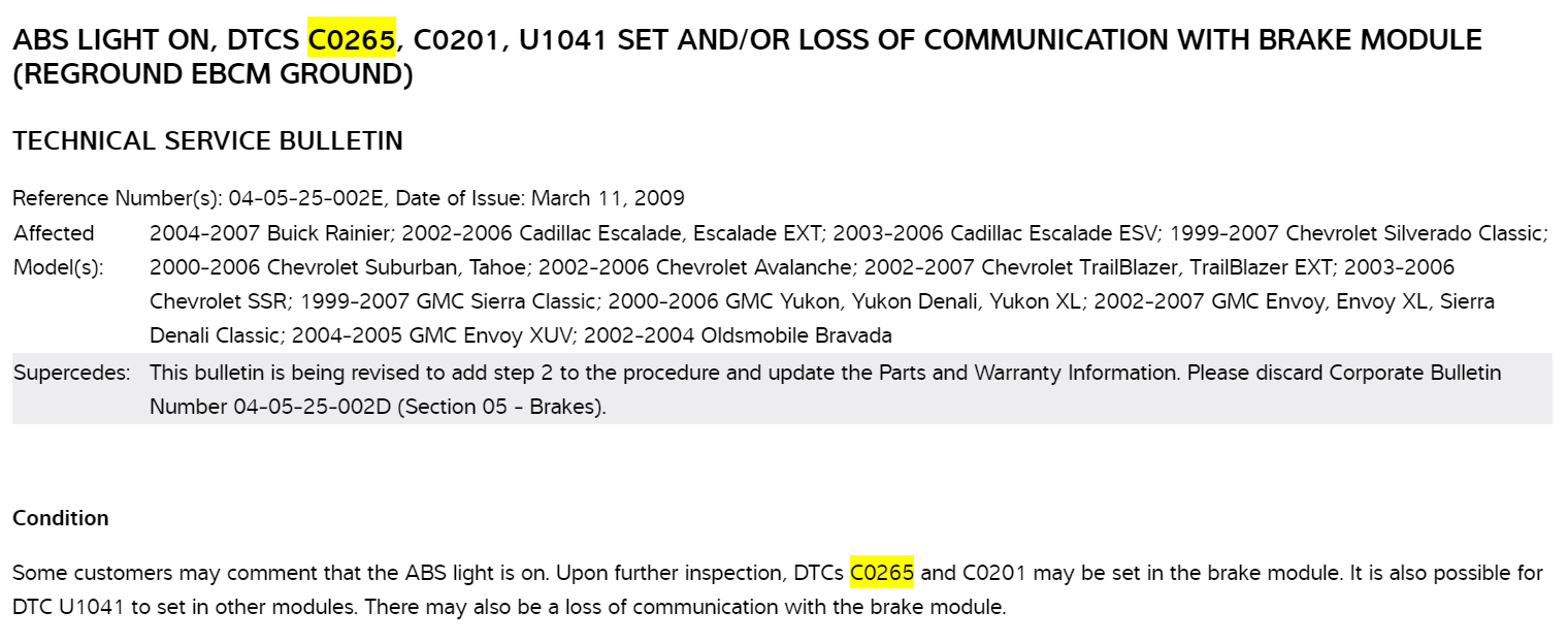

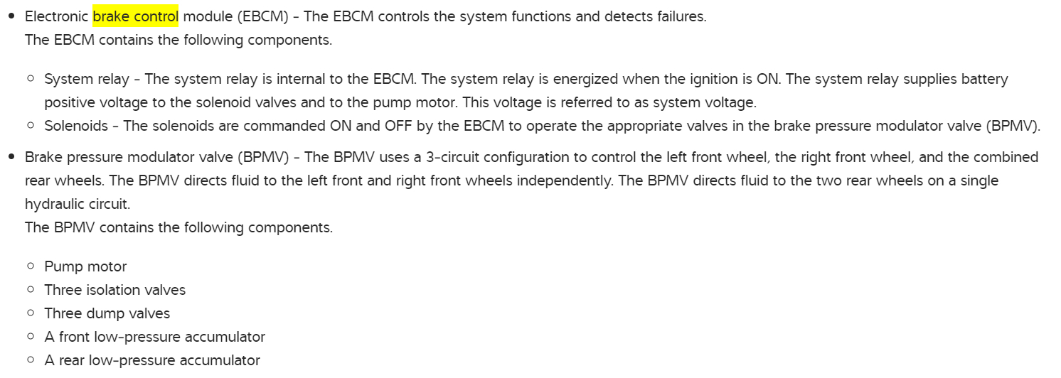

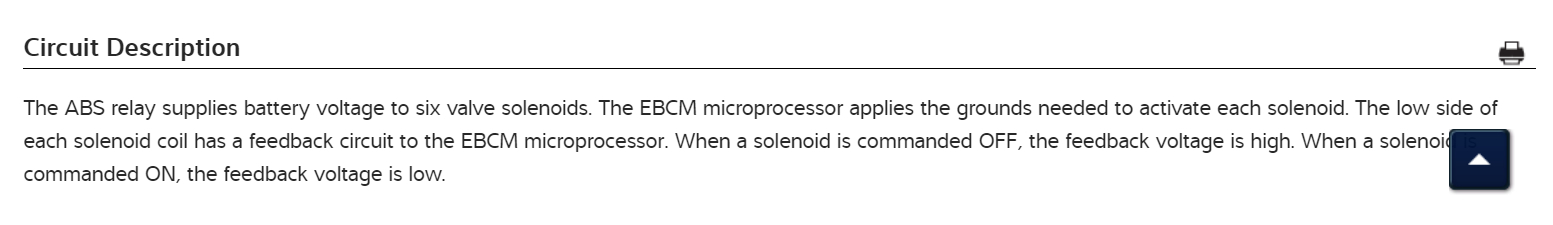

Hello, yes your family mechanic is correct. Each solenoid in the abs module is monitored by a feedback circuit as described in the 1st diagram below. The last code is an internal malfunction in the abs module of EBCM. Replacing the wheel sensors wont fix this issue. And the most ABS modules need to be programmed after installation and bled properly with a scantool that can open up the solenoids inside the abs module. The first 2 codes are for wheel sensors, but if the module itself has failed somehow, it can trigger codes for wheel sensors just because it cant read them properly. But the power and ground circuits to the abs module should be checked first before replacing it. If there is a wiring issue and its not getting power, this can be seen as a failure as well. Ill post the wiring diagram for the ABS circuits,

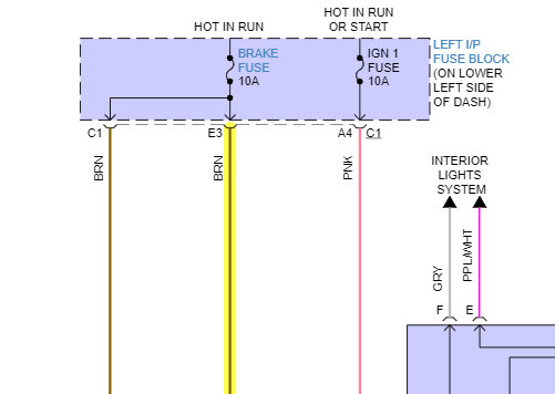

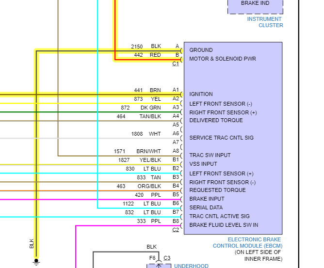

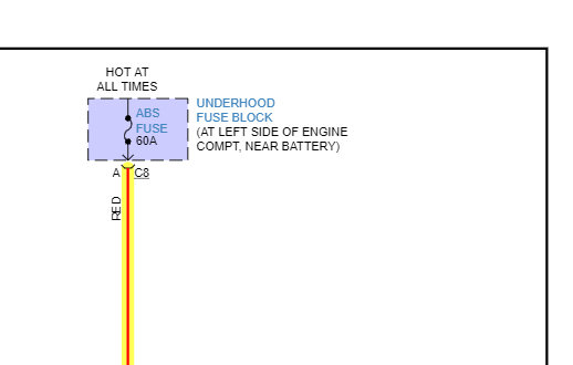

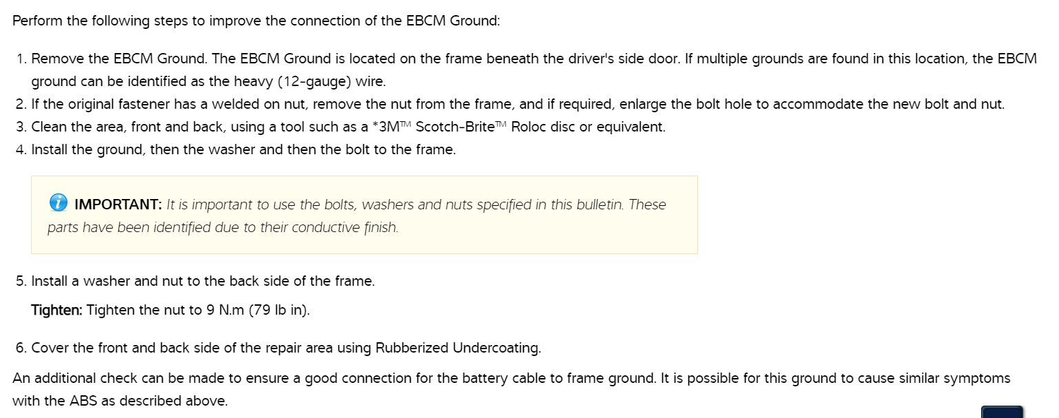

*Edit here are the powers and ground circuits for the ABS module. pics 4,5,6,7
The Red wire is 12volts all the time, The Brown wire is 12v with the Key in the On position and the Black wire is the Ground going to the body somewhere near the ABS module. These should all be tested while the vehicle is running so that the circuits are loaded. And a voltage drop test is the proper method.

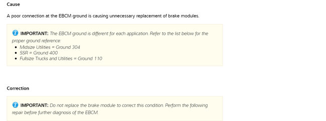

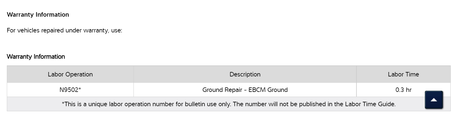

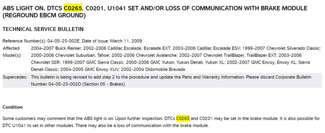

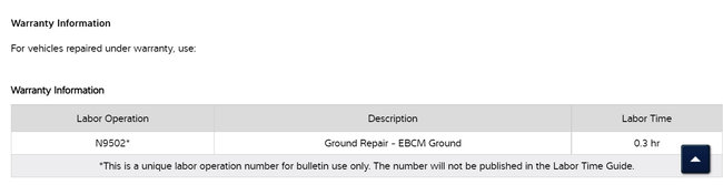

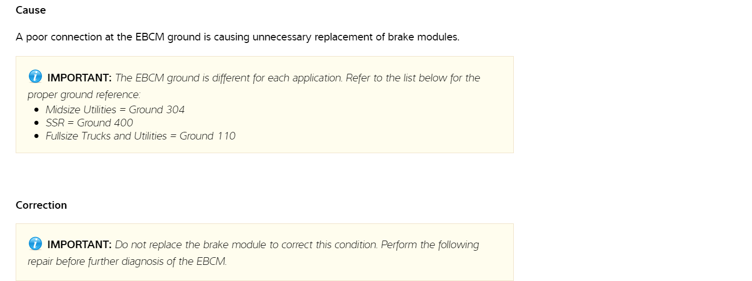

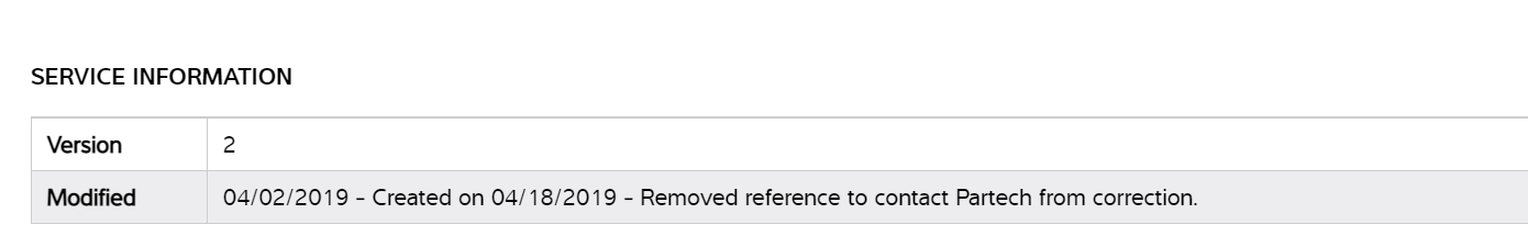

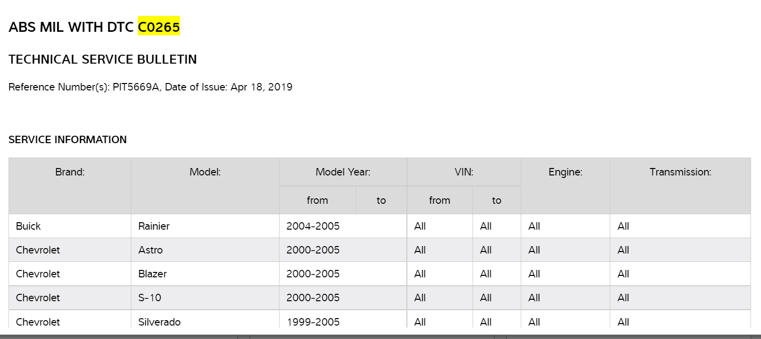

*Edit Actually there is a Technical Service Bulletin on this issue. These are for lose of communication issues and setting of code P0265.
Looks like they might have a grounding issue on the body and some other problems.

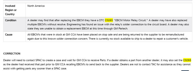

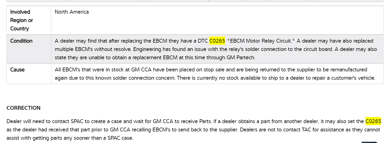

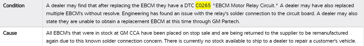

*Edit, This last Bulletin is an interesting one, seems they have found a bad soder joint on the circuit board and recalled a bunch of units. This would be the last diagram below. I found that one to be of the most important part of the TSB's.
There seems to be alot of instances and reasons for this last code(p0265), So a full check of the abs module itself should be done as well as a check of the wiring harness.

Yes, the solenoids are inside the ABS hydraulic module, usually there's 2 or 3 solenoids per wheel, and the module monitors those solenoids by a feedback circuit. So, it's basically just watching the current flow and can detect a problem from there.
