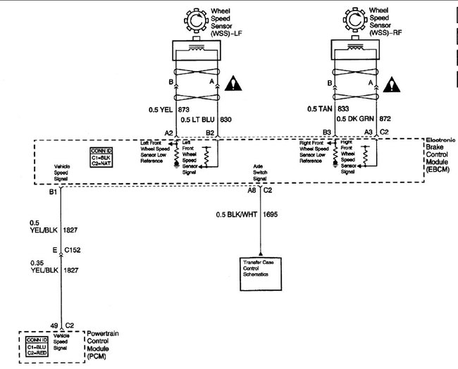

My ABS light with brake light would come on. I could turn the truck off and they would not appear for several hours or even a few days. I had the sensors replaced but now the ABS light comes on and stays on. I called AC Delco and it is the right one for my truck. I did disconnect both batteries to try to reset the computer but that did not help. In the past I have dealt with Steve with 2CarPros.
May 14, 2021 at 8:13 AM
STEVE W.
  • 15,329 POSTS
The description sounds like a bad circuit from a sensor to the ABS module. To see what the module is seeing will take a scan tool that can read live data and the codes. With the scan tool you can read the speed information from the sensors and see if the signal is getting to the module. There are three sensors in the system, One at each front wheel and one on the transfer case to show the rear wheel speeds. A scan tool can read the data from all 3.
With the code and scan data it would be easy to track the issue.

New sensors already installed. That is why I would like him to get a scan tool that can read the live speed data from the sensors. With that you can actually see what the module is seeing. Codes are not going to do much if this is the typical harness issue on those trucks as it shorts out in the harness and shows a bad sensor. The ABS doesn't have very good diagnostics on the 02s so the live data works much better in showing any speed differences from the three sensors it has, unfortunately most of the lower end tools don't show that data, they will only pull codes.
The best solution would be to go to the ABS module and use a scope to look at the actual signal waveforms as that can tell you pretty much everything including if the issue is a bad tone ring because the wave will have flat spots where there should be an AC signal from the sensors. A really neat way to test these is to pull the sensor connector and send a square wave signal through the harness. Then read the speed it shows on the scan tool. Now alter the frequency and you can watch the speed change. If that works, the wiring and module are good but there is an issue with the sensor. Either rust jacking or a bad sensor.

Do you know the codes? Many had the rust jacking and others were the wiring harnesses that would fail just up past the first connector where the sensors plug in. I assume the rebuild took care of the issue?
