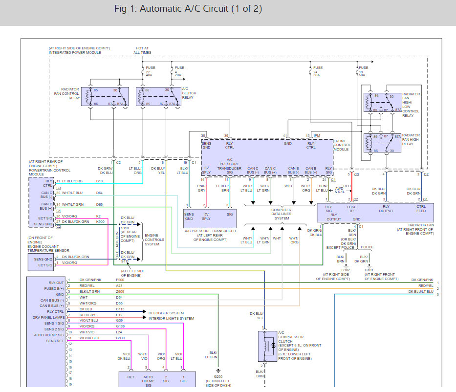

Started making a clicking noise every once in awhile. Then the A/C stopped working correctly. It blows cold up front and hot in the back. I changed the part for the blend door and it still doing the same thing. It did not change just a little. Need help trouble shooting my A/C problem. Thanks
Jul 14, 2018 at 6:53 AM
  • 55,433 POSTS

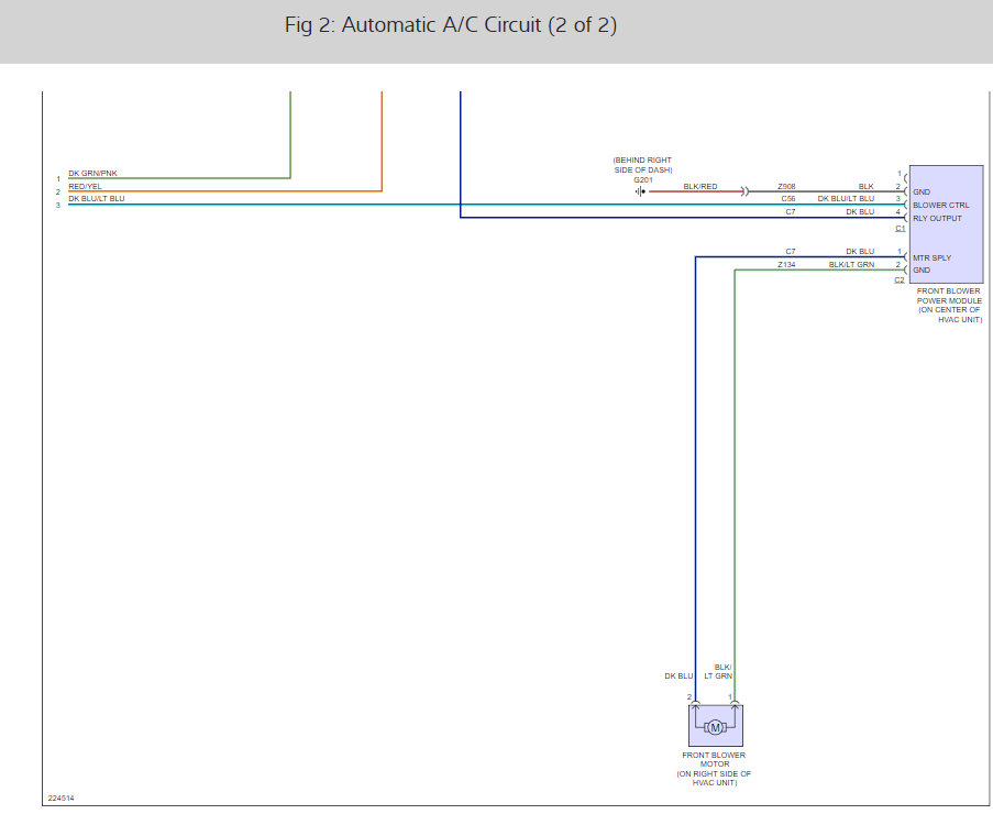

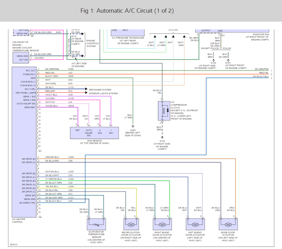

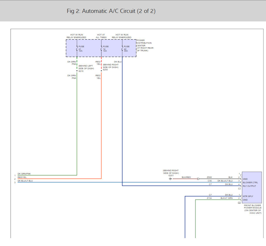

Back? Does this car have rear AC? Here is the wiring diagrams for the system and I do not see one? Can you shoot a picture and upload it here so I can see what you are talking about?
Check out the diagrams (below). Please let us know what you find.
