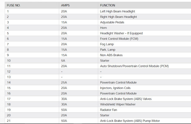

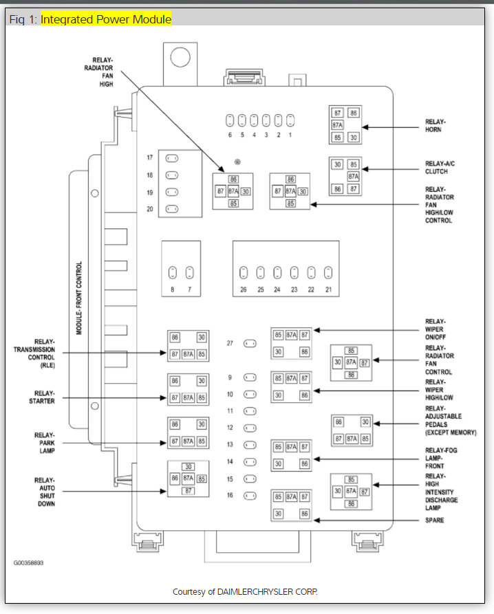

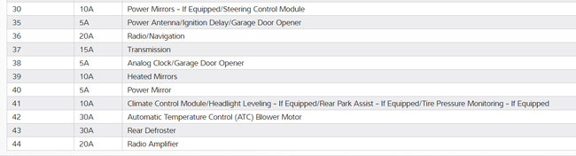

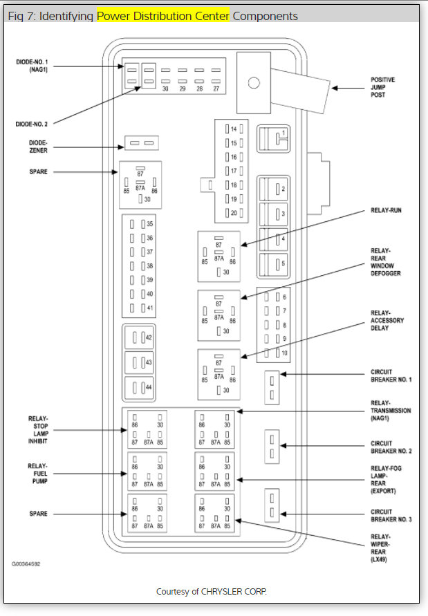

If the charge is okay then I would check the air conditioner fuse and compressor relay
