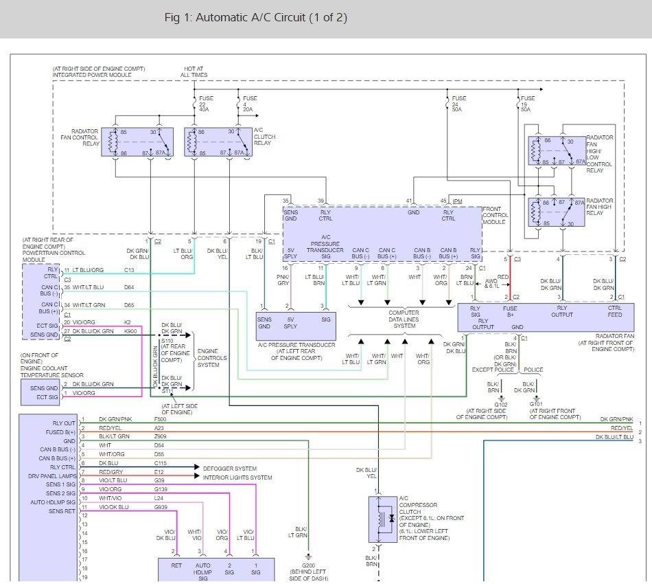

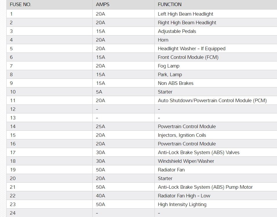

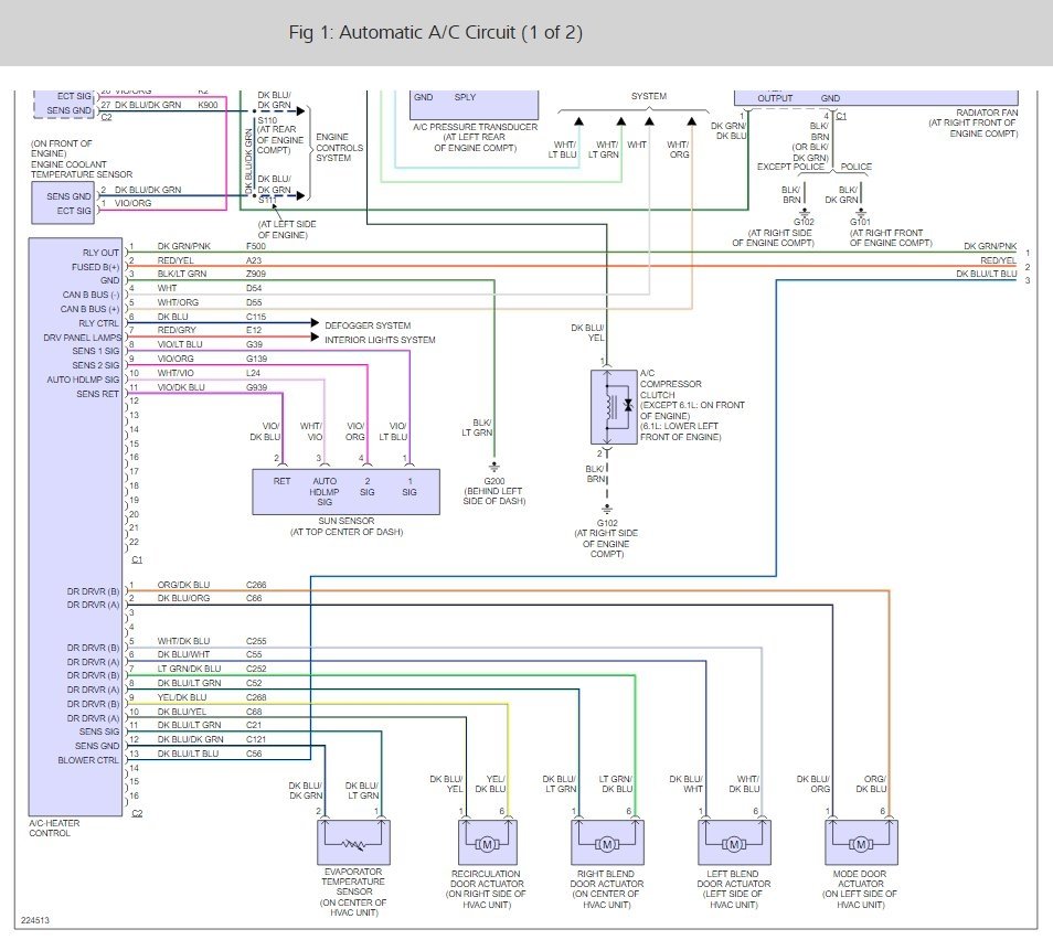

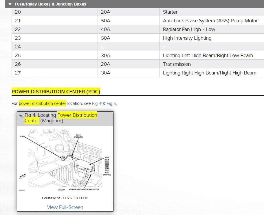

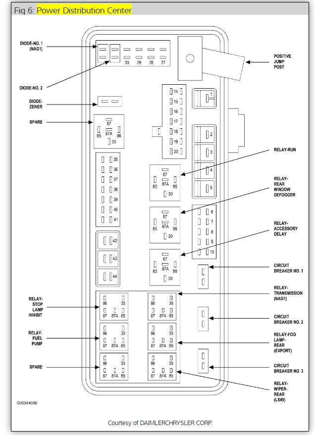

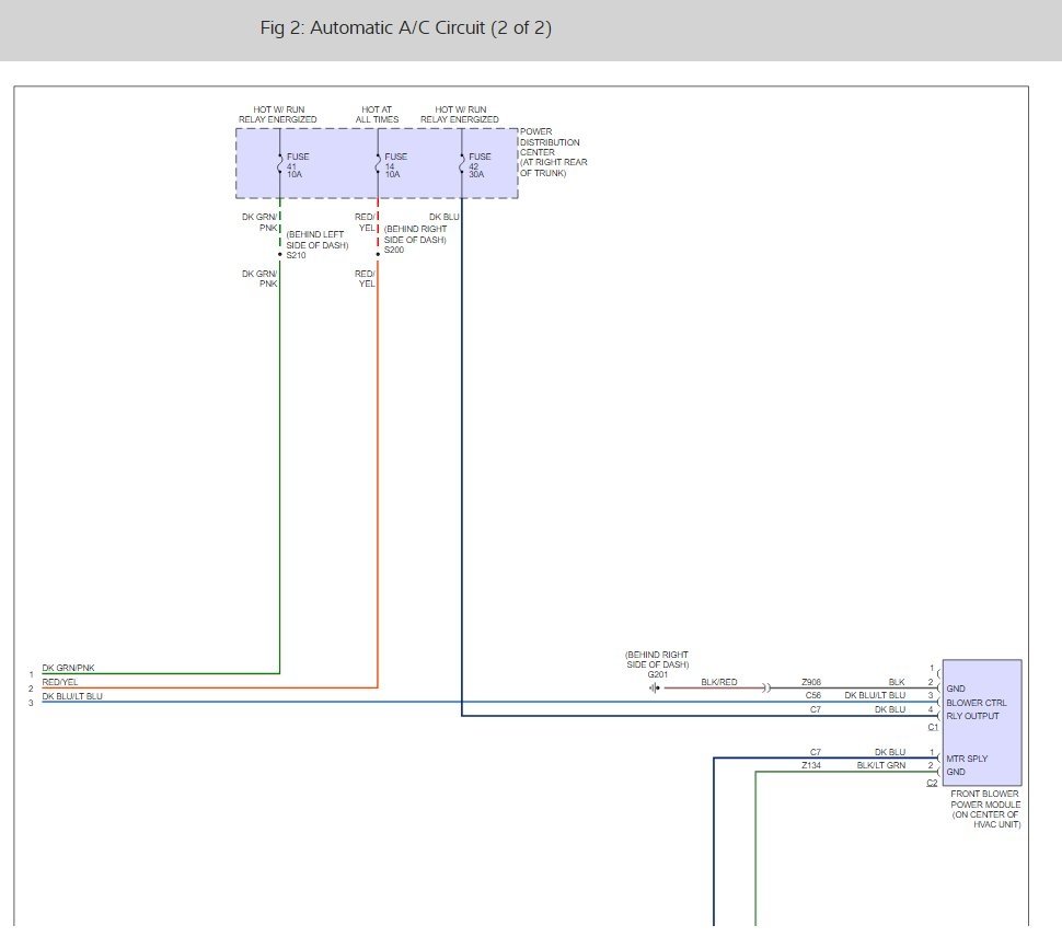

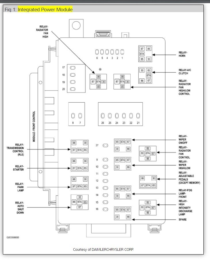

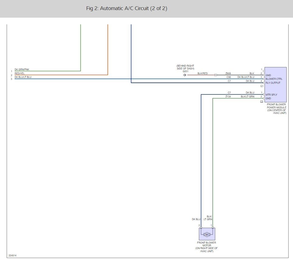

The air compressor does not run. is there a fuse for that and where is it located?
Jun 20, 2017 at 9:24 AM
  • 55,770 POSTS
I have found the fuse and relay locations for you along with the air conditioner wiring diagrams (BELOW) Here are a couple of guides to get you started in the right direction.
and
Please run some tests and get back to us so we can continue helping you. Check out the diagrams (Below). Please let us know what you find. We are interested to see what it is.
