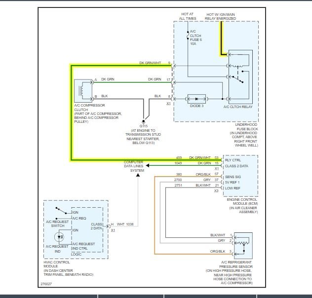

Did you verify power to the control side of the relay? I will attach a wiring diagram for you to view.

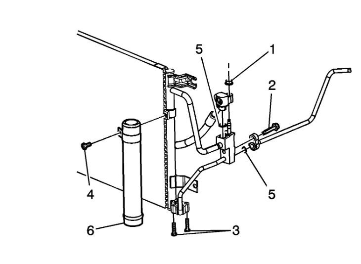

Also, the low side is way too high. It should be 25-30 lbs. Did you change the accumulator as well?

The accumulator is required once the system is opened.

I will check it when I get home this afternoon and let you know. The accumulator is mounted on the drivers side of the condenser coil correct?
Jul 19, 2019 at 6:54 AM
Nope, looks like it is on the condenser for your truck.

Yes, that is where I was talking about.
Jul 19, 2019 at 2:43 PM
Yep, be careful removing it. It is common for the bolts to seize when releasing the dryer.

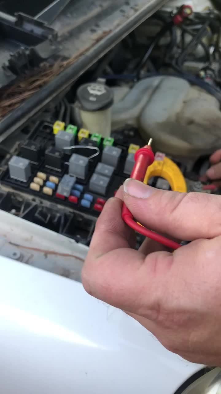

JASON123177
  • 27 POSTS

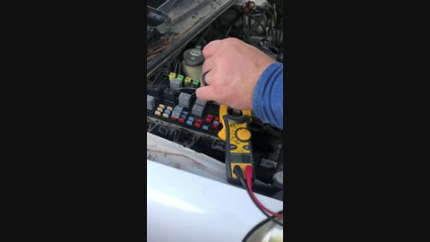

I have 13vdc at pin 86 and nothing at pin 85.
Jul 19, 2019 at 2:57 PM

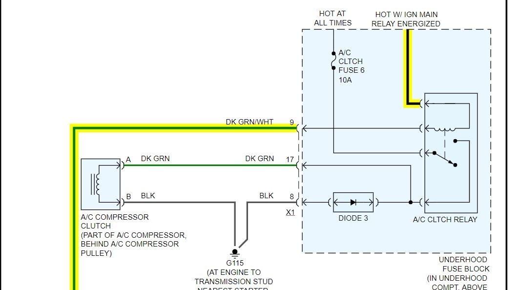

What about 30? Do you have the power there?
85 is the ground to the PCM. It will ground the control side when it sees the correct signals from the pressure switches.
Jul 19, 2019 at 3:02 PM
JASON123177
  • 27 POSTS
Pin 30 is 0 pin 87 is 13vdc.
Jul 19, 2019 at 3:04 PM
That's your problem. You should have power at 30 all the time.
check the wiring diagram I posted in the beginning. Check the AC clutch fuse for power on both sides with a test light or voltmeter.
Jul 19, 2019 at 3:11 PM
JASON123177
  • 27 POSTS
There isn’t power on either side of the clutch fuse.
Jul 19, 2019 at 3:14 PM
JASON123177
  • 27 POSTS
I am going to post a video of me checking the pins. Something weird is going on.
Jul 19, 2019 at 3:22 PM
Okay, if there is no power to the fuse, the fuse box is the failure. It is common for failed fuses boxes with GM.
Jul 19, 2019 at 3:28 PM
JASON123177
  • 27 POSTS
When I connect to the battery ground, it does show power on both sides of the fuse. But, when I ground to the ground on the side of the fuse box it shows no power to either side of the fuse. The video is of me testing the relay plug off of the battery ground and the ground on the side of the fuse box.
Jul 19, 2019 at 3:37 PM
You need to put the black wire to the battery ground. Then test for voltage to the fuse with the fuse installed. You need power on both sides.
If you have power, then you have a wiring issue from the fuse to the relay terminal 30.

Were you able to watch the video of me testing the relay plug?
Jul 19, 2019 at 3:42 PM
Yes but it looked like the fuse was out.
Jul 19, 2019 at 3:44 PM
JASON123177
  • 27 POSTS
The clutch fuse was in. The relay was out.

JASON123177
  • 27 POSTS
Okay. That’s fine. So, with the engine running and A/C on, pins 85 and 30 have power. Pins 86 and 87 do not.
Jul 19, 2019 at 3:57 PM
They will not. 87 goes to the clutch when the relay energizes.
86 is a ground to the PCM. It will ground the relay when it sees the correct signal from the switches.
Do you have a scan tool to view the A/C system and see if the signals from the switches are getting to the PCM?

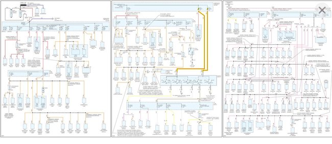

In step 5 of circuit/system testing, there is always voltage between terminal 30 and 87. So, how do I find where the short is?
Jul 25, 2019 at 5:14 PM
30 is battery powered. 87 goes to the load.
Jul 25, 2019 at 5:38 PM
JASON123177
  • 27 POSTS
Ok, I know that I have been a bit confusing because I didn’t really know what I was doing when it came to testing the electrical part of this system. But, I think I have figured it out after doing some studying. So, terminal 30 always has 14.2vdc when key is on. Terminal 86 has 14.2vdc when there is demand for A/C and 0vdc when there is not. I am thinking that those voltages are what they’re supposed to be. So, there is an issue between terminal 85 and the pcm. The pcm isn’t allowing the circuit to be complete between terminals 85 and 86 for some reason and not allowing the switch to close between pins 30 and 87 in the relay. Therefore the pcm isn’t providing the ground to complete the circuit between terminals 85 and 86. The circuit from the compressor to terminal 87 has to be complete because the compressor runs when 30 is jumped over to 87. This is where the pressure transducer comes in to play correct? But, the pressures should be within operating range at 210psi on the high side and 50 psi on the low side. If there was a condition where something grounded out between terminal 85 and the pcm, electricity would still flow between pins 85 and 86 and cause the relay to close and the compressor clutch to engage. So, I am thinking that there is definitely a problem with the pcm. Please correct me if I am wrong.
Jul 25, 2019 at 7:47 PM
Correct. The PCM grounds the control side of the relay to power pin 87. It will do that when it sees the correct signal from the pressure switches.
Even when it does turn it on, the low side is incorrect. It is too high as I stated before.
Jul 26, 2019 at 4:29 AM

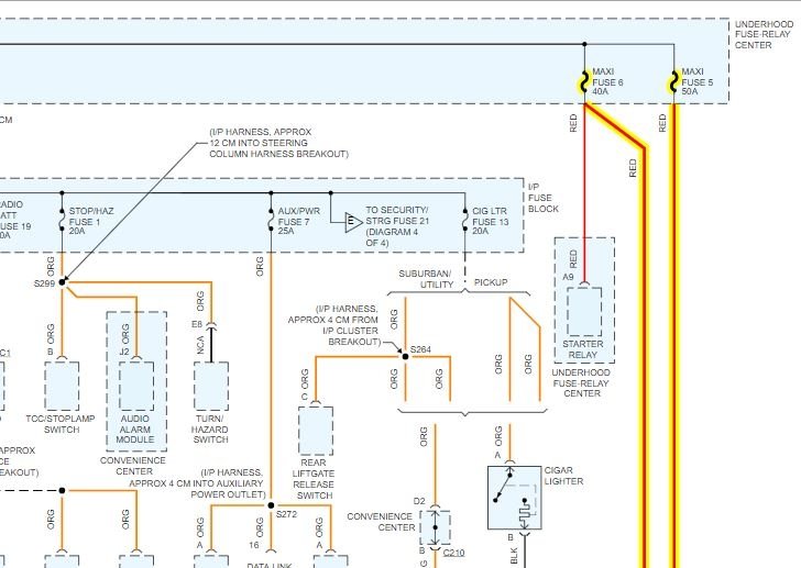

They come from maxi fuses. The actual fuse block may be the issue.

If I should be tracing down electrical issues, how would I test the fuse block. Also, the scan tool would not operate the A/C. It kept saying something to the effect of not being able to connect to the A/C system. But, it read the engine DTC’s
