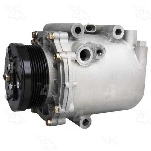

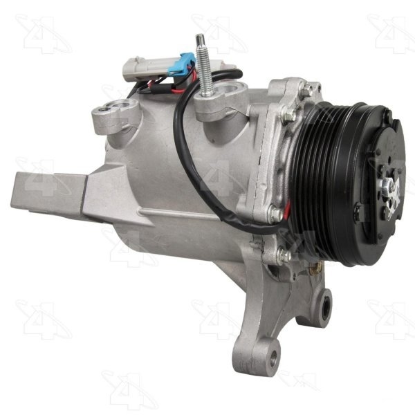

My A/C compressor is leaking. I have an old 2004 Montana with A/C that works. It is going to be junked. will the A/C components from the 2004 fit into my 2007?
Jun 18, 2017 at 9:22 AM
STEVE W.
  • 15,320 POSTS
No sorry, entirely different compressor design and mounting. See the pictures to see the difference.
