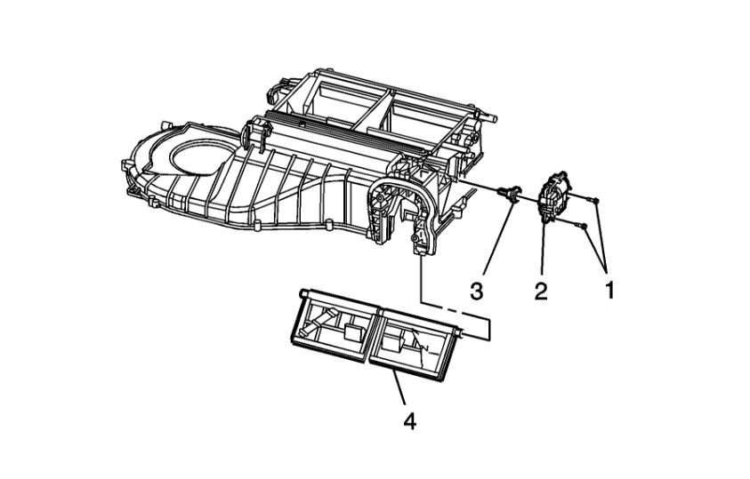

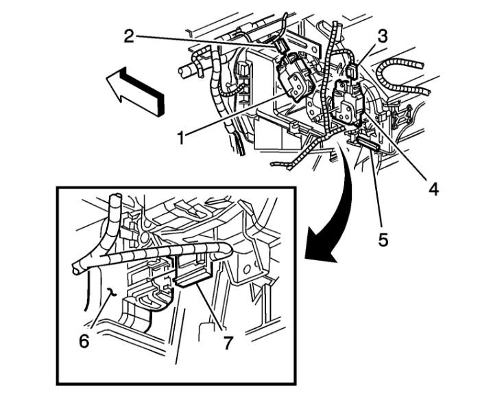

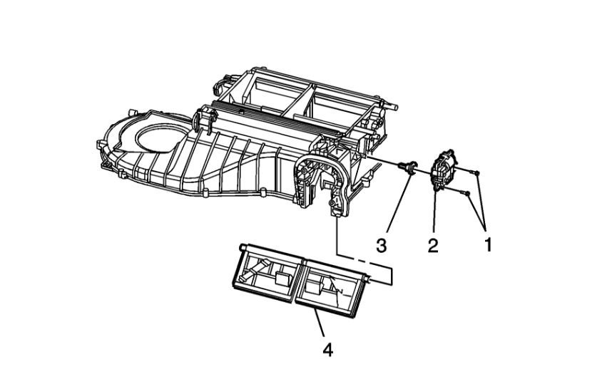

Good afternoon.
First, you need to have the pressures checked for the AC system. We need to be sure the pressures are correct.
The other thing is the blend door actuator in the front. Can you hear the mode door move when commanding heat and cold?
Air Temperature Actuator Replacement (Single Zone)
Removal Procedure
imageZoom/Print
1. Remove the driver side knee bolster.
2. Locate the air temperature actuator (6).
3. Disconnect the air temperature actuator electrical connector (7).
imageZoom/Print
4. Remove the air temperature actuator bolts/screws (1).
5. Remove the air temperature actuator (2).
6. Remove the air temperature actuator lever (3), if necessary.

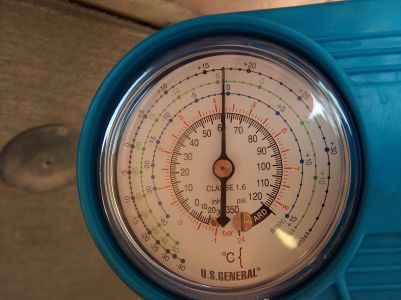

Air Conditioning problem 6 cyl Front Wheel Drive Automatic 96000 miles Hello, the A/C in my '07 Chevy Uplander (96,000 miles) has quit working. The A/C light inside turns on and under the hood the Compressor kicks on and seems to be running properly. The low side line is cold and the pressure (checked with one of those cheap gauges on top of a recharge can)(picture below
https://images.2carpros.com/forum/automotive_pictures/575763_GBM2CS_1.jpg
) shows at the top of the blue "filled" area. However, when I pulled the gauge off the port the refridgerant was green. Is this normal? I have had the vehicle since it had 36,000 miles on it and hasn't been serviced as far is I know.
Dec 7, 2020 at 8:32 AM (Merged)
DOCFIXIT
  • 18,828 POSTS
Hi to diagnose properly need to get a gauge set on system and see what high and low readings are. Look for shop in area that specializes in AC have a diagnosis done $20-$40. Then post results and will advise as to repair.

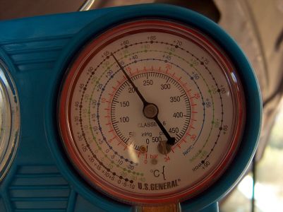

Hi, I put my (cheap) set of gauges on the system and am posting the pictures from the readings. Low Side: +17 (I hope the makes sense)
https://images.2carpros.com/forum/automotive_pictures/575763_HPIM8401_1.jpg
High Side: +56.25
https://images.2carpros.com/forum/automotive_pictures/575763_HPIM8402_1.jpg
Any thoughts on the pressure?

Low should be @ 35psi high needs to be @200psi. readings indicate low charge. Green is a dye placed in system to help ID leaks with use of black light.

I gave you the outer reading on my gauge (marked 134A) the inside marks are PSI. The High side is 210psi and low side is about 60psi. I think I figured out the problem though. It started working after I took the box around the heater core apart. I think that it isn't always directing the air around the heater when I turn the dial to the cold setting.
