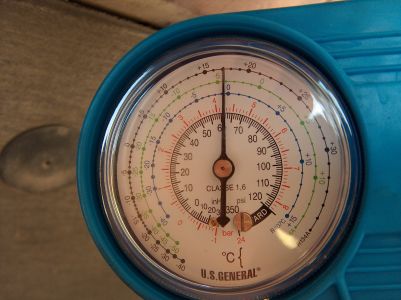

Hi, I put my (cheap) set of gauges on the system and am posting the pictures from the readings.
Low Side: +17 (I hope the makes sense)

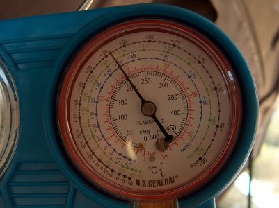

High Side: +56.25
https://www.2carpros.com/forum/automotive_pictures/575763_HPIM8402_1.jpg
Any thoughts on the pressure?

DOCFIXIT
  • 18,828 POSTS
Low should be @ 35psi high needs to be @200psi. Readings indicate low charge. Green is a dye placed in system to help ID leaks with use of black light.

DRRADKIN
I gave you the outer reading on my gauge (marked 134A) the inside marks are PSI. The High side is 210psi and low side is about 60psi. I think I figured out the problem though. It started working after I took the box around the heater core apart. I think that it isn't always directing the air around the heater when I turn the dial to the cold setting.
