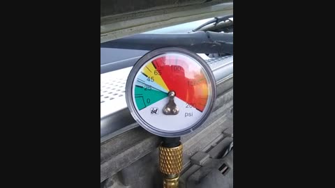

A/C system pushing out only partially cold air and compressor is short cycling.
Compressor cycling clutch engagement/disengagement every one to two seconds and pressure at the low-pressure port bounces/fluctuates between 20–40 PSI.
A/C system was allowed to run after engine start up on the MAX cab air re-circulation setting for a minimum of three minutes prior to the pressure reading being taken. Ambient temperature was about 75° with high humidity.
Considering that the pressure at the low-pressure port bounces between 20–40 PSI, would the poor cooling/compressor cycling likely just be due to the system being low on refrigerant and in need of a charge or would it be a safe bet to expect there to be other part/electrical problems involved?

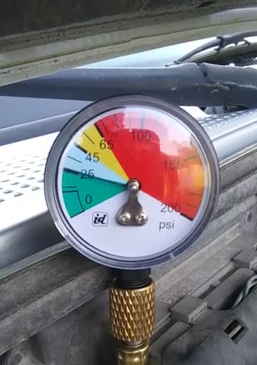

RDANNENFELSER
  • 43 POSTS
Can't check the high pressure since the gauge I used before was a loaner tool from O'Reilly Auto, but when I went to check the low pressure I realized that the compressor is still short cycling at times. Gauge on the low-pressure port is showing a fluctuation roughly between 25-40 PSI when compressor is short cycling and a steady 25 PSI when not cycling.

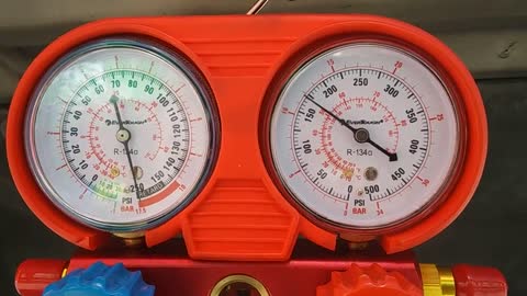

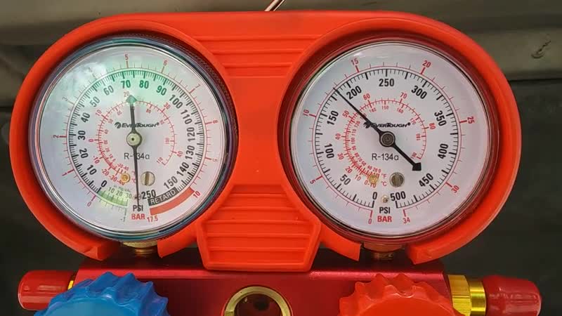

RDANNENFELSER
  • 43 POSTS
Was finally able to use an A/C manifold gauge set again to read the high pressure. What the gauges showed this time is definitely above my knowledge level in understanding what it indicates.
With the compressor cycling, the high pressure fluctuated approximately between 155-190 PSI while the low pressure fluctuated between 150-250 PSI in the retard area of the gauge. I've attached a short video of the gauges showing this.
Also, I checked the high and low pressures with the A/C manifold gauge set around 10:30 yesterday morning. Later on in the evening I decided to hook up just a basic Interdynamics gauge to read the low pressure just out of curiosity and the gauge showed a fluctuation between 25-40 PSI with the compressor cycling.
Jul 12, 2019 at 1:40 AM
Just to offer some suggestions on this as this is a common issue when you either have an overcharged system or there is a restriction in the system. We need to start with evacuating the system and pulling it into a vacuum to find out if it will hold a vacuum. Then when we recharge it, we need to find out how much freon it takes. If it takes the proper amount and still does not operate correctly then the compressor is most likely faulty.
Take a look at the chart below. This shows that when your low side is high what the possible cause is. However your system is not relieving the pressure on the low side which tells me you most likely have a restriction in the system.
