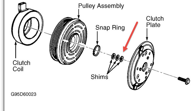

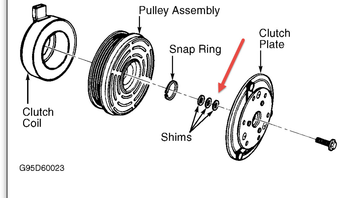

The clutch plates are grinding, turning when system is off, noisy.

Check to see if clearance on clutch plate is correct if not it will burn up. It should be .014-.033" measured in three places if not add shims. See picture.

Okay, That was useful information. Thank you.
