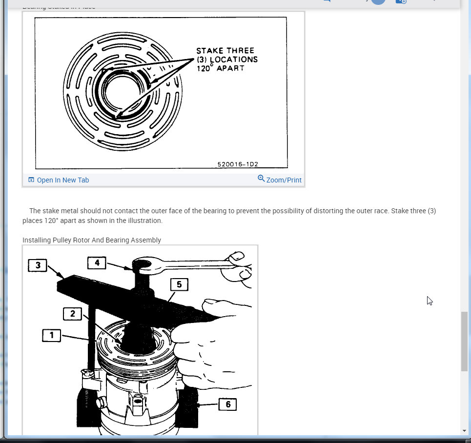

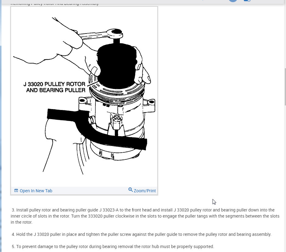

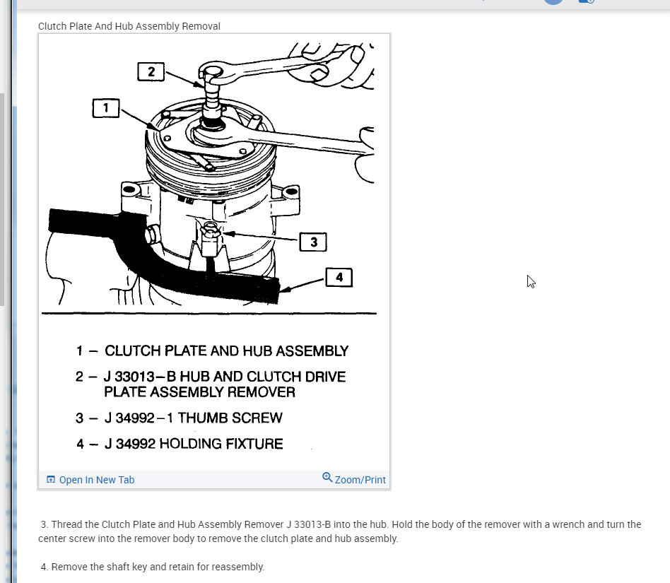

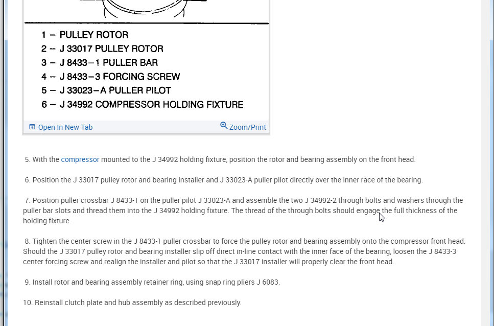

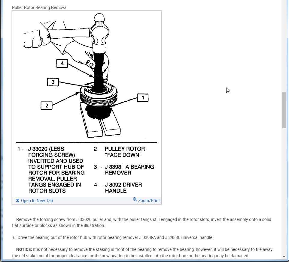

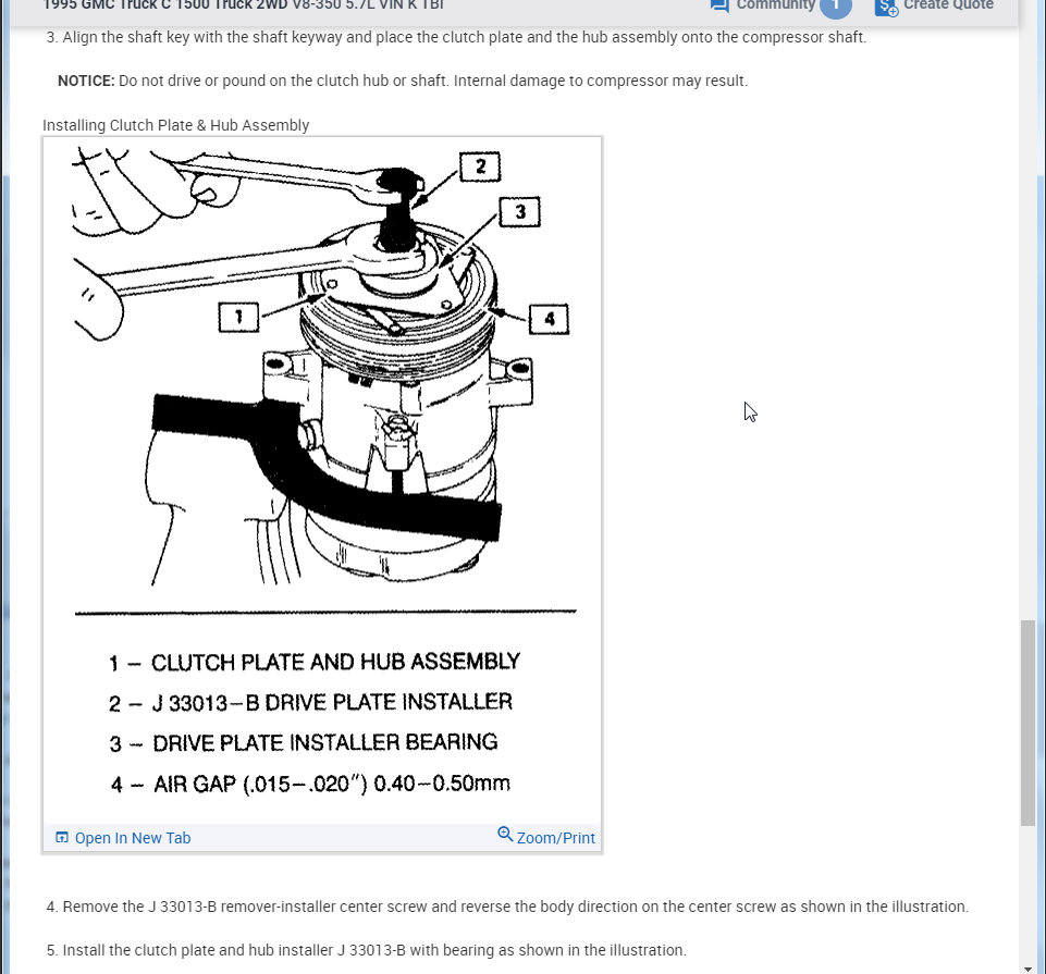

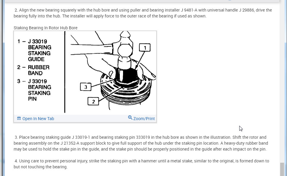

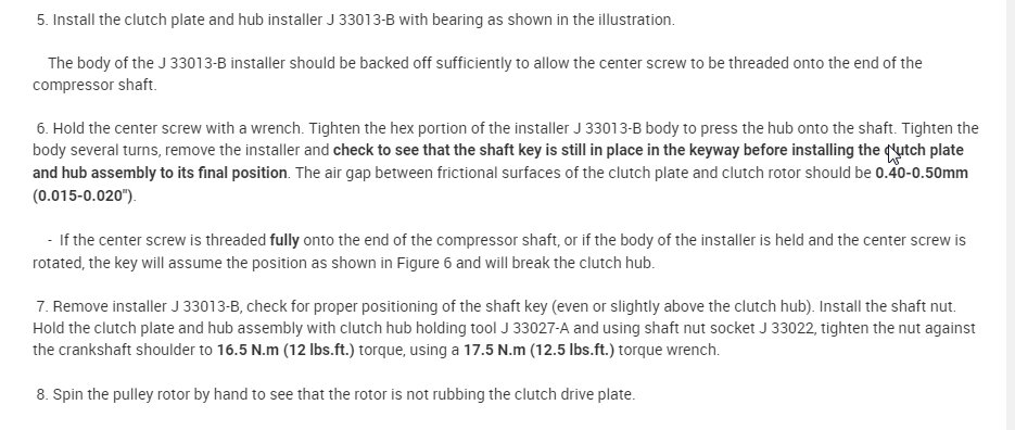

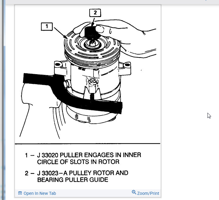

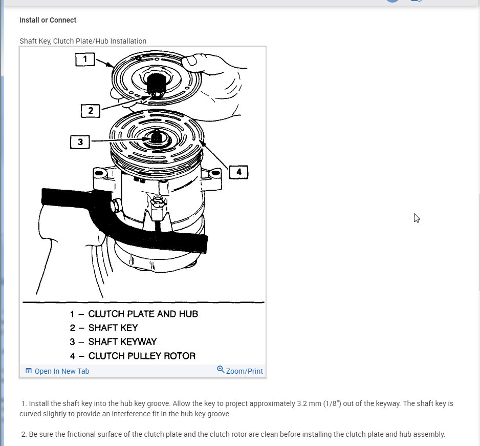

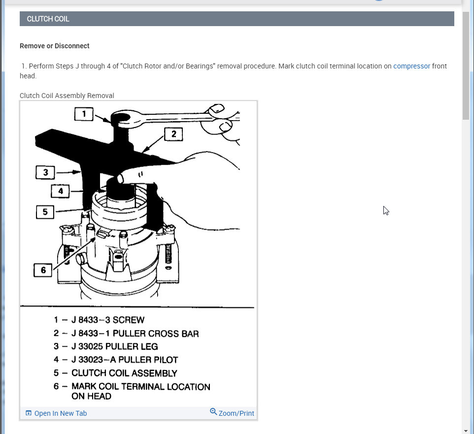

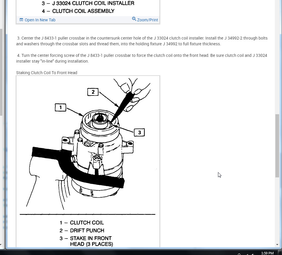

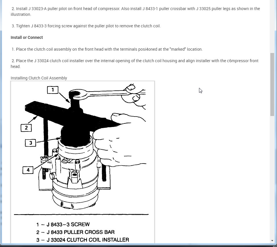

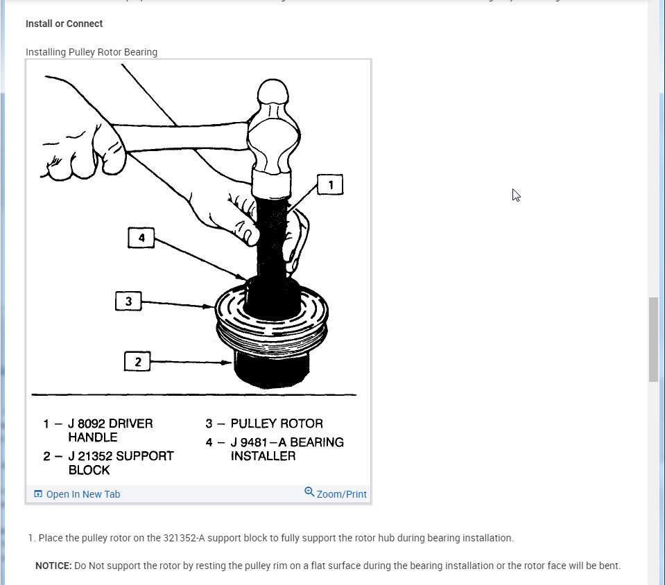

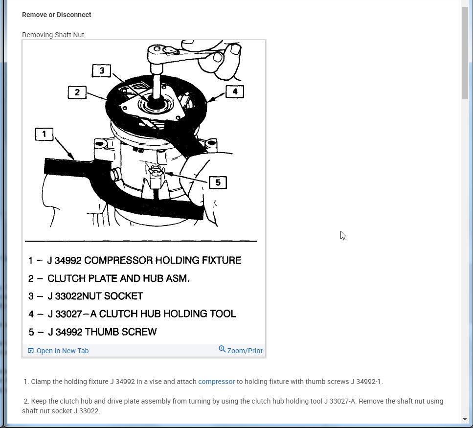

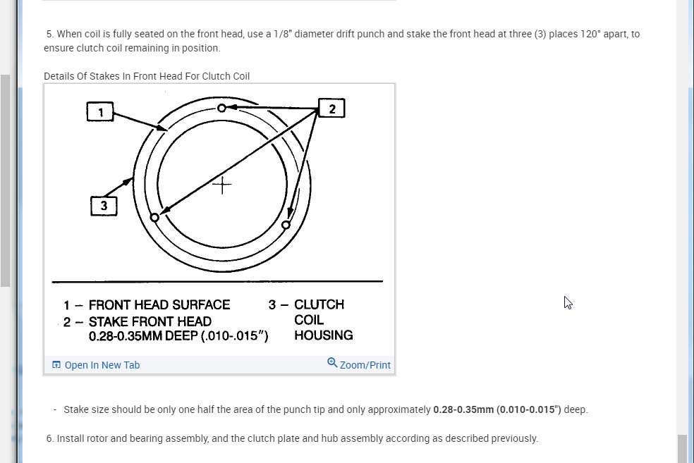

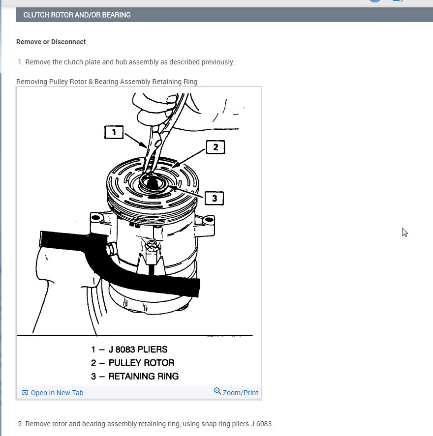

This points the compressor clutch that is failing. Eventually it will not engage even if you tap on it.
You have the option on this compressor to replace the clutch assembly but this is a considerable amount of work. It is cheaper then the entire compressor but the compressor replacement is easier.
https://www.2carpros.com/articles/replace-air-conditioner-compressor
If it were me, I would just replace the compressor but if you want to do the clutch assembly, I attached the process below. There is some overlap for each of these processes as they explain how to do each separate but you would want to do them all at the same time (obviously).

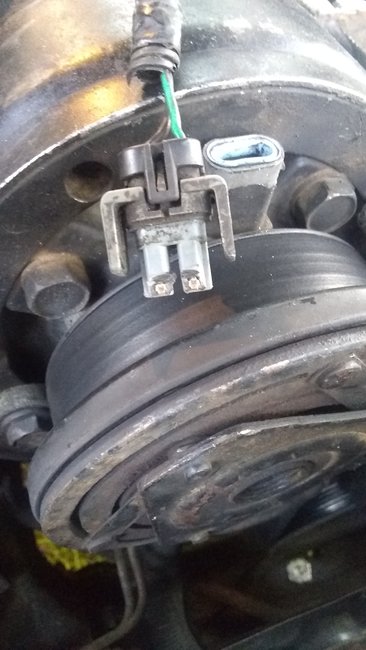

I only have test light and it shows continues voltage to clutch so I presume the ground is good. Correct?
I have enclosed pic of my clutch switch. Good or bad?
Could it be the clutch shims?

Just to answer your question, if you have voltage and the clutch does not engage then it is most likely the clutch or compressor. You can try and clean the contacts with electrical cleaner and brillo pad. However, due to it making noise and the fact that you press on it and it engages points to a clutch issue.

I don't know of I'm seeing this right but it looks like the plug is worn strangely. Those two round spots what are they? That's very suspect to me I would change the pigtail or at least verify that its making good connection when it's plugged in.
Tom

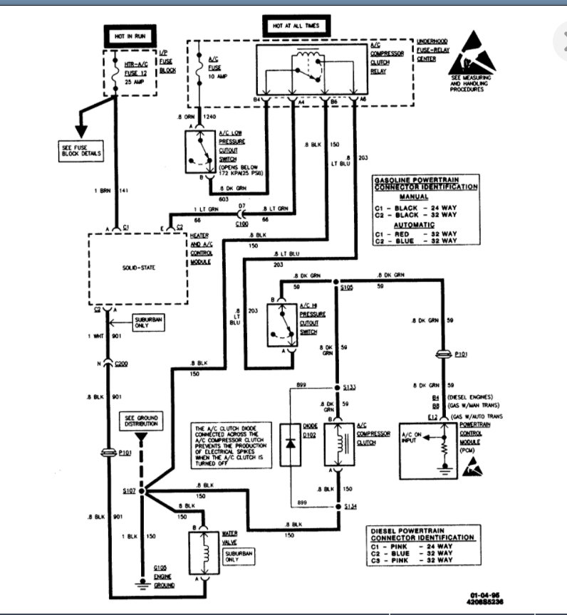

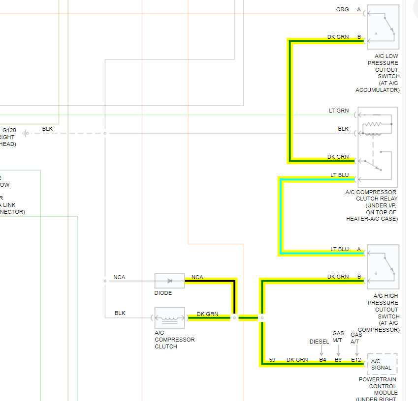

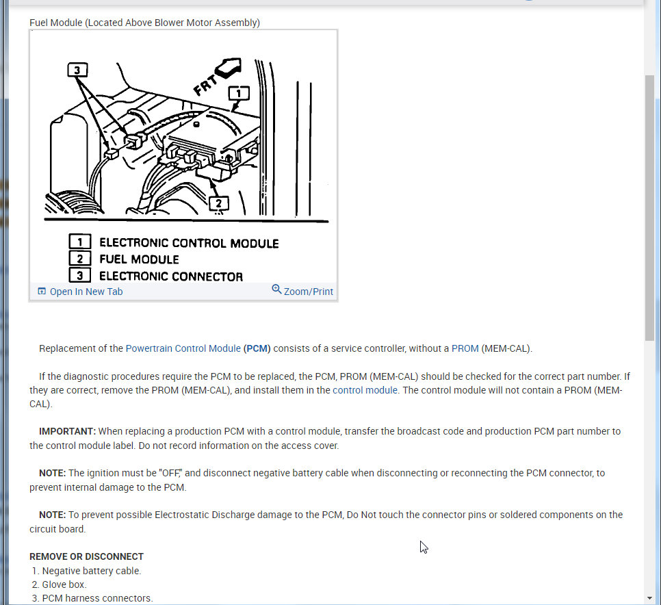

Okay. That is good. So just to run through the power flow for you to confirm this before we say to replace the PCM. I am switching to the OEM diagram because it is easier to follow this.
The AC fuse powers the system and the PCM controls it by grounding the entire circuit when it wants the compressor on. So when the power flows from the fuse, and the low pressure switch is closed, it closes the relay and sends power to the high pressure switch. If the high pressure switch is closed, it sends power to the compressor and at the same time through splice 105 to the PCM as the signal circuit. Clearly if the PCM is not grounding this then there is no power.
So you can test that the PCM is not grounding this by back pinning the PCM connector at E12 and connecting a wire to that pin and touching it to ground. Basically you are taking the place of the PCM and commanding this circuit on by grounding it. If the compressor comes on then the PCM is not grounding this and needs to be replaced.
Does that make sense?
Oct 22, 2020 at 8:21 AM

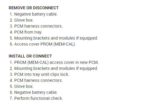

That is correct. I attached the process below for the PCM.
More then likely on all those systems they did not have what is called a low side driver. They were a high side driver. That means which side of the load is the control unit on? High side drivers are the control device is before the load. Low side is on the ground side of the load. So in this case, the control unit is the PCM and it is on the ground side of the load (the compressor) and so it is a low side driver.
If the control unit is on the high side then it sends the power and as long as the switches are closed, the power will get to the compressor as there is always a ground path.
On this system, you can jump the switch but that does not provide a path to ground because the PCM is not providing the ground. You need both the power and ground in order for a complete circuit.
Oct 22, 2020 at 10:52 AM

Thanks! I think this might be a little over my head or is it a simple procedure? Sure I can swap parts but is there re-programing to be done?

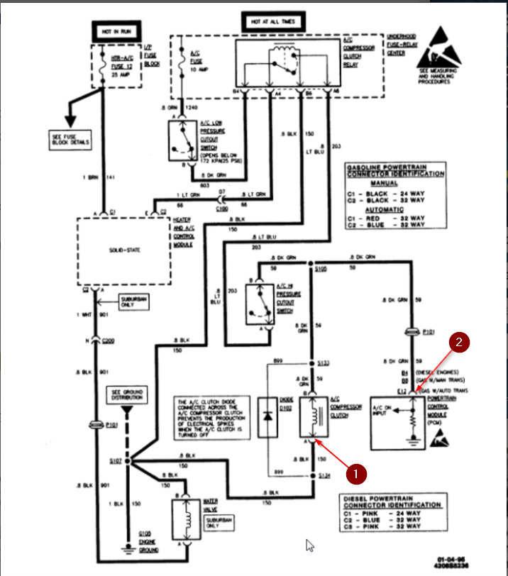

Okay. So that shows you have ground for the compressor. Have we confirmed the PCM is grounding the control circuit? Take a look at this attachment. You have confirmed ground at number 1. Number 2 is the PCM grounding the control circuit to turn the compressor on.
Let's do the same test with back probing the connector when you turn the A/C on.
