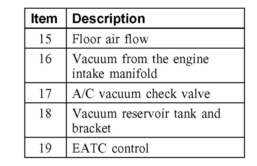

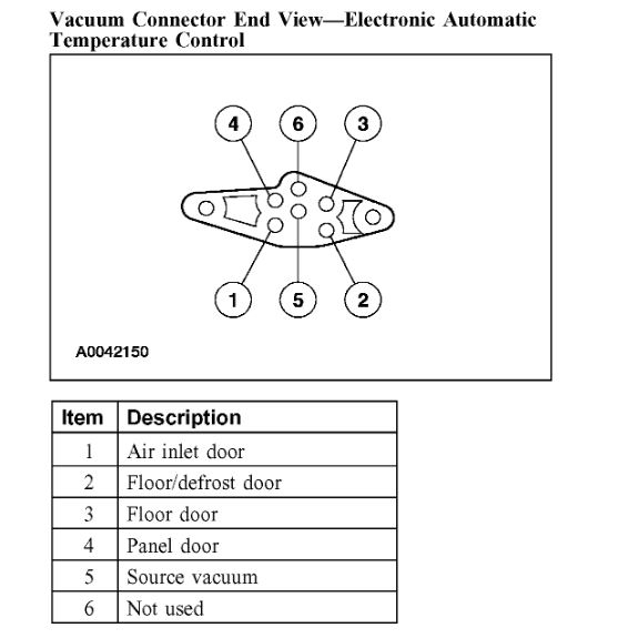

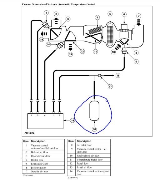

The system works on both vacuum motors and electronic actuators.
https://www.2carpros.com/articles/air-vents-stay-in-the-defrost-position

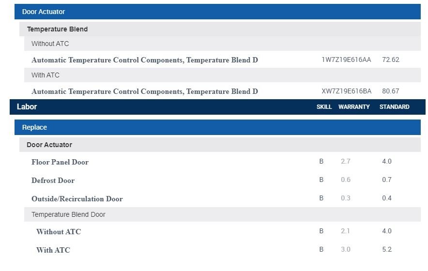

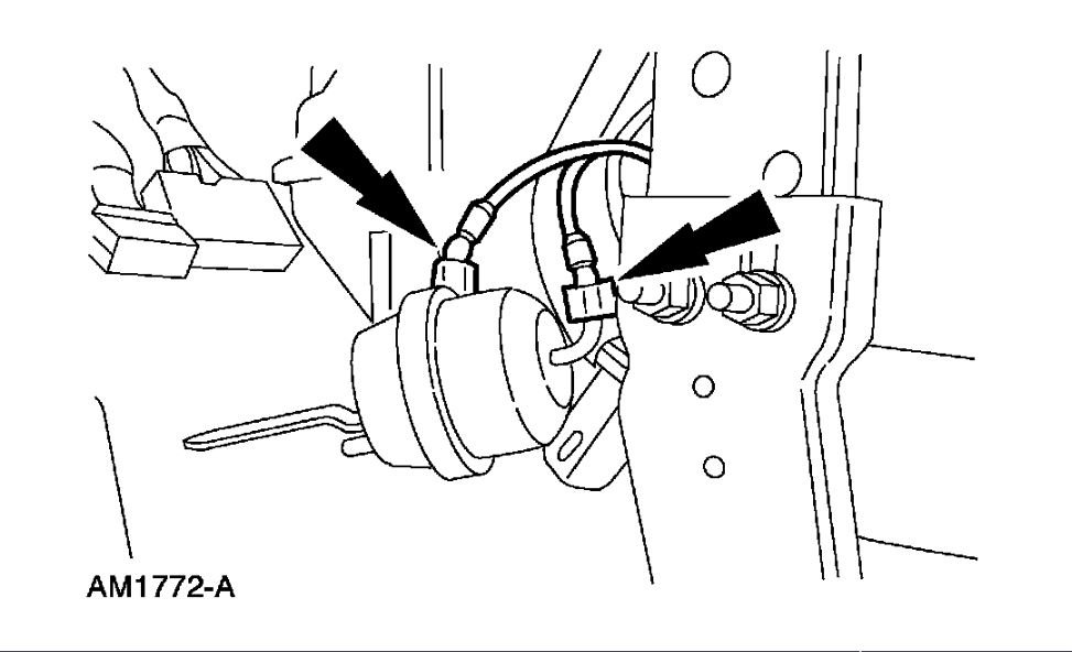

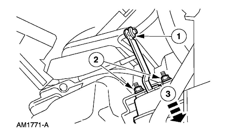

The fact it is stuck in defrost mode tells me there may be either a vacuum supply issue or the vacuum motor on the heater case is bad. You will need to check for vacuum to the system from under the hood. I attached a vacuum diagram for you to view to be sure there is vacuum.
If it is the motor in the case, the instrument cluster has to be removed. That will be a large project.
