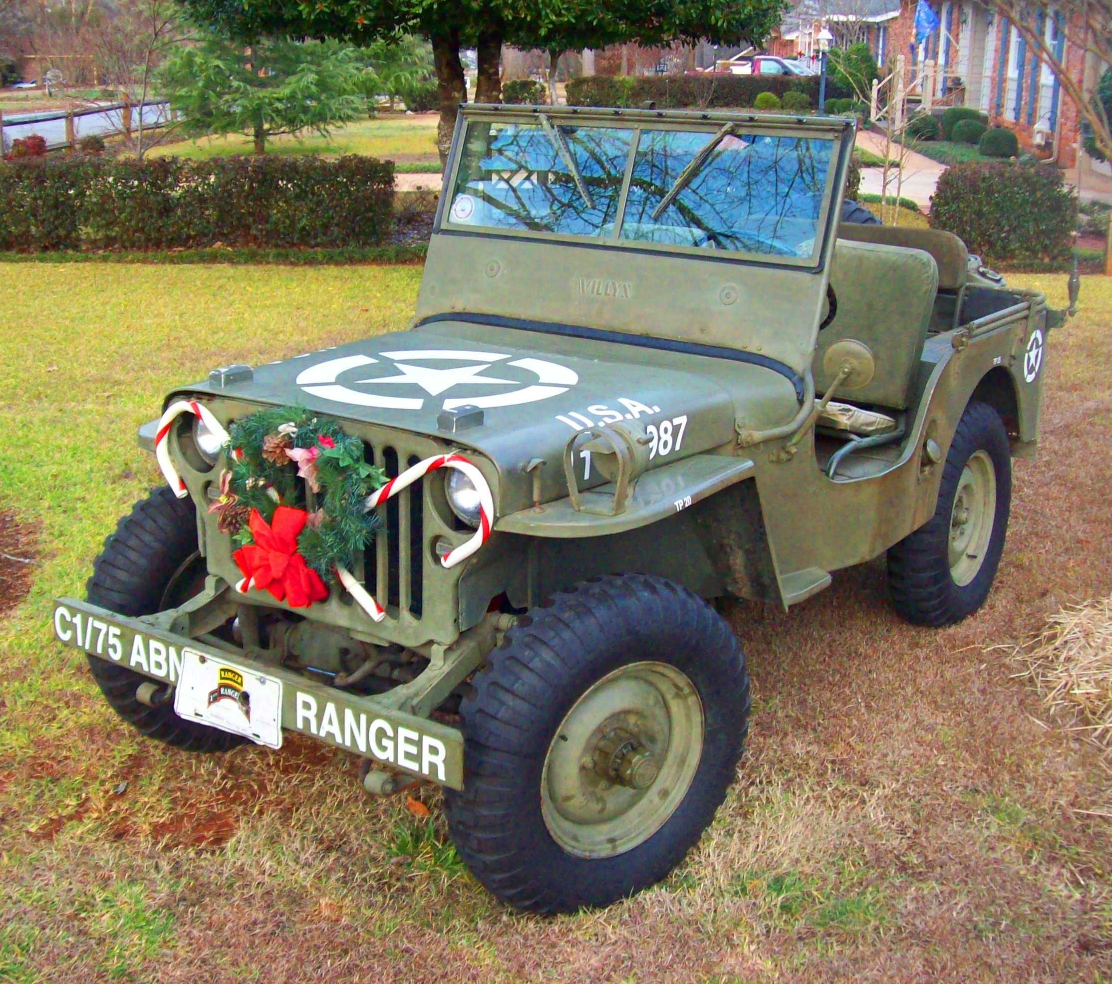

Today we did honey-dos.
Unpacking and installing her Christmas stuff.
I rolled Willy out of the garage so he could sun bathe his new coating on. Gotta cure out a little more before I can reinstall his insignia back on. He sorta has that naked look about him now.

That is a very cool looking jeep.

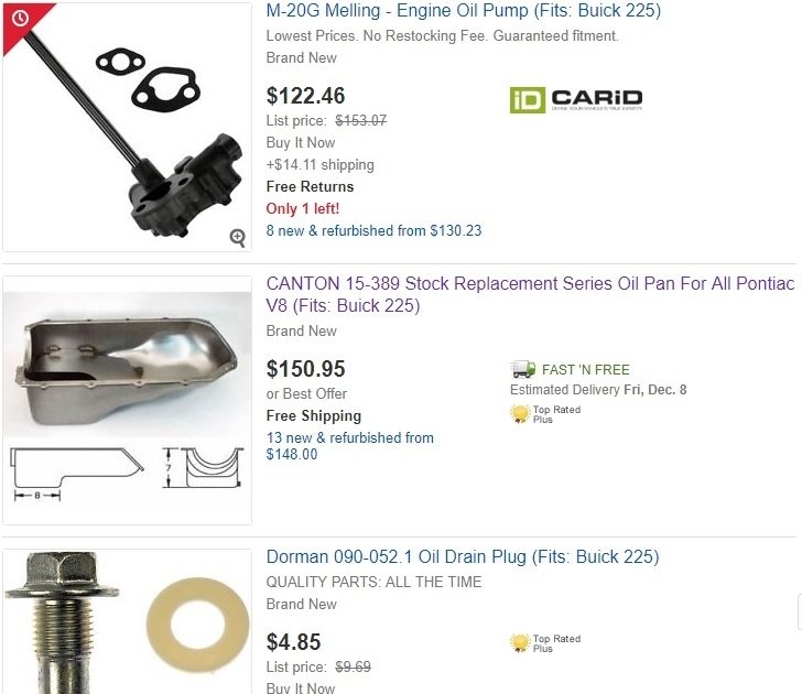

Any ideas where I might find a new oil pan for a 67 cj5 v6 - I have looked everywhere.
Monday, December 4th, 2017 AT 6:26 PM
CJ MEDEVAC
  • 11,005 POSTS
I went to several sites (including Kaiser Willys)
I went to Ebay- looked up "Buick 225 oil pan"
Bunches of high tech/ high dollar ones.
I found the one below.
I made a screenshot.
Does it look (really look!) Like your design?
Find this in Ebay, they may show specs when you click on it.

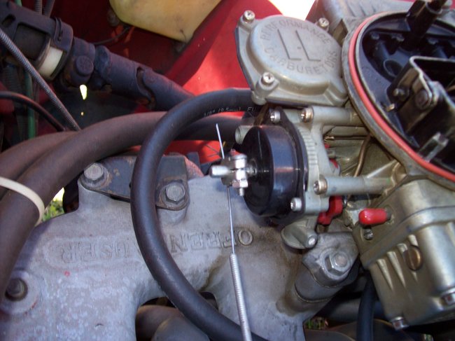

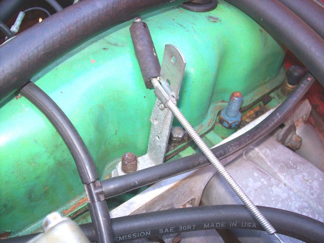

Happy New Year! I finally have the two carb mounted. It took forever to get the carb swapped out and it has been too cold in my garage to work on anything. Had a couple of nice days now and am close to having it ready. I do have one issue. When mounting the choke cable off the side of the carb -is the outer jacket of the choke cable suppose to be completely secured in the bracket so it doesn't move or should it be able to slide? I can't remember when I took the old one off if it was loose or not.

This the way I had to secure the choke cable for my Holley on "Mr. Jeep". (1st two pics below) Looking at both of my pics, that was the only suitable anchor point I had (I kinda didn't want to take an intake/ exhaust bolt out to get it closer). Yours will probably be much-much shorter.
One of these years I'll replace the flimsy bracket that came in the kit with something a bit stiffer, Might even make the new/ homemade one with an Arm that will get me closer to the choke.
I could only secure mine a little further from the choke than I really wanted to with what was on hand.
I kept the outer shroud sorta long past the anchor. Anchor your shroud, it should not move!
IF I had chopped it shorter, the Inner Cable/ Wire would be Really long, that INVITES the inner cable/ wire to fold over/ bend a lot/ or flex if there ever was a slight bind, which would inevitably not let the choke axle have full travel.
Moral of story: Keep the outer shroud as long as possible without it interfering with full Needed travel of the inner cable/ wire.

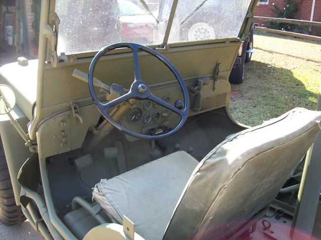

(last two pics are of "Willy's" painted interior)
