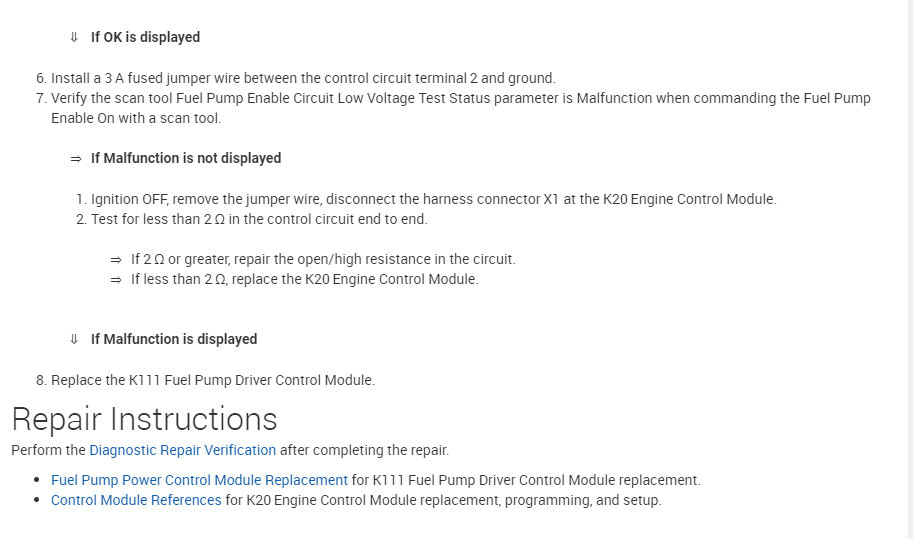

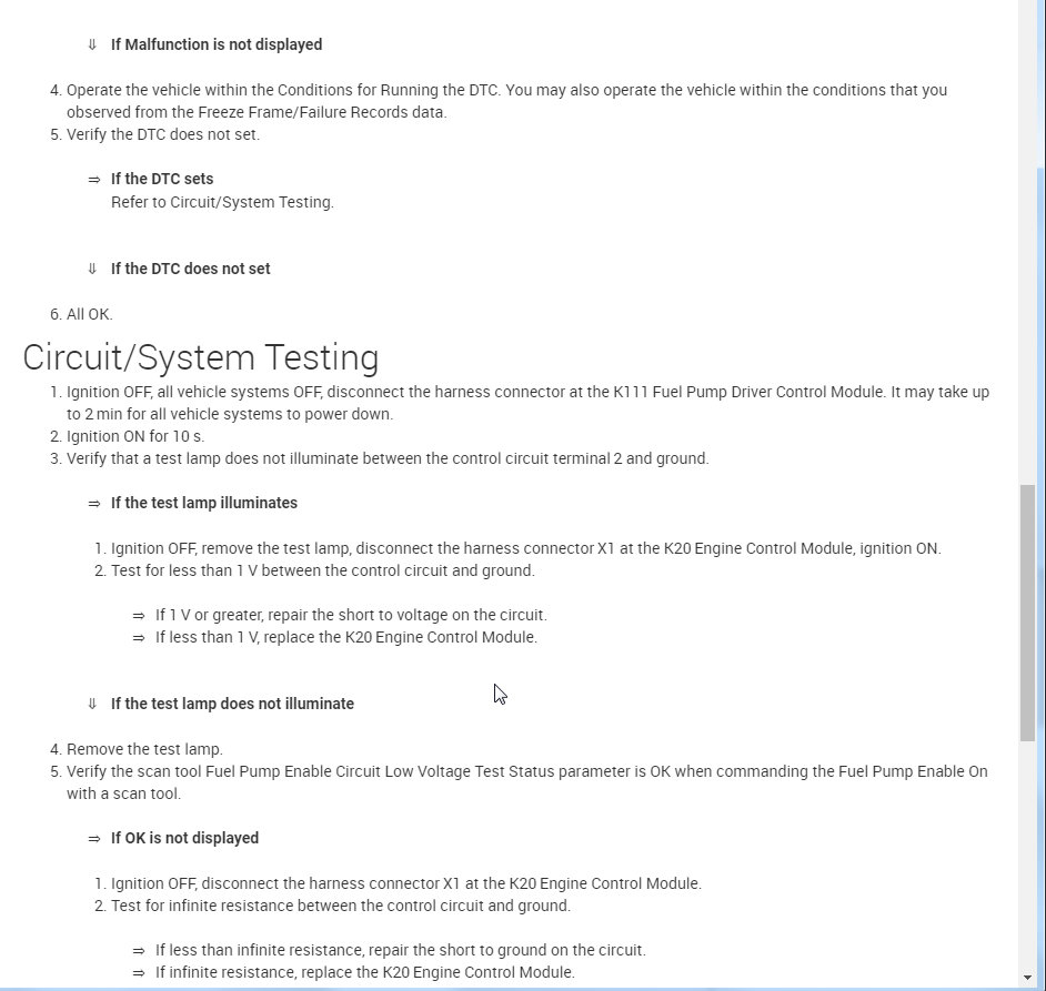

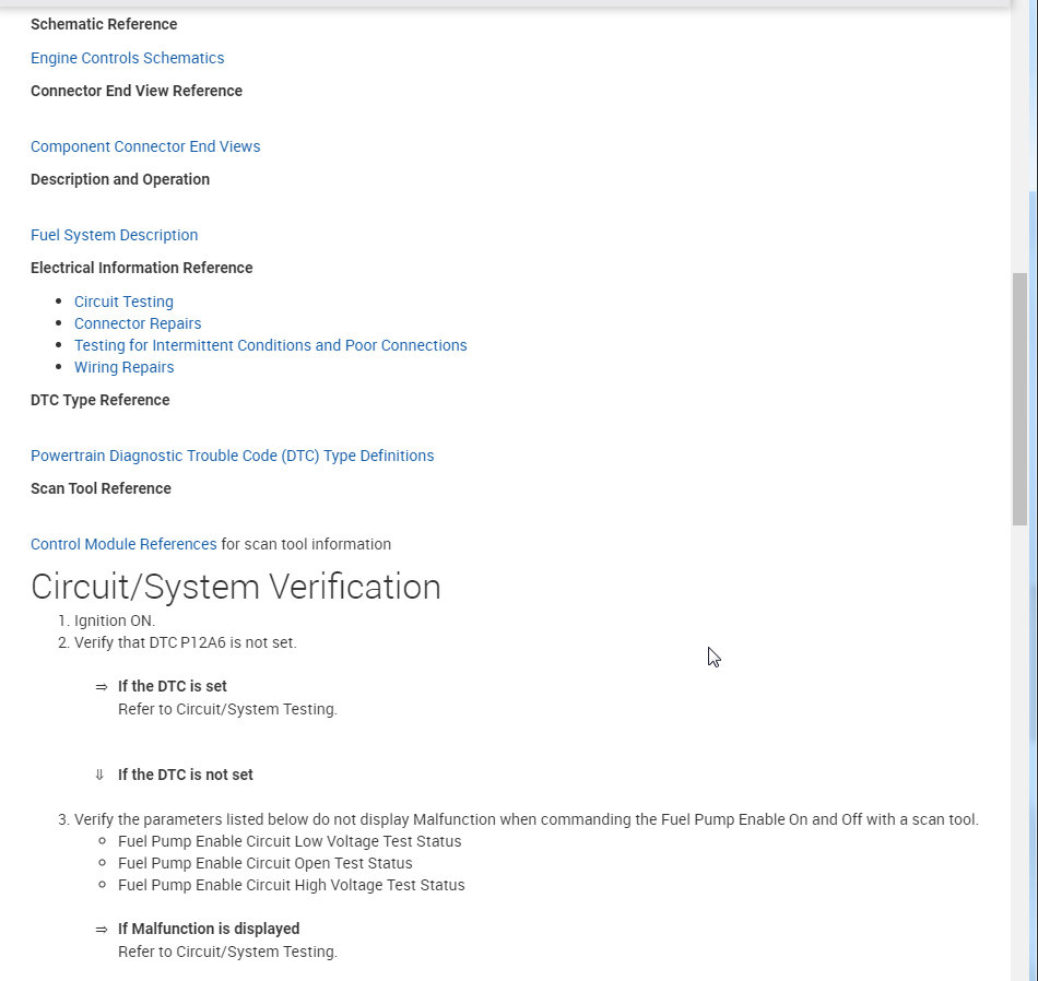

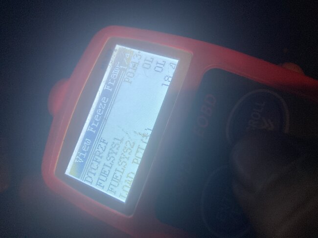

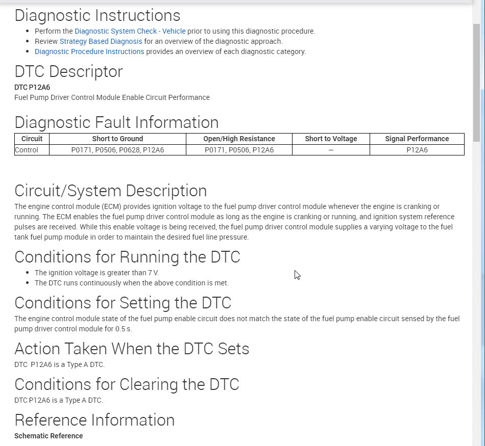

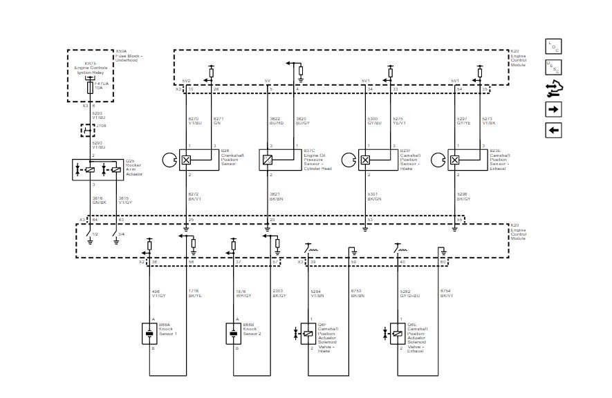

Change the engine in the truck listed above the old engine was bad got it all back together now it will idle bad when it starts or wont start at all. Only code it's throwing is p12a6 all grounds are good and everything is hooked up.
Saturday, March 7th, 2020 AT 10:39 AM

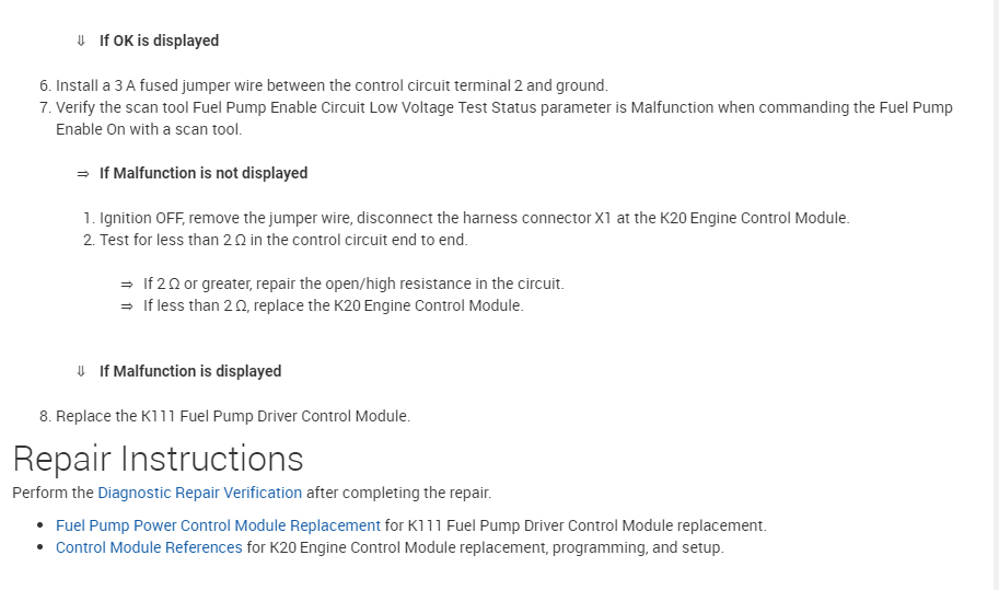

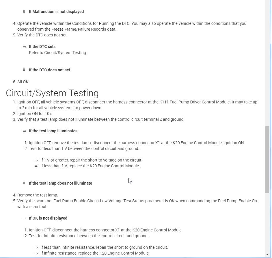

I attached the testing for this code. If you run through this I am sure you will find the issue. However, the P12A6 code will cause your issue so we need to perform each of these tests and go from there.
Clearly the vehicle is telling us with this code that the fuel pump driver is not sending a voltage signal so we need to fix that first.
Let me know what questions you have.
