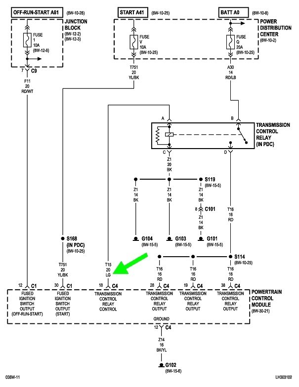

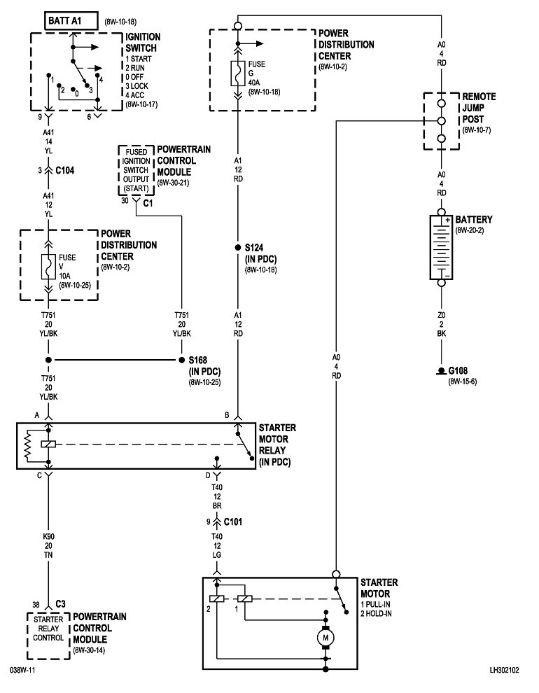

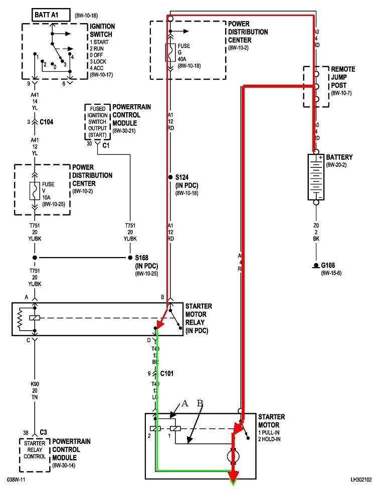

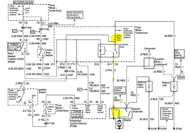

Is The light green wire that comes from the starter motor a power wire or ground? Because that's one of the wires that I had to splice together from the starter motor. I need to know if it's ground or power that way I could check it. Because it goes up to the engine starter motor relay can that stop the coils from tiring.

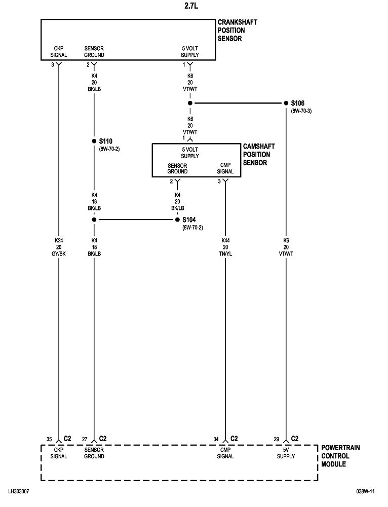

First let me tell you what I know about the cam and crank sensors. As with any electrical generator, you have to have three things to generate a voltage. That's a piece of wire, a magnetic field, and most importantly, movement between them. Many loops of wire is more efficient. Alternators, for example, use a coil of wire to create the magnetic field, and three groups of stationary coils that the voltage is "induced" into, then the movement comes from spinning the electromagnetic coil with the belt and pulley.
In position sensors, the metal core is a permanent magnet. The coil of wire is wrapped around it, but the movement is created differently. A toothed "tone ring" or a ring with holes in it passes by the tip of the sensor. The varying metal and spaces disrupts the magnetic field that the coil of wire is sitting in. That movement of magnetic lines of force are what causes varying voltages to be induced in the coil. In its basic form, that signal can be used to tell the computer when an event has occurred. That type of sensor has just two wires and the signals they develop look somewhat like the sine wave that you'd see in house wiring. The voltage will vary gradually between a maximum positive voltage, then transition over time to a maximum negative voltage. The faster the engine speed, the higher the voltages will be developed. These are really good for speed sensors because all we're interested in is the number of events. We don't care exactly when the events occur. These worked okay for position sensors years ago because they were consistent, and we had adjustable distributors to let us set ignition timing to specs.
Much more precision is needed today with engines that have no provision for adjusting ignition timing. The heart of the position sensors is still the same with the magnet and coil of wire, but electronic switching circuitry has been added. The induced voltage from the coil of wire reaches a point at which the circuitry switches from one state to the other very quickly, so instead of the irregular sine wave, we see a square wave with nice straight "rise times" and "fall times". Those switching points are very precise and work perfectly for timing spark and injector pulses. The internal circuitry needs a power source and a ground, and then the third signal wire going to the computer. Most Chrysler computers use 5.0 volts to power the sensors, but other models could use 8.0 volts or 12.0 volts. In a few rare cases GM used 10.0 volts.
The reason I didn't comment on your testing the signal voltage right at the crank sensor is there's two different ways they can act. With one type, the movement comes from the tone ring moving past the magnet. The magic word is "moving" past the magnet. It doesn't matter if a tooth or a gap is under the tip of the magnet. If it isn't moving, no voltage gets developed in the coil. Depending on the design of the internal circuitry, the signal voltage will remain at 0.0 volts or at 5.0 volts even though you're turning the crankshaft by hand. If it helps, imagine you're holding a lit candle. The flame is going straight up from it. It doesn't matter if you're standing over here or over there; the flame is still going straight up because there's no movement on your part. This is the type of sensor that people might mistakenly call defective because they don't see a change in state as they rotate the crankshaft. They can't turn it fast enough by hand.
The second style has circuitry that generates its own high-frequency alternating voltage that is sent to the coil of wire. By changing polarity and / or voltage, that is the movement that interacts with the permanent magnet. The tooth or notch on the tone ring gets in the way of that interaction and varies how much of that voltage returns back to the circuitry. With this type of sensor, there is a very definite point at which switching occurs between 0.0 and 5.0 volts. This is where, if you measure the voltage on the signal wire, you'll see it switch state as you turn the crankshaft very slowly in either direction.
With the first design, there is a minimum speed the tone ring must be moving before a signal is generated by the sensor. Cranking speed is fast enough to accomplish that, but that might not happen if the engine is cranking too slowly due to a run-down battery. or one with a dead cell.
As for the feed and ground wires, you'll notice for all the sensors, none of the ground wires actually go to ground directly. They usually share a ground wire in common with multiple sensors, then they go through the Engine Computer on their way to ground. That way the computer can monitor that circuit. As a result, you'll typically find 0.2 volts on that wire. The clue that there is a break in that ground wire is you'll have a whole bunch of fault codes related to all the sensors that use it. When you have a fault code for just one sensor, it's just that one and its signal wire that are the suspects.
The 5.0-volt feed circuit originates inside the computer and is very carefully regulated. It has to be stable because any variation will transfer to a corresponding variation in signals from sensors that develop a signal voltage related to what they're measuring. For example, at half-throttle, the throttle position sensor will develop a signal voltage of 2.5 volts. If its feed circuit went up to 5.2 volts, the signal voltage would show up as 2.6 volts. That one tenth of a volt isn't real serious for that sensor, but the same thing can happen with the MAP sensor. That one provides the main fuel metering calculation, and a few hundredths of a volt difference means a real lot to the computer and to how well the engine runs.
It is almost impossible for a sensor to develop a dead short between the 5.0-volt feed and the ground circuits, but it is entirely possible for the 5.0-volt wire to become grounded to the engine or body sheet metal. If that happens, all Chrysler computers will detect that and shut the supply down to protect it. That will result in a crank / no-start due to none of the sensors developing their signals. Once the short is located and repaired, you have to turn the ignition switch off, then back on, to reset that power supply. It won't come back up to 5.0 volts by itself until you do that.
The final authority as to whether the cam and crank sensor signals are showing up during cranking and have correct and usable waveforms is the Engine Computer. The only way we have of getting that information from it is to talk with it through a scanner. This can also be why it is possible to get enough of a signal during cranking to avoid setting a fault code, but the signal is not correct to cause the computer to fire coils and injectors. That's why I often mention that these defects may only be detected when a stalled engine is coasting to a stop, but not just from cranking the engine.

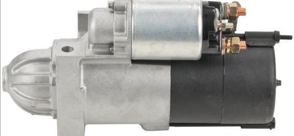

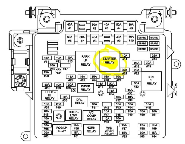

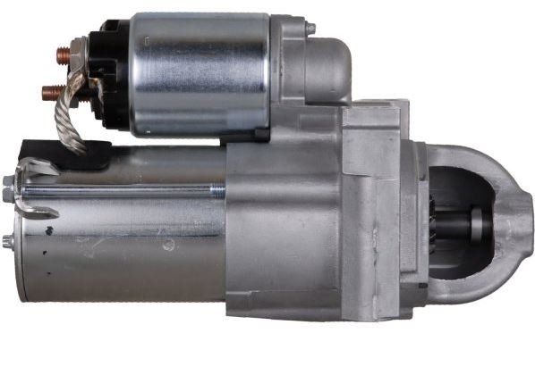

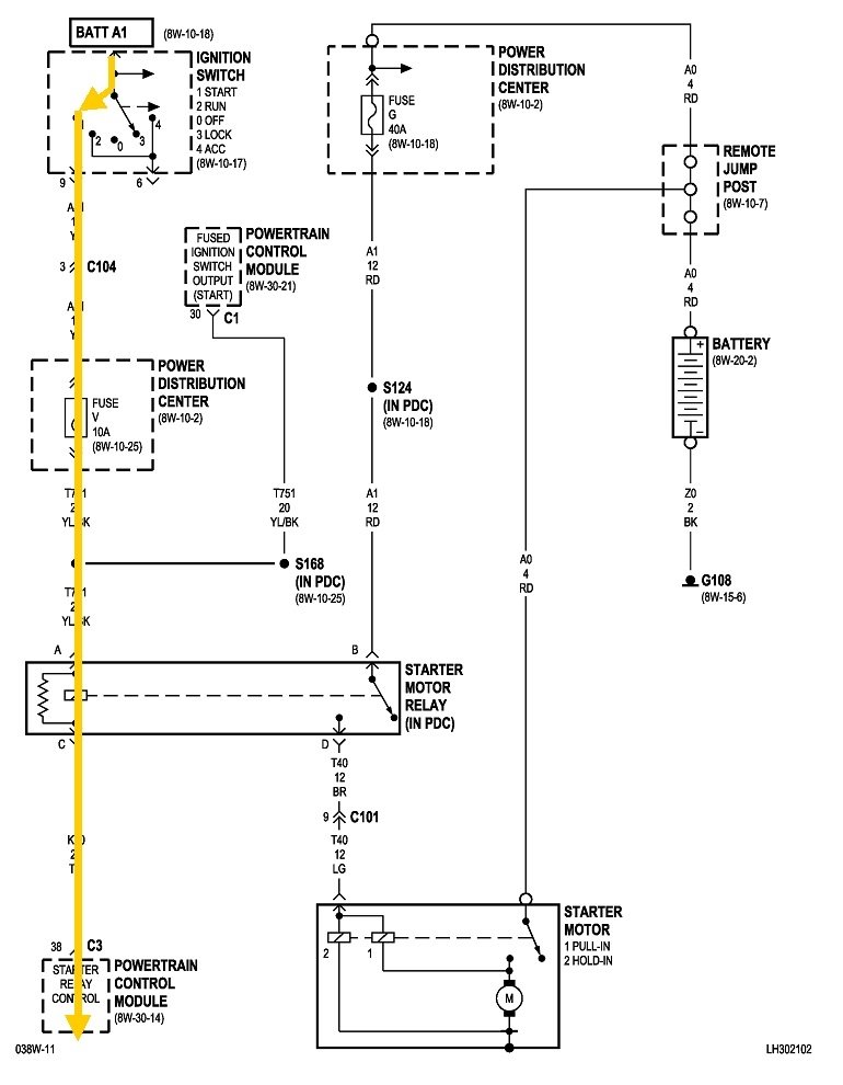

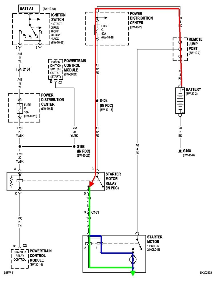

The starter system can be broken down into three circuits; the low-current, the mid-current, and the high-current circuits. The ignition switch is in the low-current part. Those tiny switching contacts only have to pass a small fraction of an amp to turn on the starter relay. That's the path shown in yellow in the second diagram.
The second half of the starter relay is the beginning of the mid-current circuit. Those contacts have to pass as much as 20 amps, but most commonly around ten to 15 amps. That current goes through the solenoid on the starter, in this case through the light green wire you asked about.
You won't be tested on this later, but this is where it gets interesting, and confusing. The third diagram shows the mid-current path. Once the starter relay has been energized, the contacts switch on, (red arrow), then that 20 amps flows through the light green wire to the smaller of the two terminals on the solenoid. Once inside the solenoid, current flows through two circuits. Each circuit has a very strong electromagnetic coil. Current flows through the green circuit, to include the "hold-in" winding, coil number "2". That one is energized all the time the relay is turned on.
The other half of the current flows through the "pull-in" winding, coil number "1", as shown with the blue line. From there it flows through the starter motor itself, then to ground. The starter motor has extremely little resistance to current flow, so for this part of the story, it's like it isn't even there. It acts exactly like a piece of wire. These two coils do two important tasks. The first is they create such a strong magnetic field that an iron plunger is pulled through them to push the starter's drive gear into mesh with the ring gear. Second, once the plunger gets there, a thick copper disc connects a pair of copper contacts to pass the very high current through the starter motor. The reason for doing it this way is it takes a lot of effort to push the drive gear into mesh. So much, in fact, that it takes the combined strength of both of the electromagnetic coils.
Once the plunger has moved all the way and the high-current contact is turned on, the fourth drawing shows that current path. The fat red line shows the path from the battery, through that internal contact, through the starter motor, then to ground. Here's the part I promised to not test you on. If you look at the pull-in winding, coil number "1", you'll see it still has full battery voltage on one side, point "A", coming from the starter relay. Now it also has full battery voltage on the other side, point "B" coming from the larger battery terminal. It has the same voltage on both sides. The net difference is 0 volts, so no current will flow through it. In effect, that coil is switched off once cranking starts. It was needed to help pull the drive gear out, but the hold-in coil can keep it there by itself. That turns off up to as much as ten amps and makes that current available to the starter motor. That few amps might be just what is needed to get an engine cranking fast enough to start on a cold day.
For this last comment, we understand there's a lot of other relays clicking on and off under the hood, so this observation isn't as valuable as it was in the past. Basically, if you hear or feel the starter relay click when you turn the ignition switch to "crank", we know the low-current circuit is working. That is the circuit that will include the neutral safety switch, or in this case, that function is done by the Engine Computer.
If you hear the fairly loud clunk of the starter solenoid's plunger engaging, we know the mid-current part of the system is working too. If the starter doesn't spin the engine at that time, the defect is in the high-current circuit. On Chrysler and Toyota engines that use the little silver Nippendenso starters, that is very commonly caused by the internal switching contacts being burned away. That is a repair that can be handled by a competent do-it-yourselfer. For all other vehicles, that is most commonly caused by a corroded or loose battery cable.
So, that light green wire is a switched power wire. Everything is grounded inside the starter, and that is bolted to the transmission, then current continues back to the battery on the negative battery cable, also bolted to the engine or transmission.

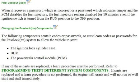

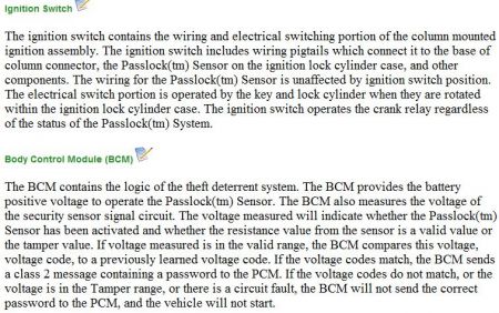

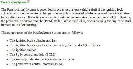

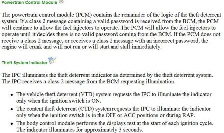

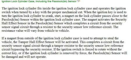

Starting and running for just a couple of seconds is what happens when it's in theft mode. I do know that on my '93 Dynasty, if I reconnect the battery that was disconnected for storage, the system defaults immediately to theft mode with exterior lights flashing, but it doesn't blow the horn. I have to use the key in either front door lock to lock, then unlock the door, then the engine will run. The fuel pump is disabled in theft mode, but it still runs for that initial one second when you turn on the ignition switch. That gets fuel pressure up to normal, then the engine will run on that gas under pressure in the rubber lines. That pressure is used up in about two seconds.

My car doesn't have anti theft mode and just for kicks i went ahead and locked and unlocked the doors on either side and it didn't change anything. I don't have a sentry key either. Is there anything else that can lead to these events? I have also checked wires and connectors for breaks and corrosion. Maybe i will go over them again to make sure.

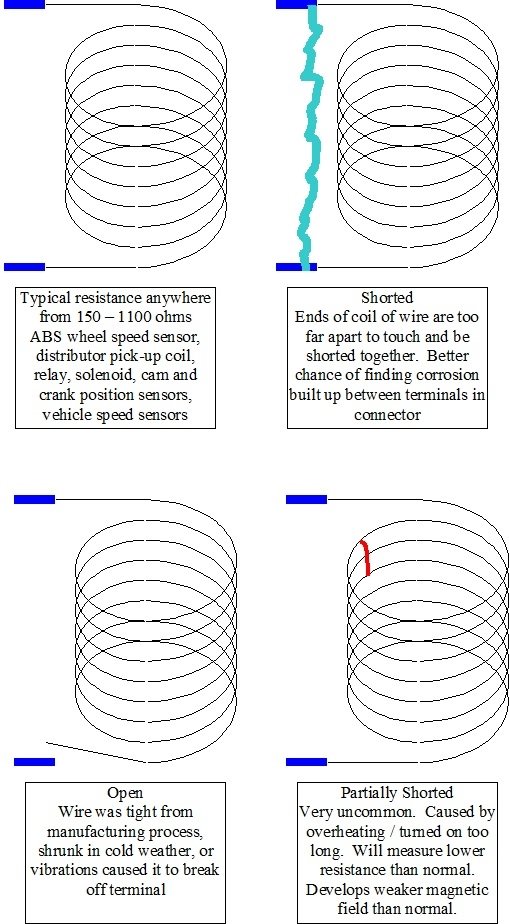

When I check the ohms with my multimeter on the IAC valve it showed 10.1 ohms I'm thinking it's a little too high but I need your thoughts as well. thank you
Apr 14, 2021 at 2:59 AM
CARADIODOC
  • 34,413 POSTS
Numbers given in the service manual are for explaining theory of operation, and are used as a guide. Some people replace fuel injectors because they're off by a few ohms, but you're just as likely to find injectors that are working perfectly fine and also don't measure within specs. For most things with coils of wire, we're interested in whether they measure shorted, open, or something in between, and that something in between is almost always okay even though it isn't exactly as listed in the service manual.
I drew you some coils of wire to help explain what can happen and what can't happen. The first one shows a typical coil in something small like the items I listed. There will usually be well over a few thousands loops of very fine wire coated in varnish for the insulation. That prevents the loops from being shorted to the adjacent loops.
The second drawing shows the coil is shorted. It's almost impossible for that to happen internally to the coil itself. You're more likely to find corrosion built up between adjacent terminals in the connector.
The third one shows the wire has broken off one of the terminals. This is the only failure that's pretty common. It is also common for the break to be so small that the wire touches the terminal and the item works intermittently. Distributor pick-up coils commonly fail in this way when they get warm, then work again after cooling down for an hour or two. To be valid, any testing has to be done while the problem is occurring.
The fourth coil shows the least common failure where some of the loops of wire are shorted together. The varnish had to be compromised, either from overheating or moisture got inside and corrosion started to eat the wire away at a scratch or nick in the varnish. While building "bugs" into a car for my students to diagnose, I left a Ford starter solenoid hot-wired for about three minutes. Those are meant to be energized just long enough to get the engine started. It got my attention when it started smoking. It still never measured lower in resistance, but it did warp the coil to the point the plunger couldn't slide freely to engage. I turned it into junk but it's resistance was still normal.
Drawings 1 and 3 are what you're going to run into on a regular basis. It's good, regardless of its actual resistance, or it's open. One quick measurement is all that's needed. The defects in the second and fourth drawings result in resistance lower than normal. The fourth one won't develop its full magnetic field so it could operate sluggishly and / or intermittently. It might only operate when the engine is running due to charging system voltage being a volt or two higher than battery voltage. This can also be why a starter solenoid engages when the vehicle is getting a jump-start, but not when trying to crank just on its own battery. The important point is resistance didn't go higher than normal in the three defects except for the open circuit.
There's three things that affect the coil's resistance. One is the type of material, but that is always going to be copper, so that variable is eliminated. Every wire has some resistance per foot, so the longer the wire is, the more resistance it will have. As a wire gets fatter, it's easier to get more current through it, so that tells us resistance had to go down. The wire's resistance is affected by its length and diameter, and neither of those things are going to change. The only way for the coil to measure higher than specs is it has to get longer or thinner. Since those things can't change, it's unrealistic to call a part "defective" because it measures higher resistance than what's stated in the service manual. The part worked when it was new, so if it's not working now, it has to be due to some other cause. That's why measuring injectors and other parts is a waste of time. I know some instructors who still teach measuring parts because it is listed in the service manual, but if you're doing warranty work at a dealership, you won't get paid for wasting time with these kinds of tests. What they are good for is doing an autopsy on a failed part to learn why it failed or why it caused the problem it did, but you would do that on your lunch break.
The same things apply to your idle speed motor, but having peeked inside a few, those coils use rather fat wire, so resistance is going to be a lot lower. I didn't think it would be as low as ten ohms, but I wouldn't question that or be concerned with that reading. There's four identical coils inside that unit. Unless they're doing something inside it that I'm not aware of, you should get very nearly the same reading between any two terminals.

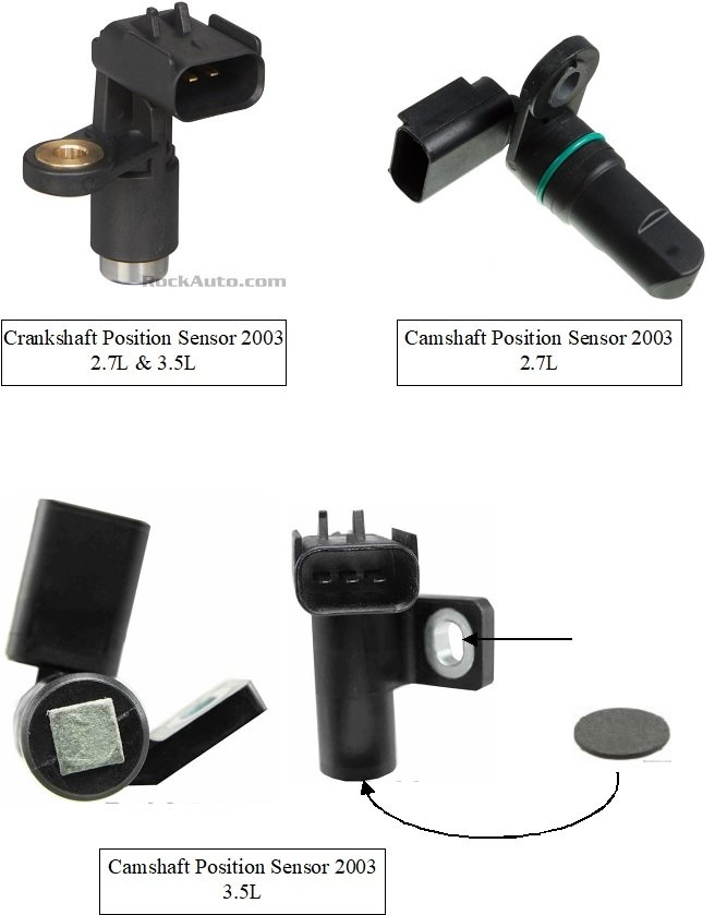

I forgot to let you know that when i changed the crank sensor.. it had scratches all over the metal piece that faces the crank. I wouldn't think its supposed to touch the crank because the gap is so crucial.
Apr 15, 2021 at 11:43 PM
CARADIODOC
  • 34,413 POSTS

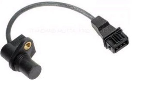

Some older ones, particularly the '90s Caravans needed a thick paper spacer stuck on the end to set the air gap, but those had a slotted mounting hole to allow for that adjustment. Newer ones use a metal bracket with two mounting holes, or the sensor has an ear with the single mounting hole. Those don't need the paper spacer and the gap is set automatically.
We were always warned that failure to use the spacer when required could allow the crank sensor to be pushed in far enough that the tip of the magnet would be hit by the ring on the flex plate, and that could break the sensor. I had one that I thought I was too smart to need that spacer. I pushed it all the way in, then pulled it out what I thought was the right amount. Two weeks later it was back with a complaint of intermittent stalling. Not knowing the recent history, someone else put in a new sensor and solved the problem. That problem may never have occurred if I had used the spacer like I was supposed to.
Apr 16, 2021 at 11:38 AM
LOREN STOVER
  • 130 POSTS
A spacer didn't come with the new crank sensor or atleast i dont think it did. Might be a dumb question lol but did this model come with the spacer maybe I am missing something?
Apr 17, 2021 at 12:05 AM

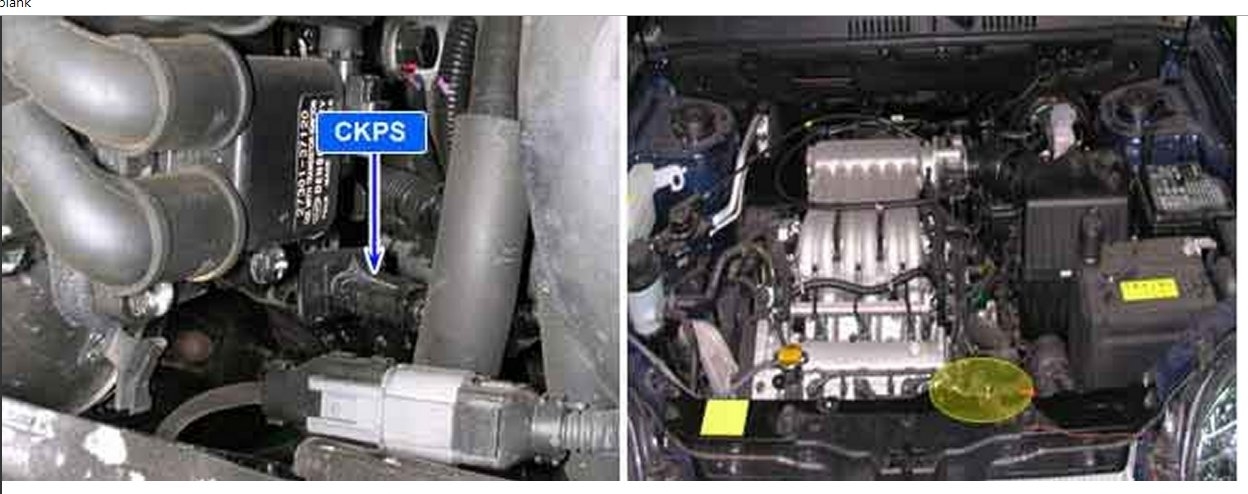

CARADIODOC
  • 34,413 POSTS
Both engines use the same crankshaft position sensor shown at the top left of this photo.
The air gap is set with this mounting ear. Your camshaft position sensor mounts the same way and can't be installed incorrectly.
I don't mean to confuse the issue, but the lower photos show the camshaft position sensor for the 3.5L engine. This one does need the spacer. It's shown attached to the bottom of the left photo, and the replacement is shown at the right side for when you want to reinstall a good sensor that was removed for some other service. In the middle, the arrow is pointing to the elongated hole for the mounting bolt.

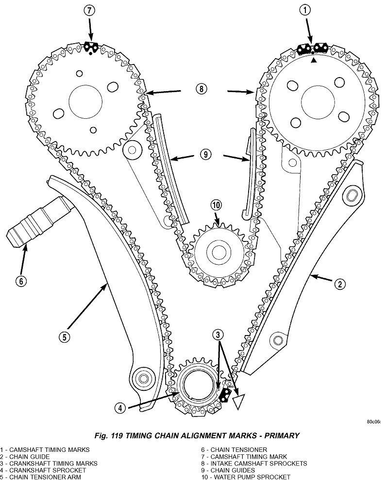

I've only seen that once, but it turns out to be a somewhat common problem, but not on your engine. The 2.0L engine used in Neons is an "interference" engine, meaning if the timing belt breaks, any open valves will be hit and bent by the pistons as they coast to a stop. If the timing belt jumps one tooth, the Computer will turn on the Check Engine light and set a fault code for "cam and crank sync". If it jumps a second tooth, the computer shuts the engine down to protect the valves. If it jumps three teeth during repeated attempts to get it running, valves will be bent.
The problem these ran into was on only the single-camshaft engine, the dowel pin between the camshaft and sprocket would shear off, then over time, the sprocket would rotate slightly on the camshaft. That made the camshaft late, same as if the timing belt had jumped, but in this case it could end up the same as if the belt had jumped one and a half teeth. Since the cam sensor is on the other end of the camshaft, it looks at the camshaft, while we look at the timing mark on the sprocket. That's what makes this hard to figure out. All the computer knows is the camshaft is late, but it doesn't know why. That puts it right between allowing the engine to run with the Check Engine light on, and not allowing it to run. The computer turned the engine off by turning off the automatic shutdown relay. The one I had was off the equivalent of one and a half teeth, and the symptom was the ASD relay was switching rapidly on and off while cranking the engine. You'd get a few sparks intermittently out of only one of the two ignition coils, but the engine never started or ran for even a fraction of a second. Once the broken dowel pin was replaced, the engine started instantly with no need to relearn anything.
Your engine uses a timing chain and two camshafts, but it also has a hydraulic chain tensioner that might allow the chain to jump a tooth or two. There's no history of a broken dowel pin, and your engine may not even use that design. That means if a camshaft is late, you would be able to see that with the timing marks.

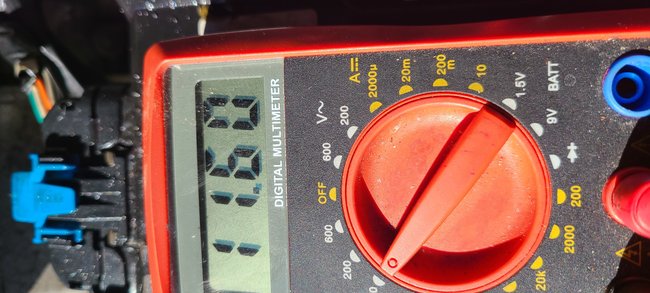

I haven't been able to check the timing yet, but when I checked for power to the crankshaft position sensor again and to the camshaft position sensor I got power to the crank sensor even with the key off, but I had to turn the key on to get power to the cam sensor. is that correct? is the crank sensor supposed to have power at all times? because I think in my manual it says to turn the key on first to check the power wire for 5 volts. nevermind false alarm I don't know what I did but now it's not showing power until I turn the key on.
Apr 23, 2021 at 4:38 AM
CARADIODOC
  • 34,413 POSTS
You're correct; there should be 0.0 volts on the 5.0-volt feed wires with the ignition switch off. There's two things I can think of that have often sent me down the wrong diagnostic path. One is there could be capacitors in the computer that need a little time to discharge. Think of them as very tiny batteries. Their water analogy equivalent would be like a tumor or balloon stuck on the side of the garden hose, like a wood tick. If you get little ripples, or changes in water pressure, that balloon will inflate and deflate slightly to absorb those pulses and make the pressure more steady. Capacitors can be used for multiple purposes, but in regulated power supplies, they charge up, in this case to 5.0 volts, and try to hold it there even if little voltage fluctuations appear. Once the system is turned off, those capacitors discharge relatively slowly. How long it takes depends on what the current can find to flow through, and how big the capacitor is. I've never checked this myself, but it could be entirely possible for it to take anywhere from a fraction of a second to maybe more than half a minute. During that time, you can still measure that voltage. In fact, if you leave the meter connected, you may be able to watch that voltage slowly go to 0.0 volts.
I have over a dozen digital voltmeters for tv, car radio, and auto repair, and all of them are of the manual type, meaning you have to select the scale, or range of what is being measured. A friend has an "auto-ranging" meter that selects the best range by itself. Each measurement can take a few seconds for it to find the right range, then display the reading. I don't have enough time left in my life to be waiting for that when I'm taking a dozen readings very quickly. The second thing you might have run into is what I got caught with multiple times when using that friend's meter. It could display "5", for example. I would glance over and see that as 5.0 volts, but when that doesn't seem right, after looking closer, I failed to see it had set itself to the "millivolt" range. It was really showing five millivolts from stray magnetic interference the meter's leads had picked up. I've seen people come to the wrong conclusion and even order the wrong replacement parts after overlooking the range on auto-ranging meters.
There's a third thing I can think of that you might have run into, but this too, I have never checked myself. Beginning with the '97 Intrepids, and maybe sooner on other models, the Engine Computer can take up to 20 minutes to go to "sleep" mode after the engine is stopped. Until that happens, it can draw up to three amps. Various emissions-related tests take place during that time that can't be performed with the engine running. It would stand to reason if the computer is staying powered up, every part of it would continue working, including that 5.0-volt power supply. You may have found 5.0 volts on the crankshaft position sensor while the computer was still awake, then found 0.0 volts on the camshaft position sensor right after it went to sleep mode. If you wanted to recheck that, all you have to do to wake the computer up is to disconnect the battery for a fraction of a second, or cycle the ignition switch to "run", and then back to "off".
