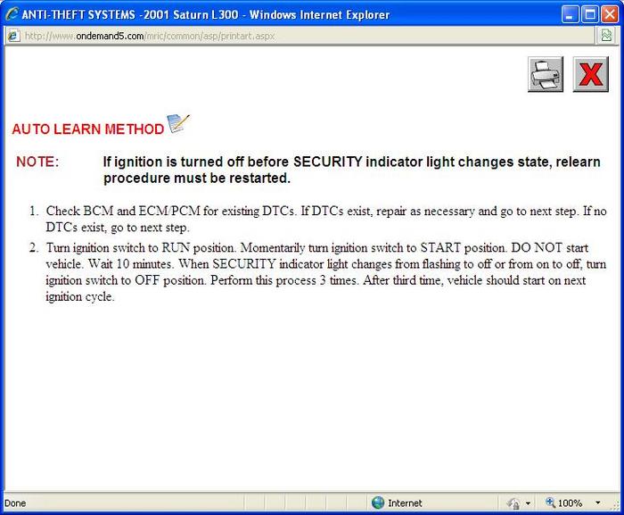

Completed 3–10-minute security system process, soft reset by pulling fuses 27, 54 inside vehicle and 13 in engine bay and disconnected negative battery cable for 10 minutes and still no change. Security light flashes when key is inserted and in "in" position. What else can be done with the security system to allow vehicle to start? Thanks.

I didn't realize the immobilizer was flashing or staying on. To reset the immobilizer/smart key requires a scan tool that has the correct programming specific to this vehicle.
Is that something you have or have access to?

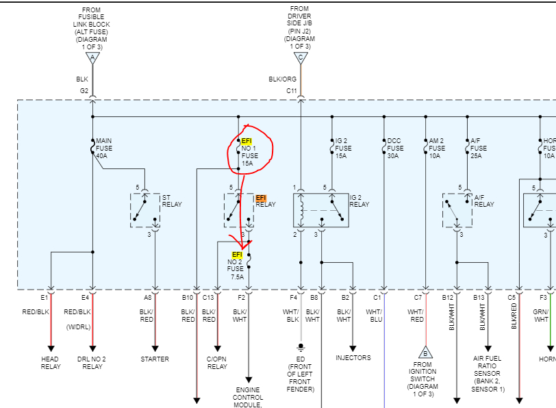

Dec 21, 2022 at 12:04 PM

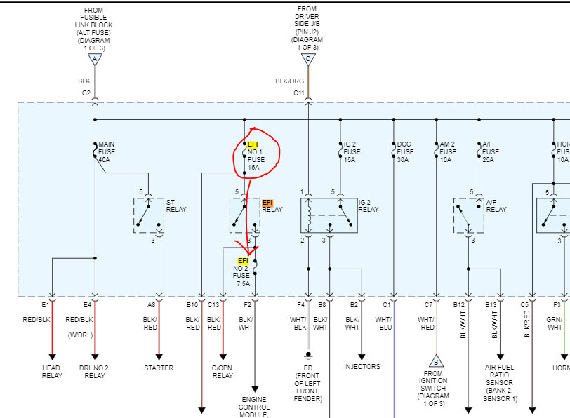

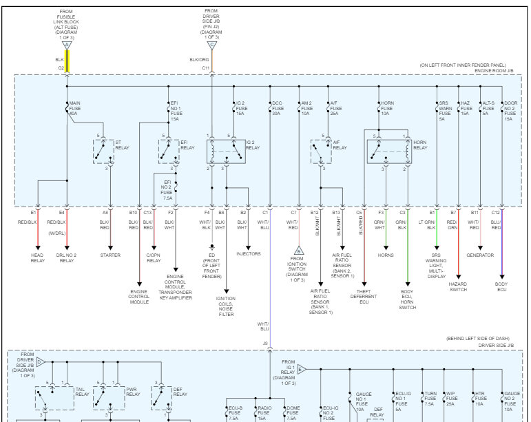

What does having to jump EFI relay to get 12v at ef2 fuse indicate? Is there anything to that I need to look at first?
Dec 21, 2022 at 7:02 PM

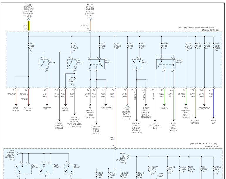

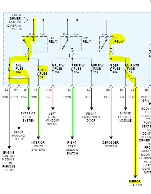

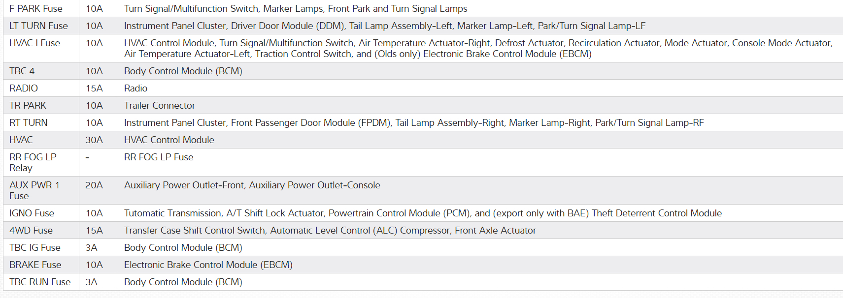

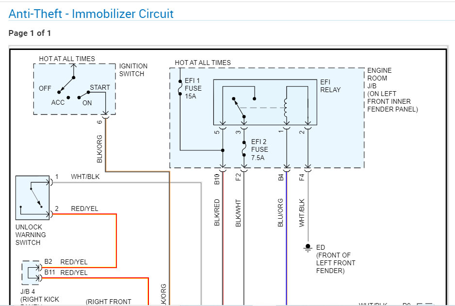

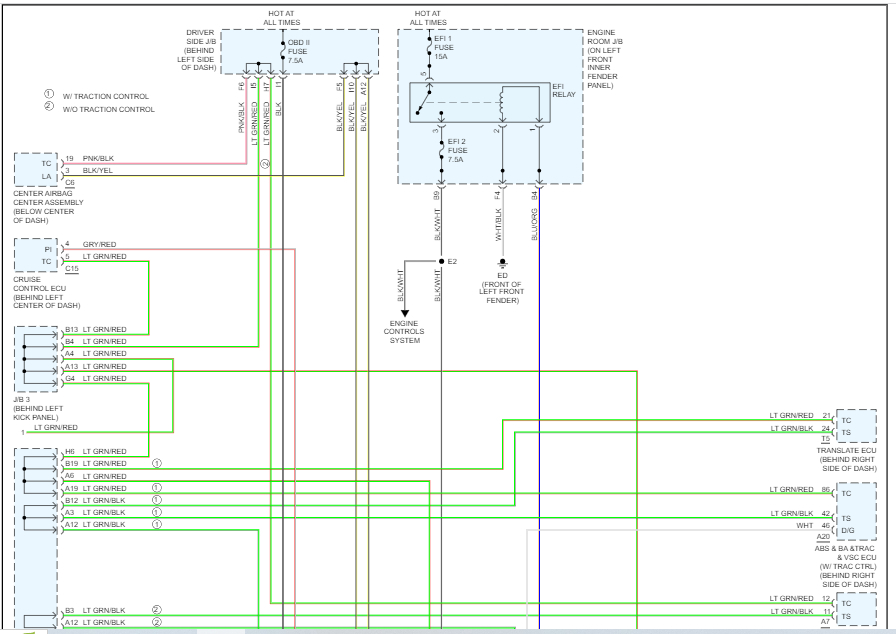

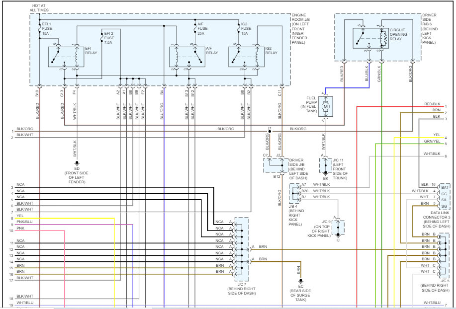

To check continuity of EFI #2 fuse wiring, where does it get 12v from? Maybe that's the place to concentrate on?

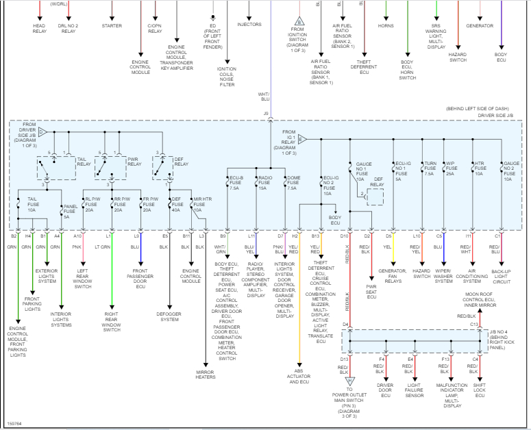

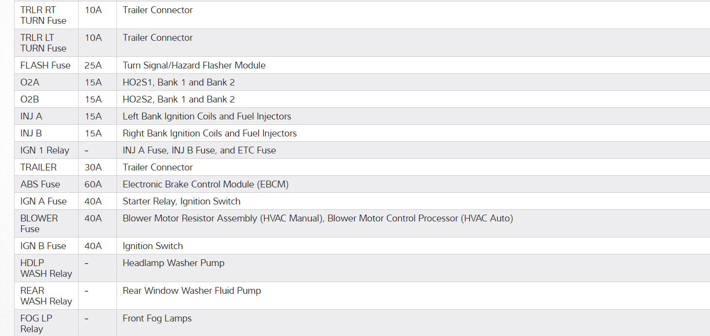

Dec 21, 2022 at 7:11 PM

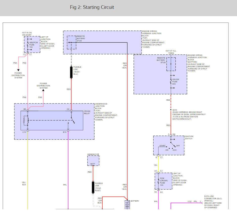

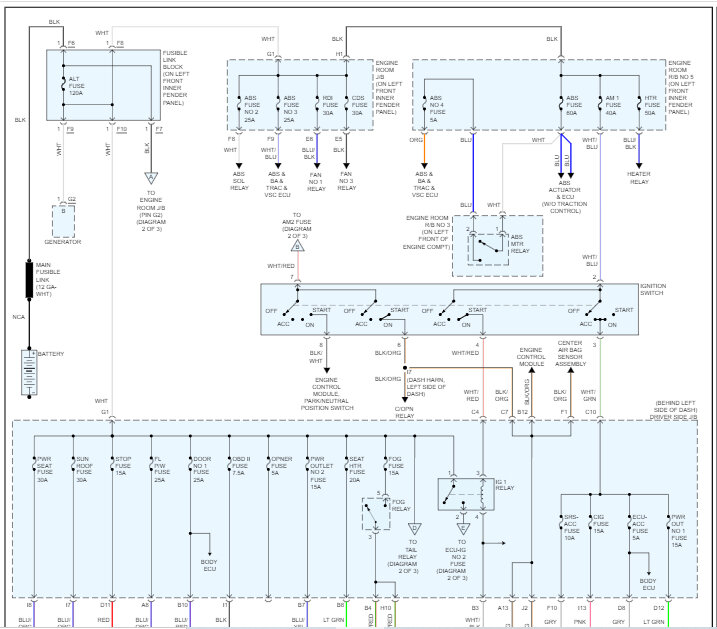

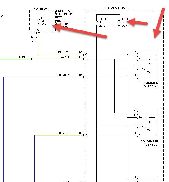

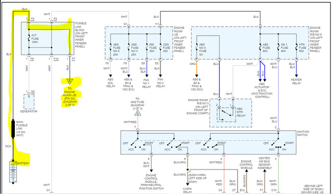

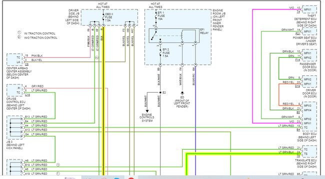

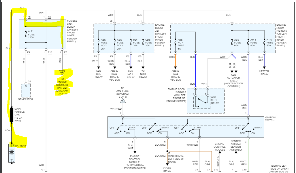

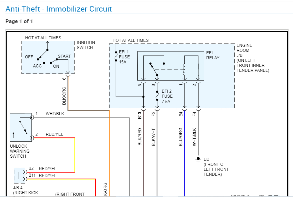

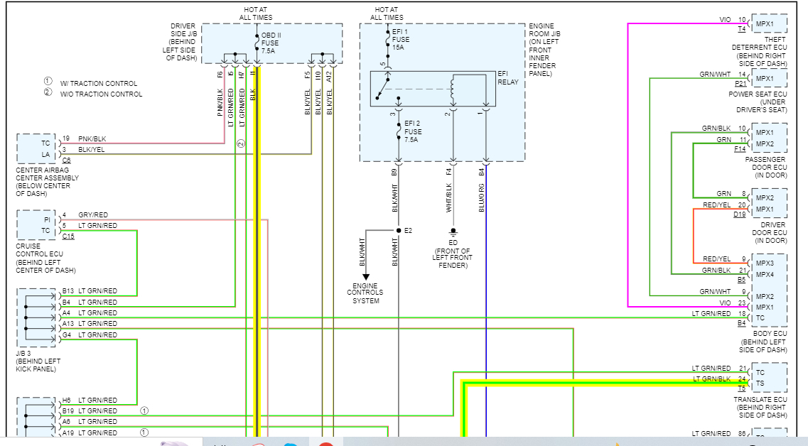

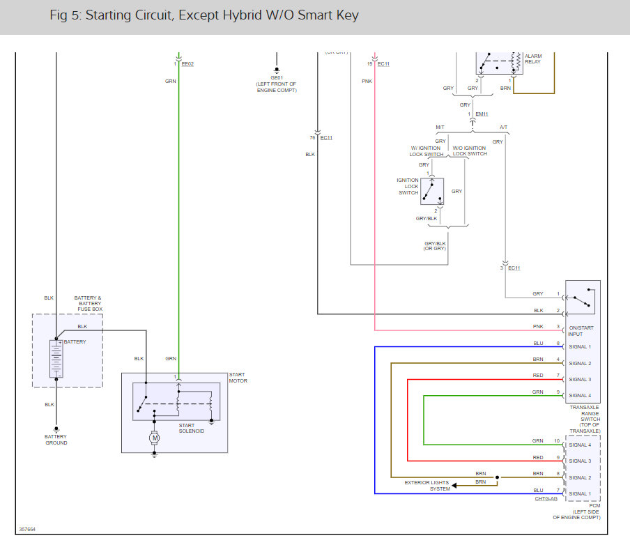

If you have to jump the relay to get power to the fuse, either we are not getting power to the primary side of the relay or the PCM isn't providing a ground path to the primary side.

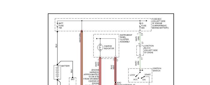

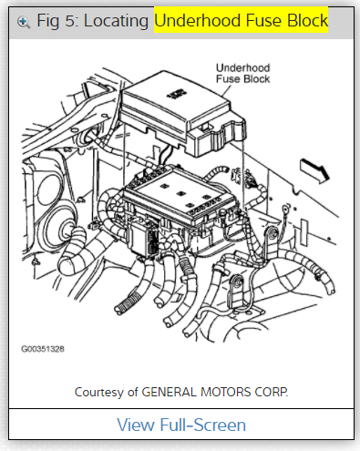

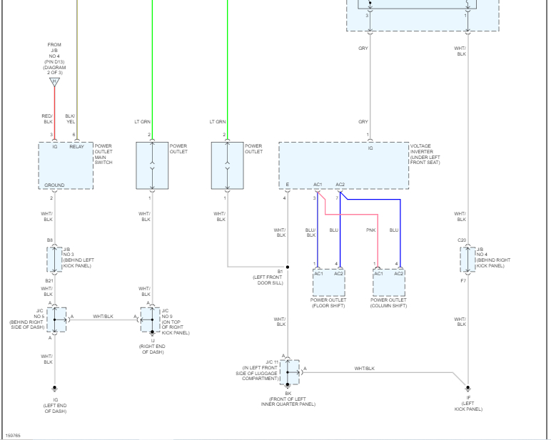

Take a look at this link:
The power to the relay secondary side is from the fusible link box. See pic 1
See pic below.
See pic below.

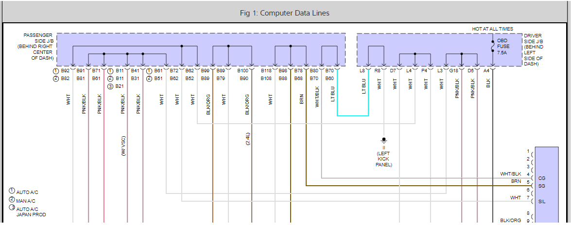

Dec 31, 2022 at 10:00 AM

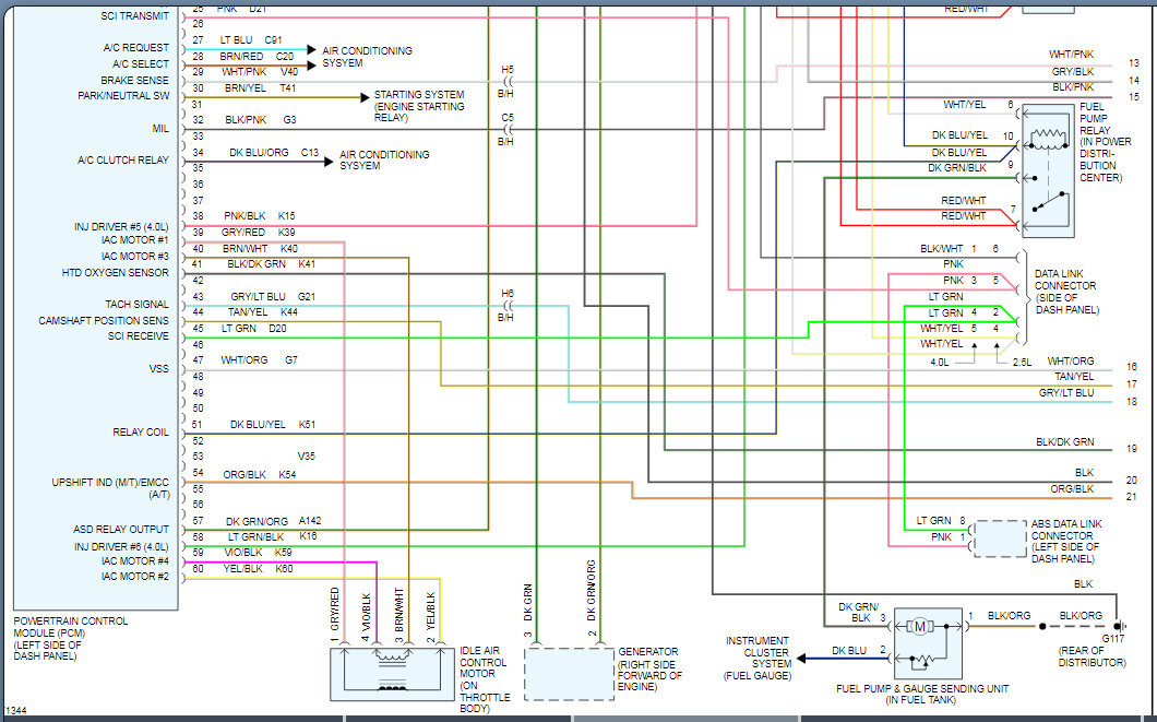

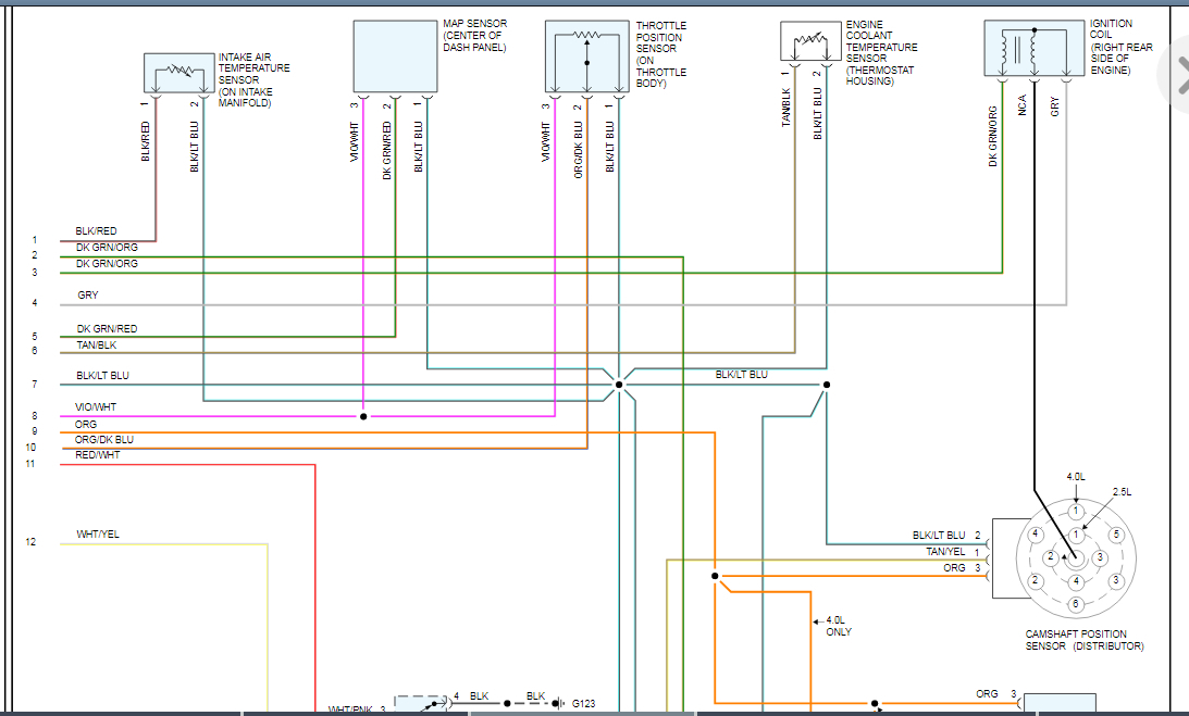

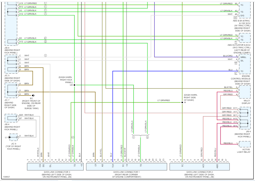

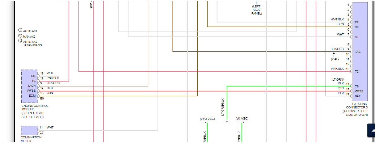

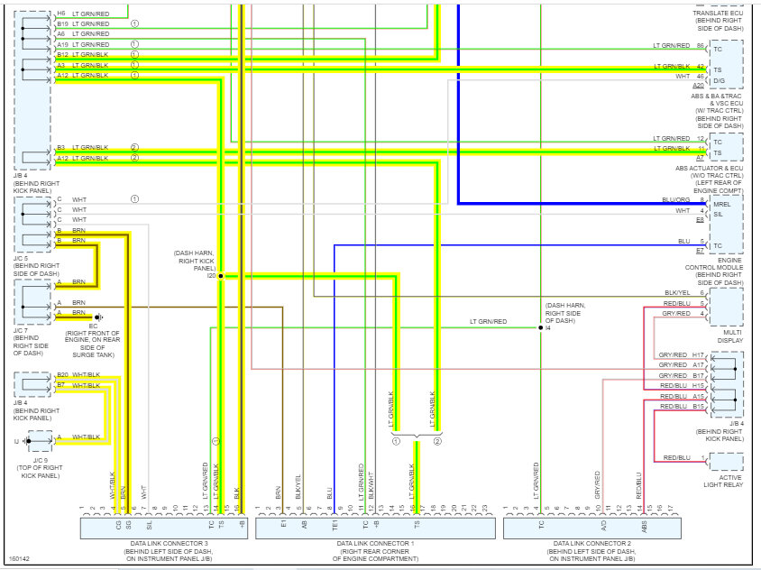

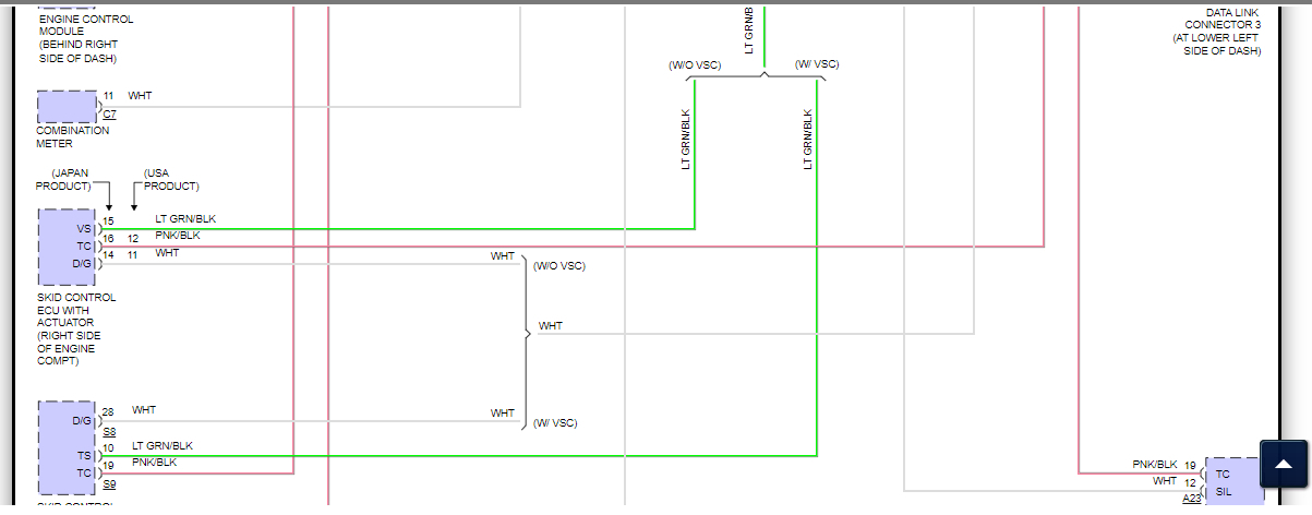

You shouldn't have power at pins 4 and 6. Pin 4 is a chassis ground and pin 6 on the schematic is blank Pin 14 is related to the traction control network and 16 is battery voltage. See the schematic below.
To locate the issues, you need a scanner that can communicate with the ECU. From there, you need to check for codes specific to the controller area network. That should point you in the right direction regarding the problem.
Note that the schematic below is the computer data lines.

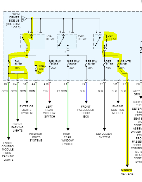

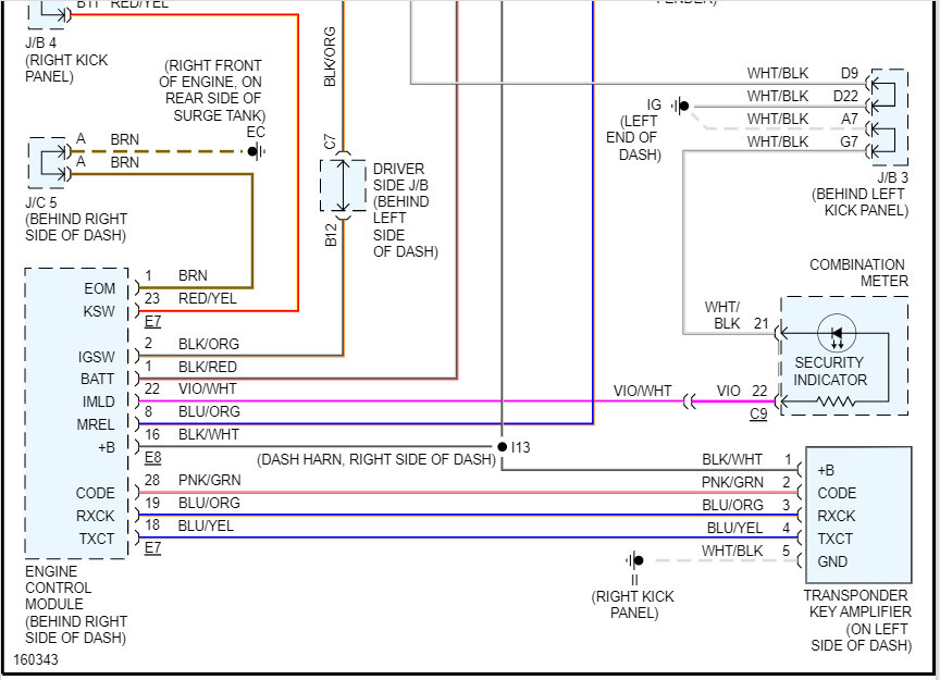

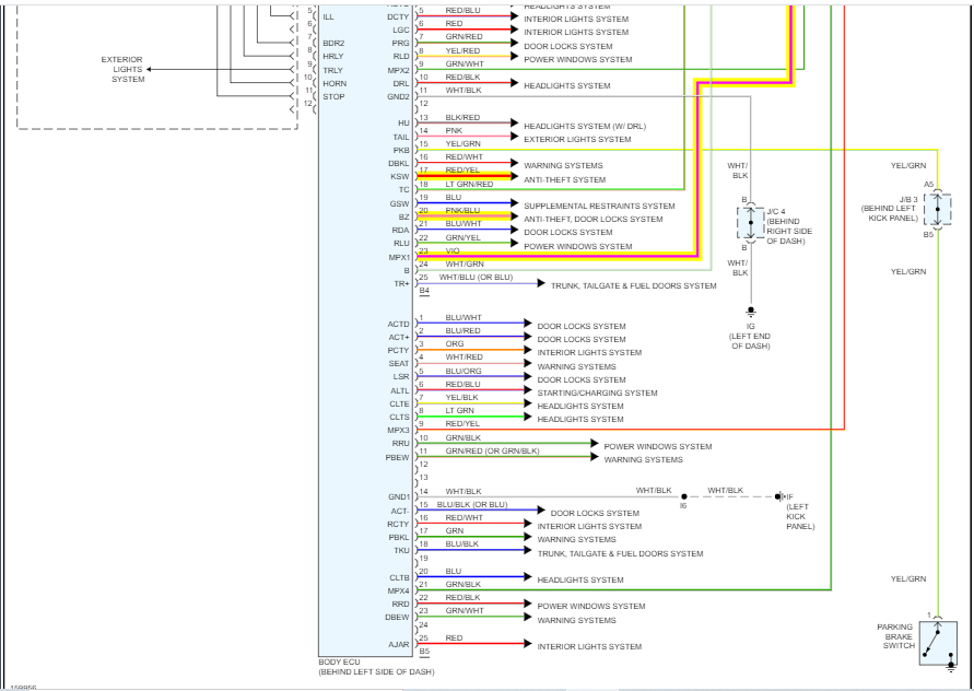

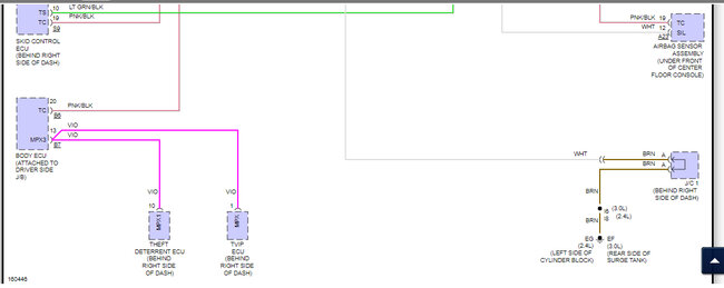

Do you have wiring diagrams with pin#s on connectors between BCM and Theft deterrent module? Everything else in this vehicle is working except for theft deterrent system. Don't have scan tool yet. Thanks.

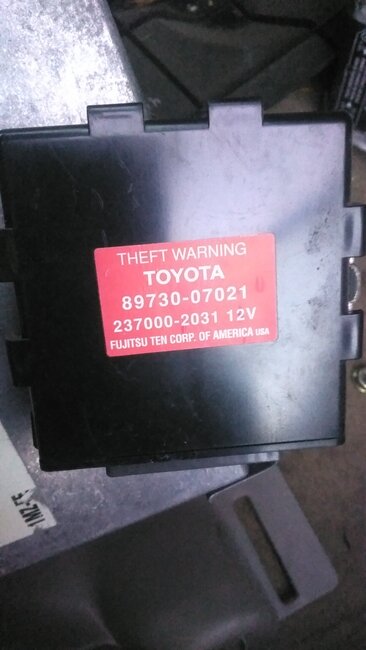

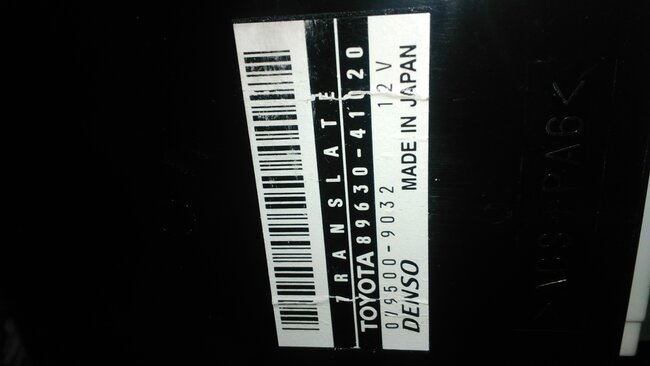

Of the junkyard parts I tried on this car (ECU, BCM, transponder coil ring, ignition cylinder lock w/key, and Theft deterrent module), I swapped everything back to the original exception for the BCM. Is the BCM not being original with all the other parts going to know also stop it from recognizing the transponder key?

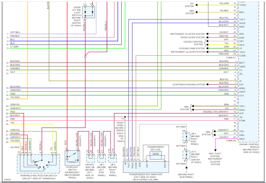

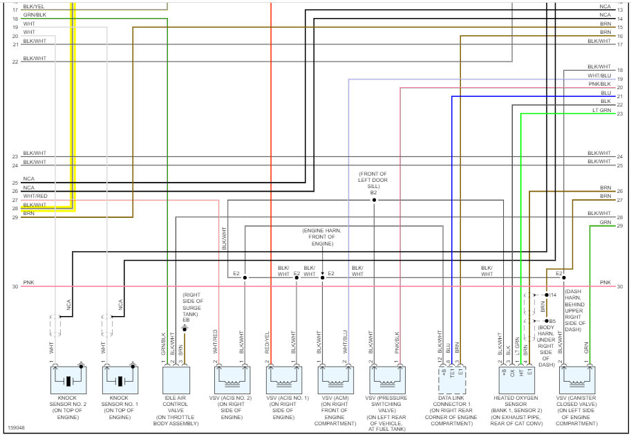

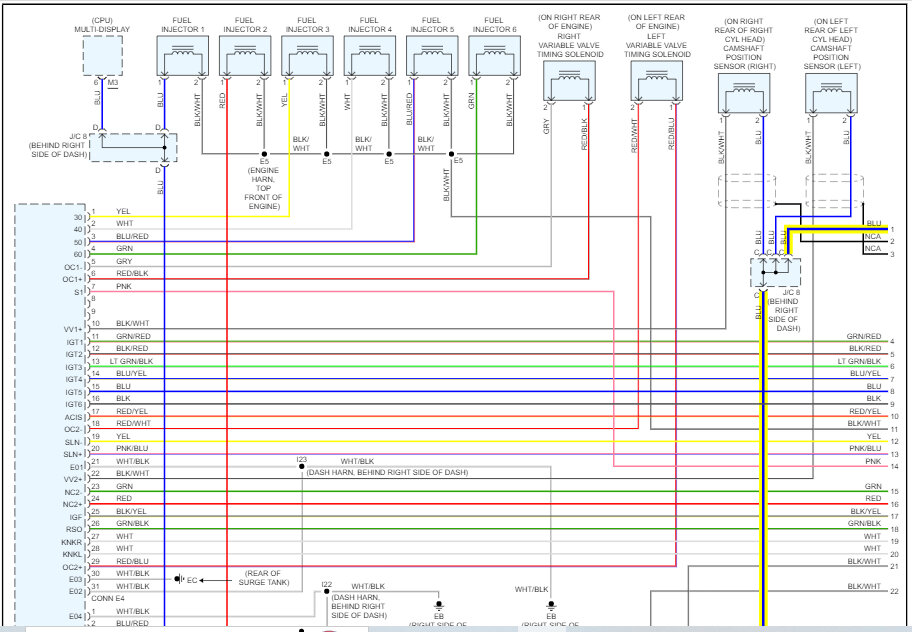

In your opinion, can a battery going dead in an 02 Toyota Avalon XLS cause ECU to need to be reprogrammed to the transponder key? Thanks.

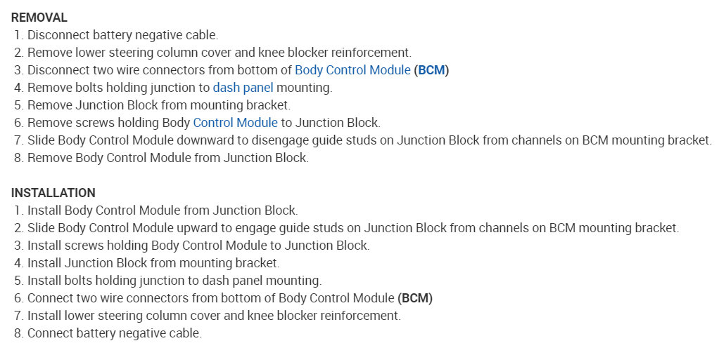

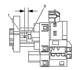

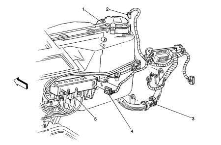

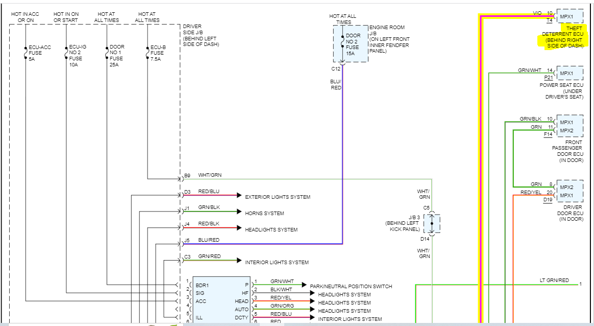

Jan 6, 2023 at 6:12 AM

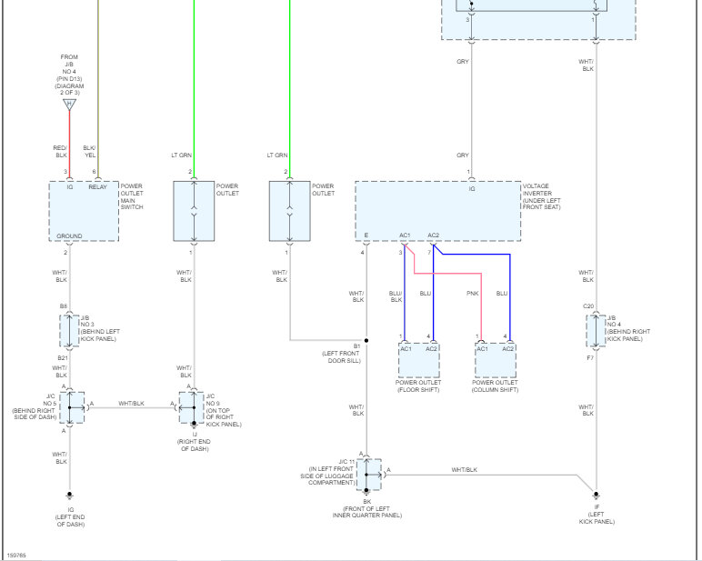

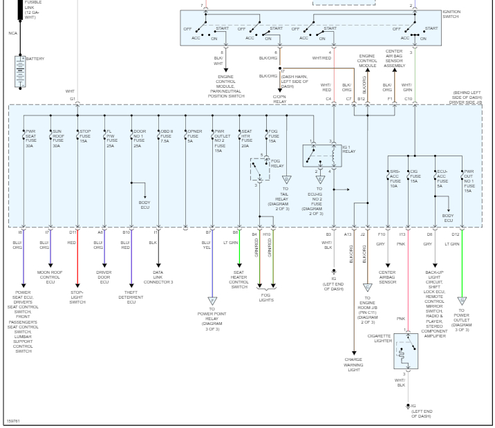

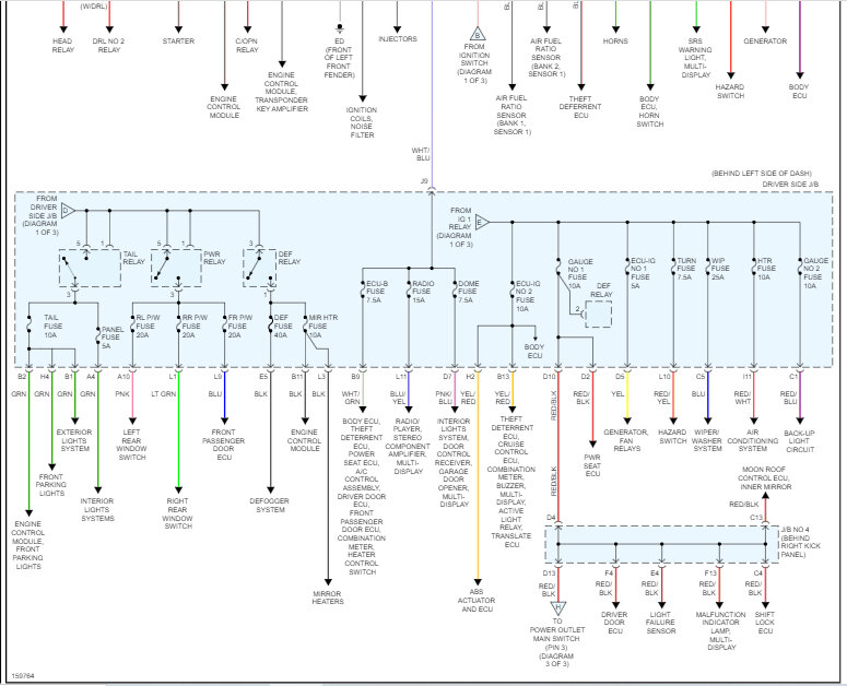

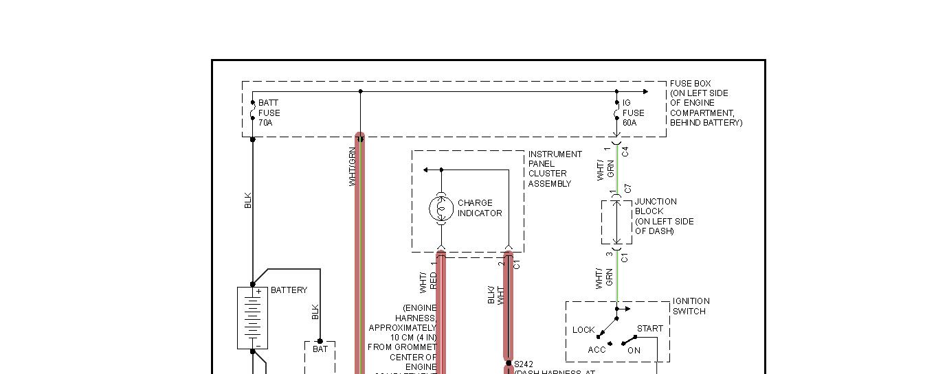

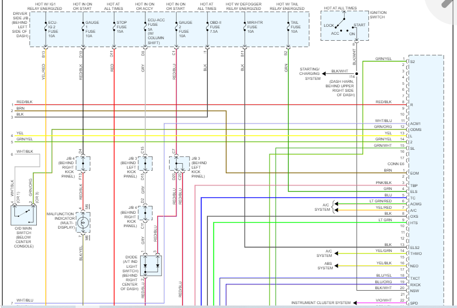

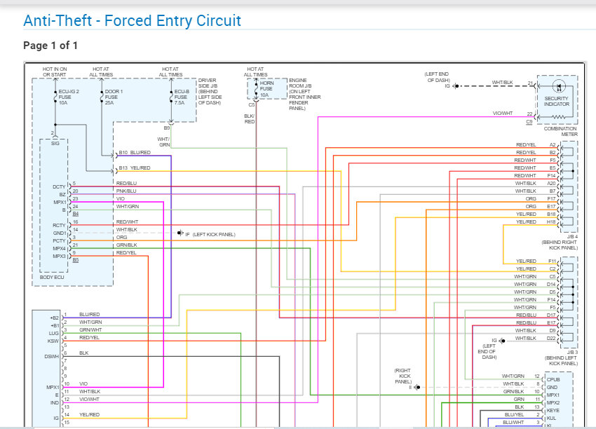

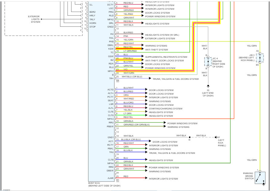

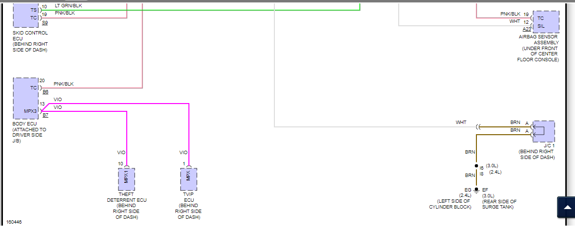

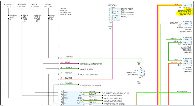

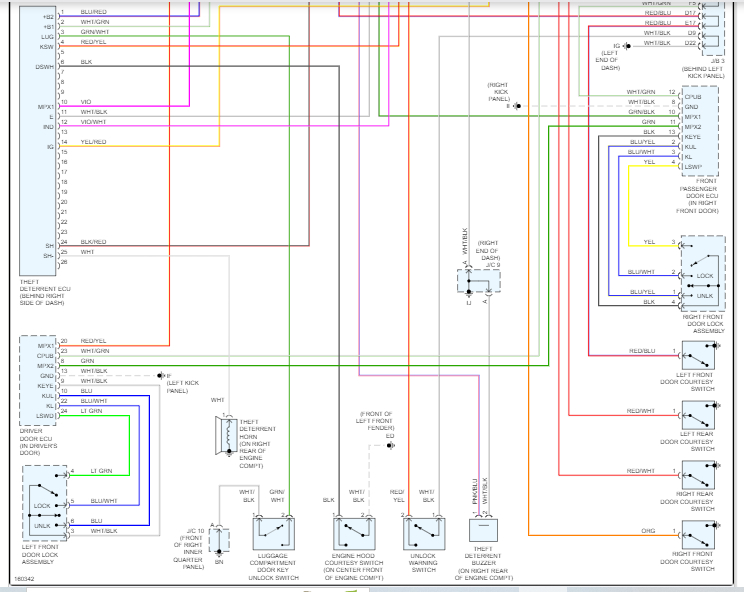

If you are using a different BCM, it needs to be programmed to recognize the key. I attached a schematic below from Prodemand for the DLC and computer data line configuration.
Let me know if this helps.
See pics below. Also, I had to cut the pic into four parts to make it readable.

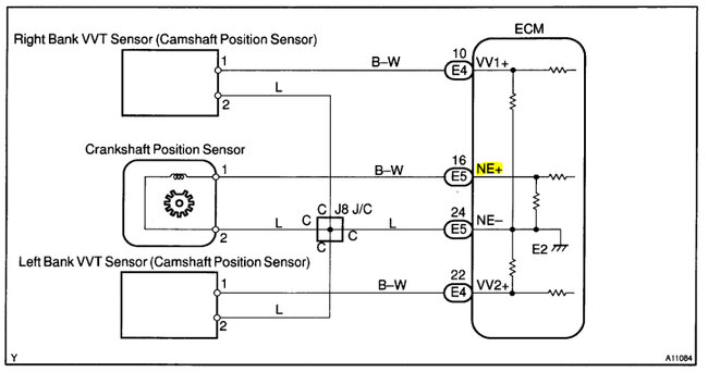

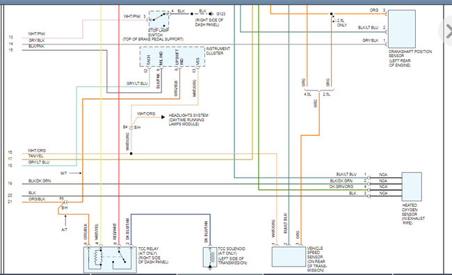

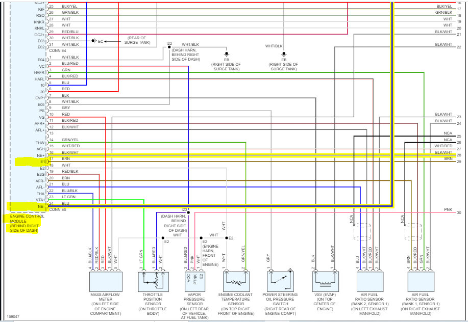

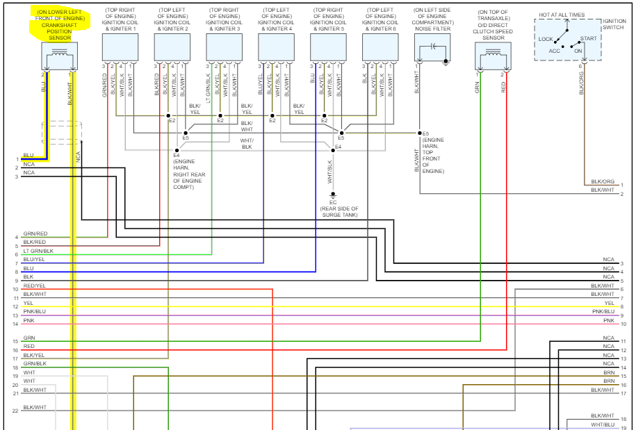

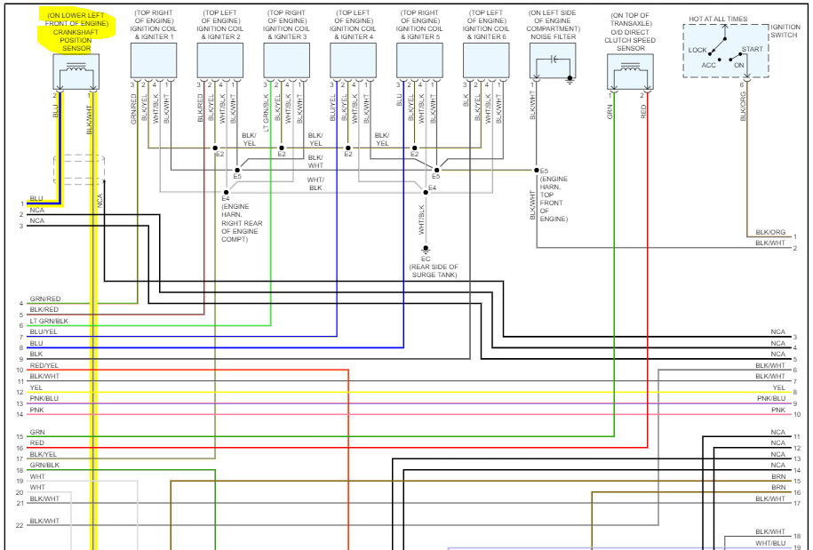

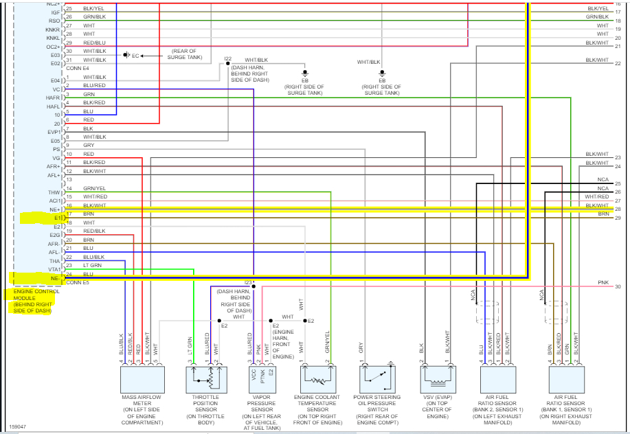

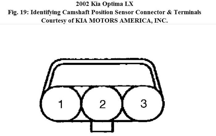

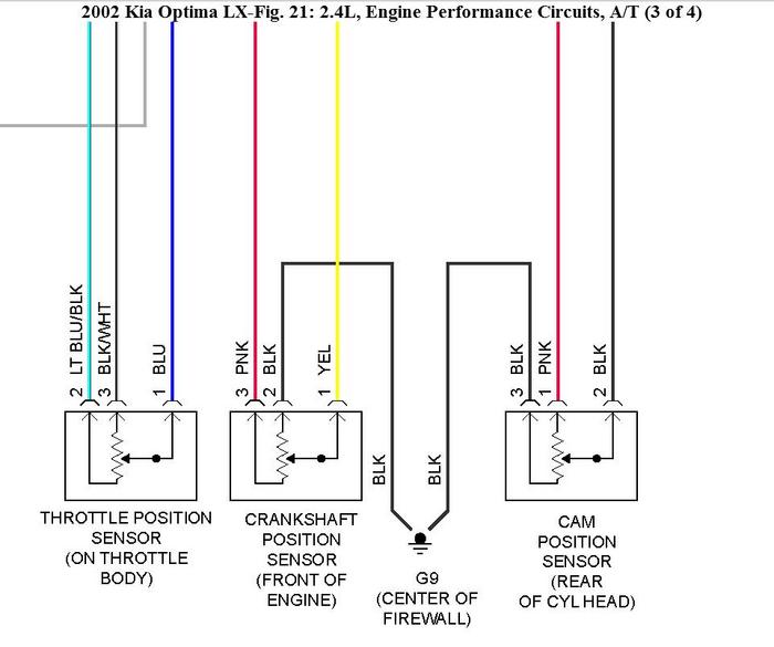

Also, tachometer has no movement with either ECU or BCM installed, that's why I'm asking about the ckp sensor wiring? Thanks.

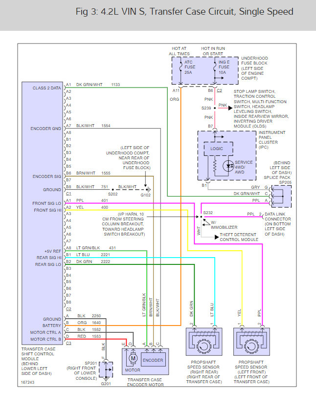

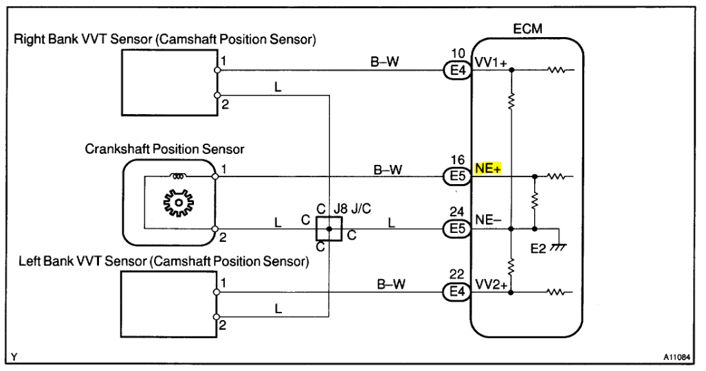

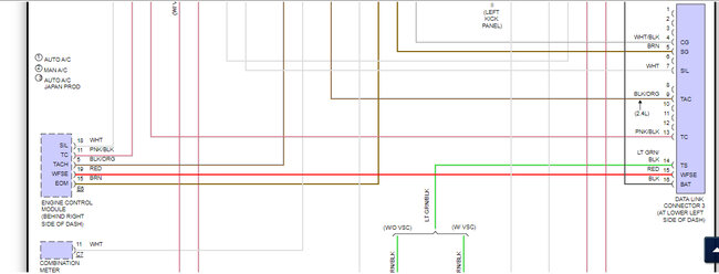

Jan 10, 2023 at 5:40 AM

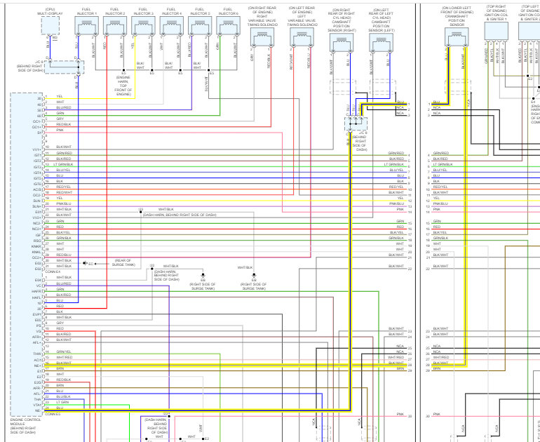

If you look below, I attached the entire powertrain management schematic. I highlighted the wiring between the CKP and ECM. I had to cut each pic in half to make them readable, but if you look at the last pic, I combined two pages so you can easily see the wiring path. I just hope it is readable for you.
joe
joe
