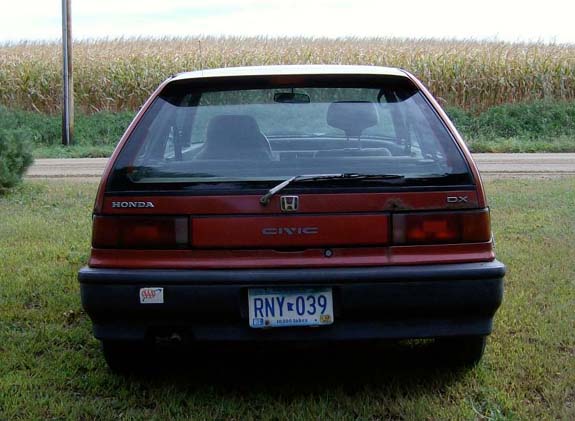

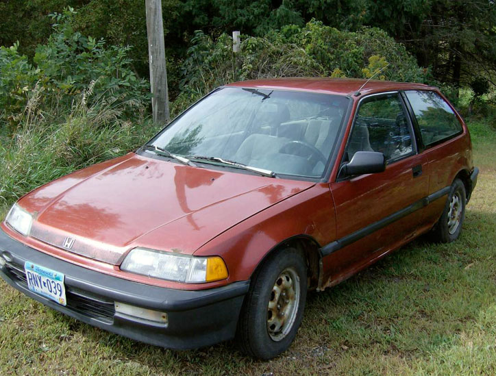

Monday night was the last night my car ran, it was rainy but it ran nice, good pick up and quiet it was normal all around except it needs new rotters on the front brakes and there may be a need to replace some gaskets. The scraping noise attributed to the clutch/flywheel sticking together was gone then and didn't return.
I hadn't ran it again until just now, this afternoon. So it's been 3 days. I wanted to take it out to make sure it stays in shape.
Well the car started to do this revving up, brrrrm, brrrm, bbrrum, brrmm, like I was pressing the gas pedal, only I wasn't. And the check engine light came on. So I backed it out and pulled to the side of the garage, shut it off and then restarted it. The problem stopped and no check engine light. but the grinding sound of flywheel/clutch was there when I put it in neutral and took my food off the clutch.
Why is is still behaving as if I left it for too long. It used to always start and go even if I didn't start it for a week. I have a Haynes book for my Honda and it has a section on check engine light codes and how to read them. But would the code be gone because I shut the engine off and restarted it? I think there's instructions in the Haynes book for turning the key in the ignition to a certain point an then looking at the light (under the carpet on the drivers side I think and counting the blinks. But again, does that count leave if I had to turn the car off and restart?
So two things are showing up. The revving of the engine w/ a check engine light after a short time of it and the flywheel/clutch. Could something be sticking somewhere and needs spraying? Would an oil change be in order? It's not over due for one but it has been sitting a while before we got it up. . .

Ok update. I drove it to the store, about a mile and the grinding noise in neutral stopped by the time it got there, So I guess the grinding clutch will always follow it til the car warms up.
But I don't know why the check engine light came on and it had the rpms go up slightly like I'm touching the gas pedal that one time. Then it stopped when I restarted it. Main Relay faulty (used one). Empty the gas and refill in case there's a bad mix from the old stuff to the stuff I added? Would that cause the rpms to roll and get a check engine light?

The codes would be stored in the computer if you did not disconnect the battery. Get the code (as per your manual) and let us know what it is. Btw check the coolant level. Insufficient coolant would result in engine surging.

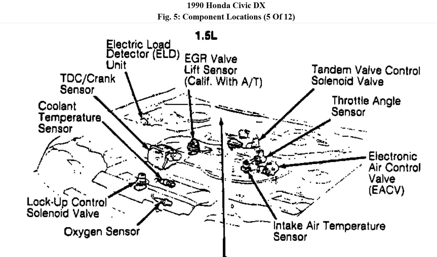

I checked the code on the ECU which flashed 14 times. I checked it several times and so did Chris. There were no other codes. The Haynes book said that was the Electronic Air Control Valve (EACV) and referred me to a section.
The first thing the section said to do was to remove the Hazard fuse for 10 section to reset the ECU. Then retart the engine and see if the Check Engine light comes on again. I'm guessing it won't. As it was intermittent before. The first time the engine was surging and the light came on I shut it off and restarted and the light was gone and all was fine.
They have instructions to find the EACV and further instructions on how to check things if it comes on. But what if it doesn't come on?
Also the book says the EACV a cylindrical device that, if its a multi-point system, is mounted on the backside of the intake manifold. If it's a dual system it's located on the left driver's side of the intake manifold. I think I found it and if so its on the left side drivers side. But to be sure, do you know if my 1990 Honda Civic HB DX a multi-point system or a dual point system? How do I find this out, I mean what type system is that?

Your's is a 1.5 TBI (throttle body injections and the EACV is on drive side. See diagram, not too good graphic though.
If problem is intermittent, it most likely is a loose or contminated wire connector. Part should look soething like the one in video but your should ab all aluminium unlees it has ben changed to the newer version with the black cylinder.

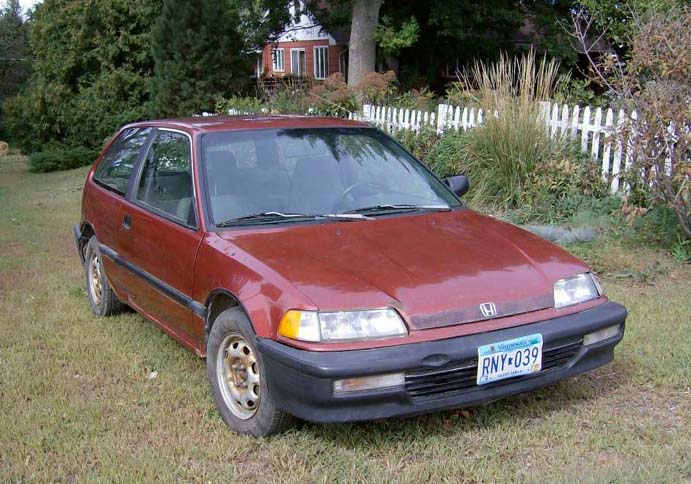

Well, surprise surprise! He said the only leak for radiator fluid is tiny drops from the house wehre after a short time of warming up the clamps required tightening. Problem solved. Radiator fluid was full. It passed the pressure test with flying colors.
Trans fluid full and clean looking. No prob there.
Gaskets. . .he noted some minor oil leaks and said there was little evidence that any of the gaskets needed to be replaced. A car that age is bound to have some leakage but he recommended I not bother with replacing any of the gaskets at this stage. Oil on engine is not enough to warrant concern.
Front brake rotor is in need of replacing, but brake pads are brand new. Now he said he wouldn't bother with a rotor, let the seller take care of it. But I wonder if new pads on a warped roter is not a good idea. Won't that wear the pads? I found on car-part.com
"brake rotor/drum front" (that's how it's phrased) in A condition for a 91 Honda Civic in stock at a yard near me for $20. It may be better then what I have on there now and might make it safer. A waste of money or worth a shot for the sale?
He didn't check the EACV, said the problem had to be showing in order for him to check it. Makes no sense to me. If you go around the EACV and check the wires and voltage and ect and so forth, wouldn't it show a problem if there was one even if the actual symptoms are not active? But then again, it is intermittent, so I guess I do see the logic. If it's not acting up, its not going to show the problem. Anyway, the codes still in the ECU. I can pull the hazard fuse and let it disappear or leave it for the next buyer. I think I'll leave it and give him/her the book.
He basically said for a car that old it's a pretty good runner and has a lot of live still left in it. Not bad for 328,000 miles. Those Hondas are something else.
