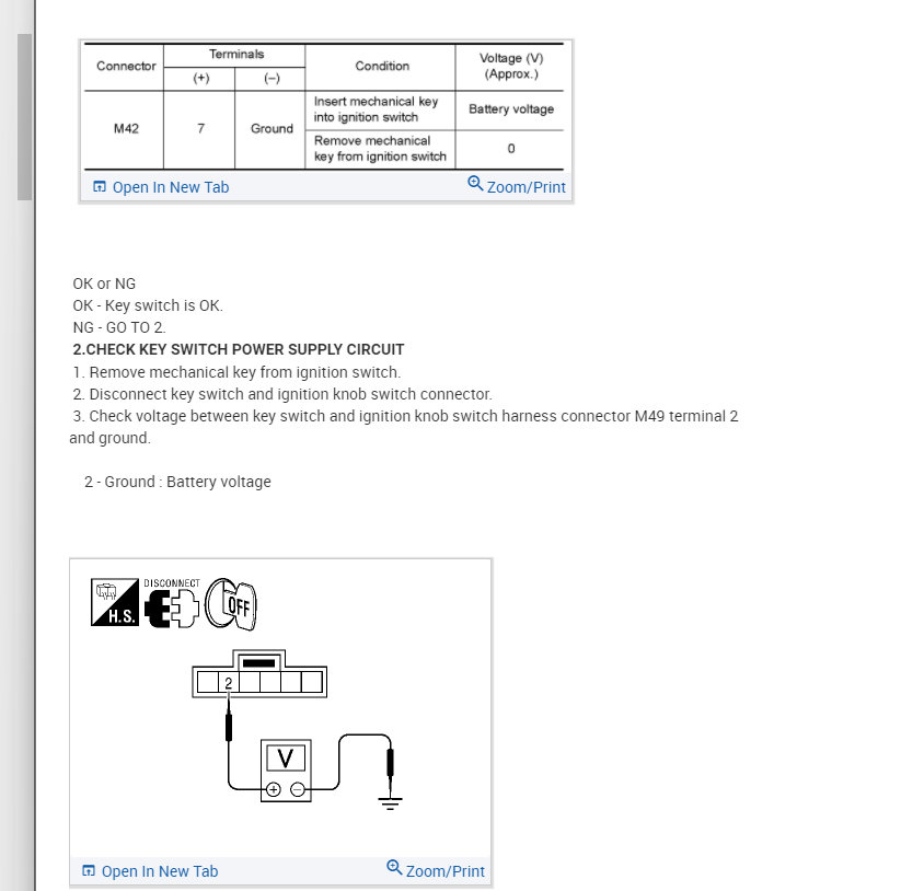

Bought this car from an auction. Didn't start, jumped it, drove it home. After getting home it won't start, used scanner, says. P 1610 lock mode, 1614 chain of immune key.
Please help.
Apr 4, 2022 at 6:51 AM

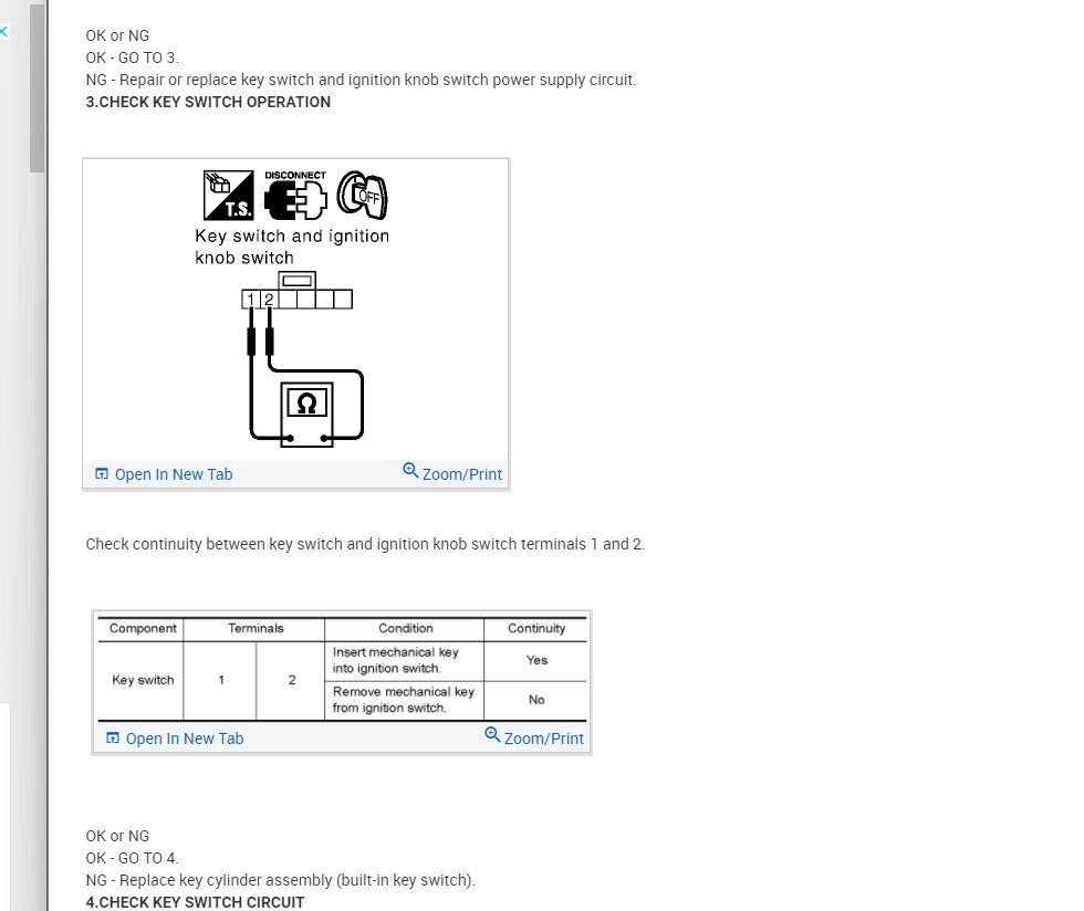

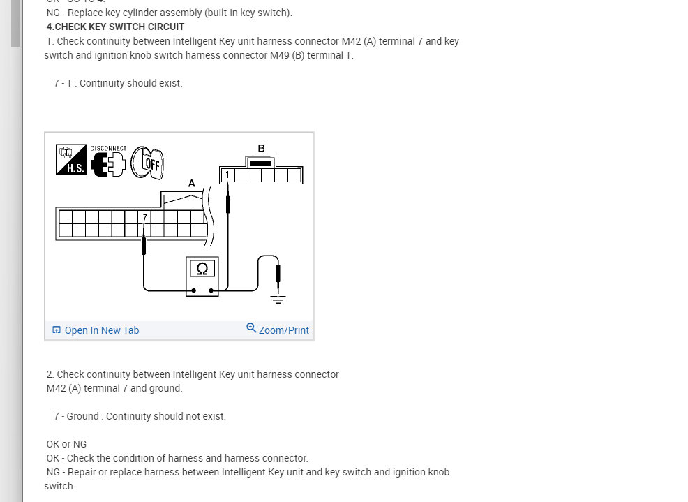

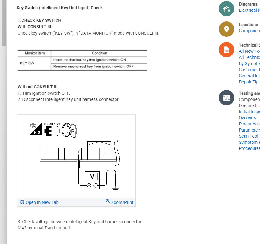

This is normally just due to a faulty key. However, this could be an intelligent key unit or even a body controller.
So, we need to run through this testing to find out what the cause could be.
Here is a guide that will help us with doing this testing:
Please see the info attached below and let us know what you find, and we can go from there.
