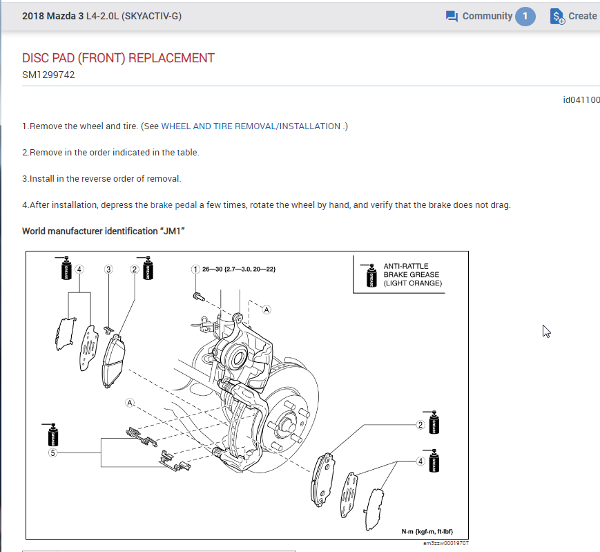

I need to replace the front brake pads and rotor on my car do you know which brake pads are best? Please give me instructions to do so, thank you.
Feb 5, 2021 at 4:00 PM
I would suggest using ceramic pads as they are less noisy and not as much brake dust. However, they are softer so if you want the most life and don't mind possible noise and dust then the semi metallic are the way to go.
Here is a guide that will help with this:

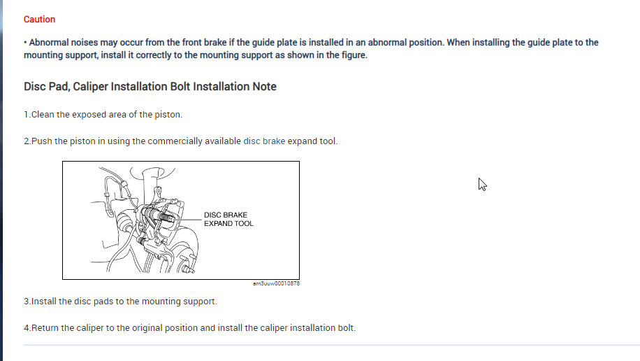

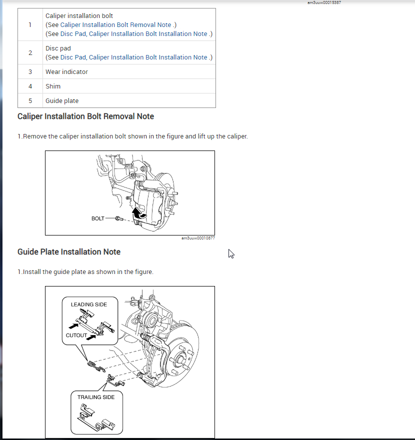

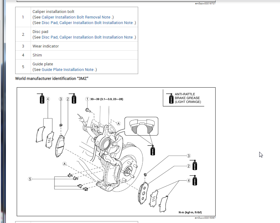

Below you will find the instructions from the manual on how to do this.
Let us know if you have questions. Thanks
