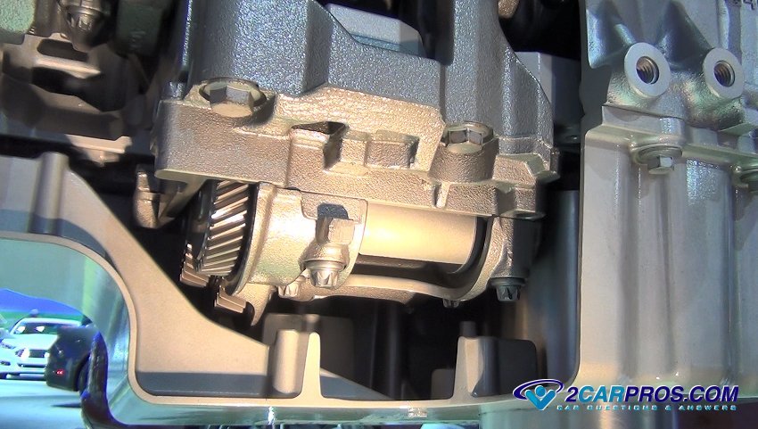

A balance shaft mechanism consists of two counter weighted shafts driven by the crankshaft, a balance shaft belt or chain is used to rotate the shafts to counteract vibrations created by the natural characteristics of the engine's operation. The belt or chain can break or become out of synchronization with the crankshaft either by worn timing components, or a possible misalignment when assembled. To inspect for this problem, remove the timing belt cover and inspect timing belt or chain marks for proper alignment. These shafts can also be driven from an independent balance shaft belt or chain which can be separate from the camshaft timing belt or chain. If the balance shafts are non-operational due to mechanical failure or wear the engine will vibrate, here is an image of the engine balance shafts which can cause a rattling noise when bad as well.

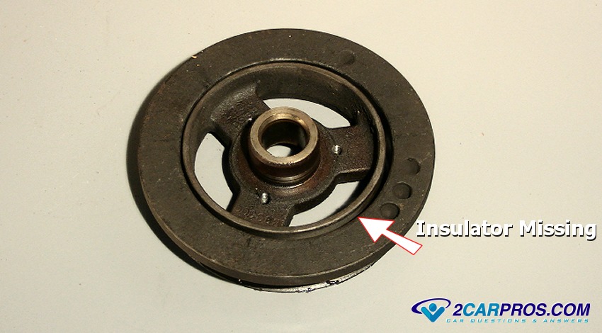

Engines are designed to be internally or externally balanced, this is achieved by counter balances in the harmonic balancer or the flywheel-flex plate. If one of them has a problem or the incorrect parts have been installed the engine will have a noticeable vibration. Below is an image that shows a harmonic balancer that has come apart which can produce an abnormal noise.
failed dampner

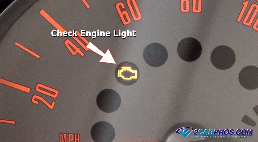

When an engine misfire occurs it will cause a vibration which will begin happening when the engine under load or acceleration, all engines are symmetrical and when part of the cycle is missing the engine becomes off balanced. This can trigger a check engine light which can help detect the particular cylinder having the issue.
check engine light

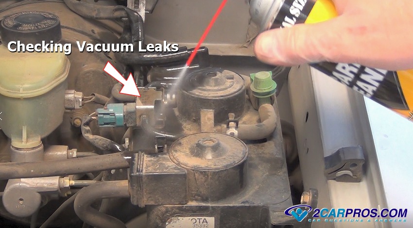

Vacuum leaks are a major source of engine idle vibrations, this is because when an engine is at idle it depends on the intake system to hold said vacuum more than any other time of the engine's operation, (when an engine is under load, the vacuum is reduced). Most of the time a broken vacuum line can be easily observed. To test for a vacuum leak start with the engine cool and allow to idle, use carburetor cleaner and lightly spray around the vacuum hoses (avoid exhaust manifolds) if the idle speed increases you have located the source of the leak.

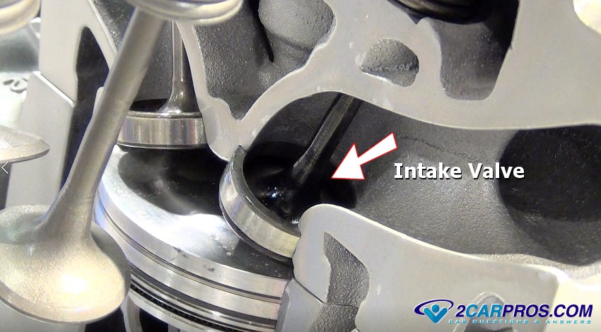

The intake valve must seal completely for the engine to run smoothly at idle, if an intake valve leaks it will allow exhaust gases to enter the intake manifold and into the intake charge of the additional cylinders causing a vibration at idle. To test this condition a leak down test must be performed, if positive results are produced for leakage, a valve job is required.
