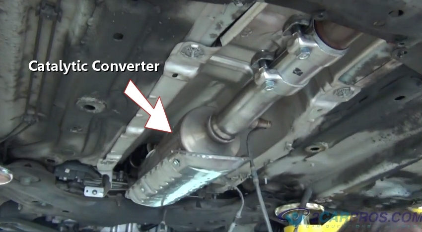

4. Catalytic Converter
A catalytic converter is designed to convert partially burned gases to completely burned gases. This is done when the converter becomes hot unitizing a thermo reaction due to the catalyst material inside the unit. Some cars use an electric air pump which injects air into the exhaust system just after the exhaust ports of the cylinder head to help heat up the catalyst and optimize efficiency.

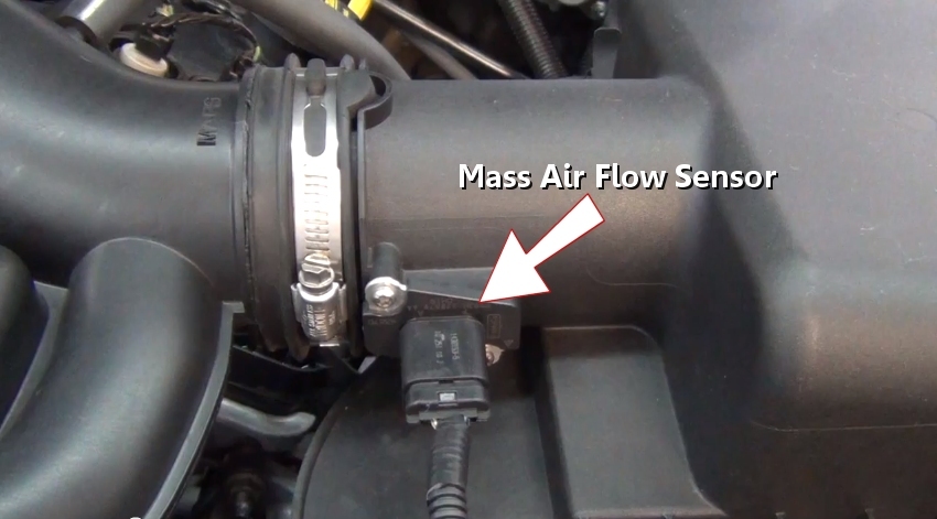

5. Mass Air Flow Sensor
A mass air flow sensor monitors airflow that enters the engine by measuring resistance across a hot wire that is cooled when different amounts of air pass over it. This feedback data trim adjustments to further help clean emission outputs by not allowing excess fuel to enter the engine during excessive throttle input.

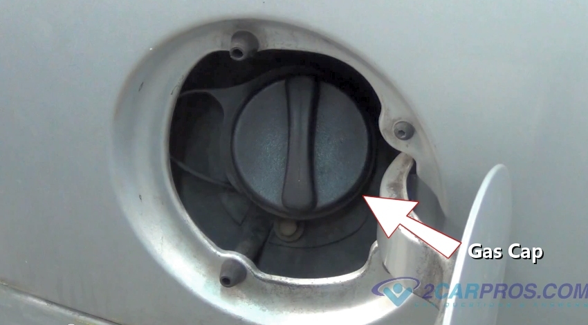

6. Gas Cap
A gas cap seals liquid fuel and fumed gases from escaping the fuel tank. This cap is designed with an automatic tightening mechanism to support the minimum tension the cap must be installed at while sealing against the tank filler neck using an O ring seal.
