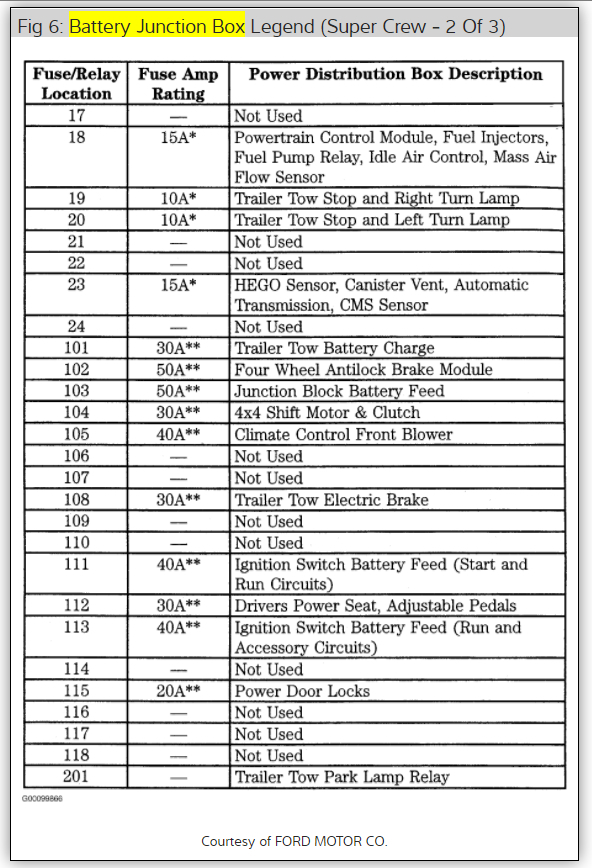

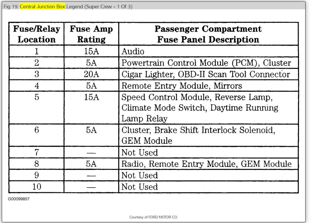

Fuse panel location, I popped a fuse hooking the battery up
186,000 MILES • 1.5L • V8 • 2WD • AUTOMATIC
FAYETTEFLYERS

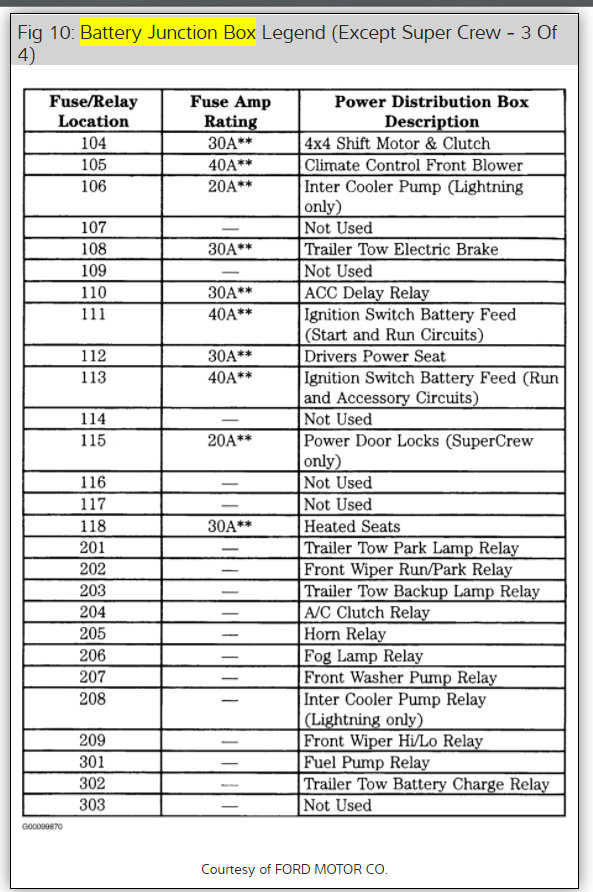

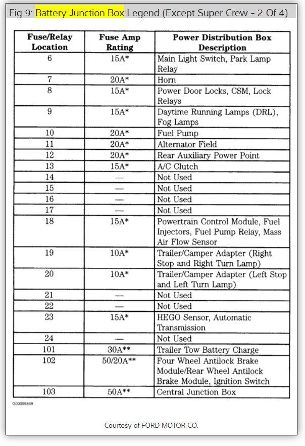

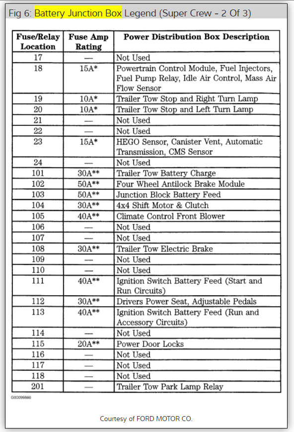

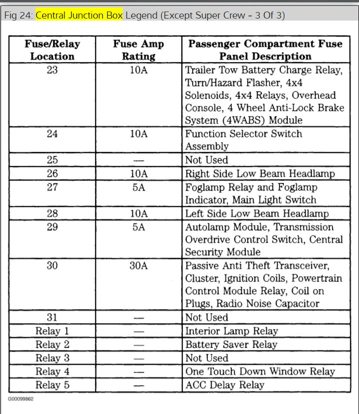

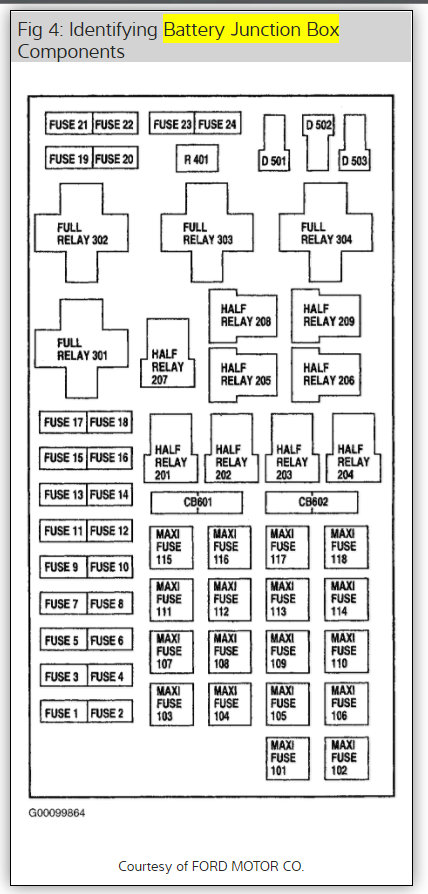

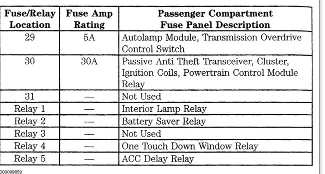

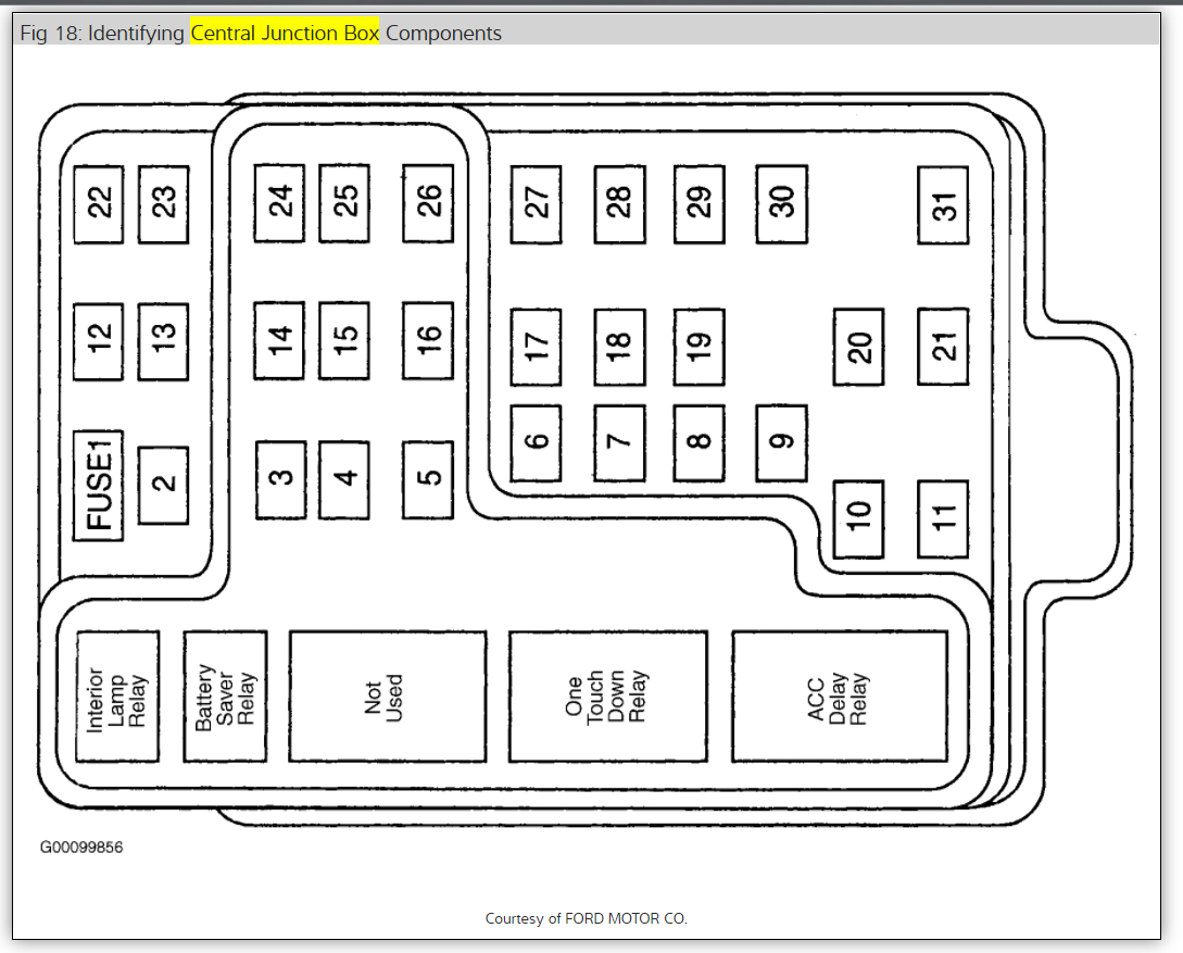

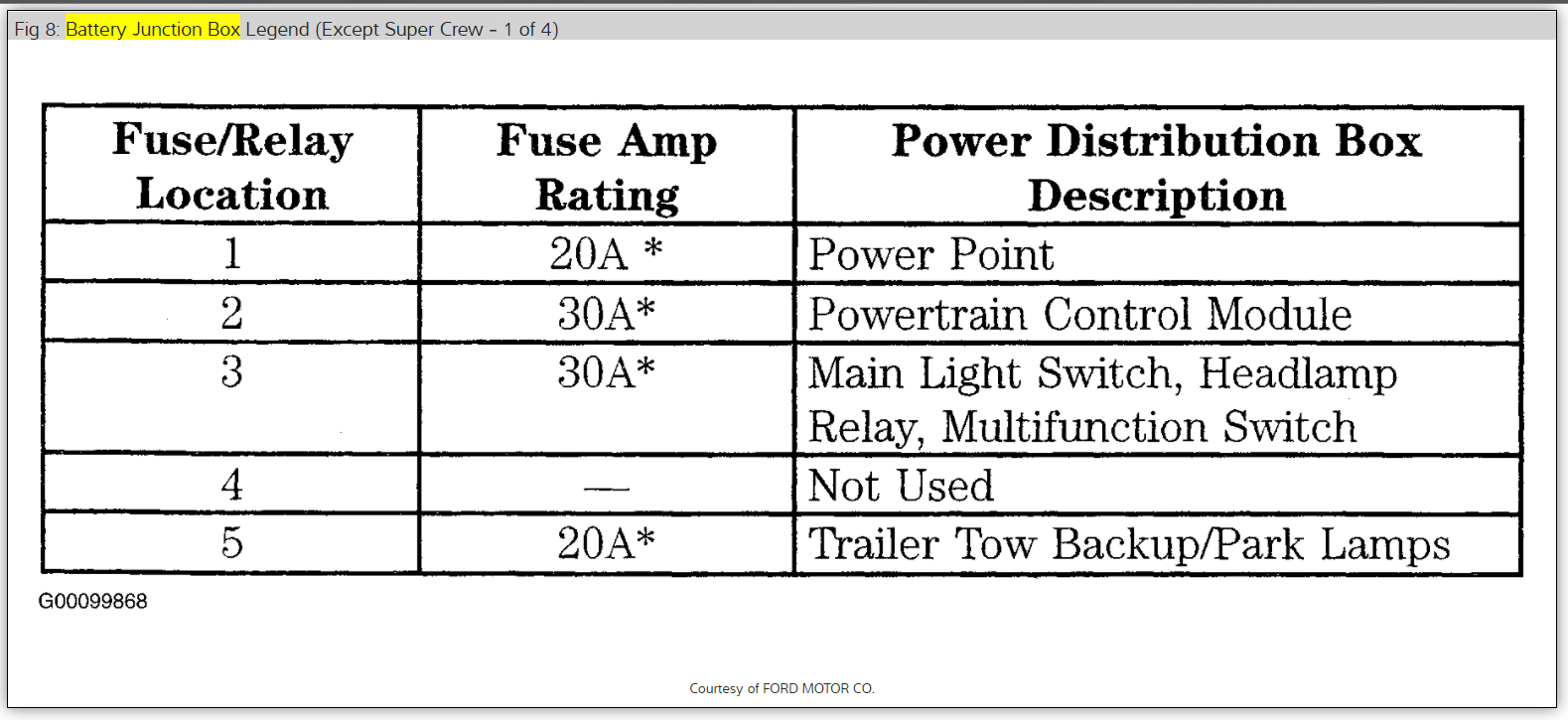

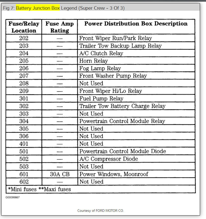

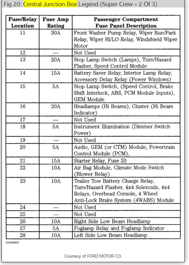

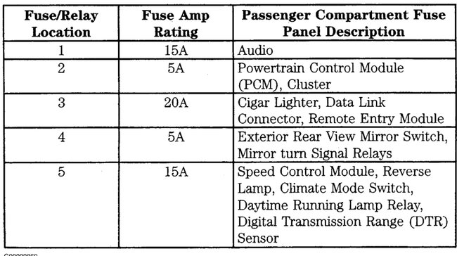

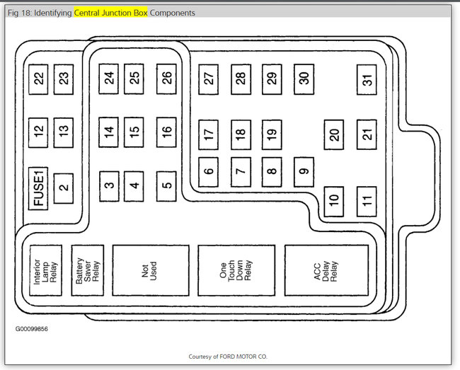

I was deployed for six months. I disconnected the negative cable on the truck. Was parked in my garage which has a small incline. Upon my returned I connected the negative cable and it would not start. The battery is fully charged but I think a blew some fuses
Apr 11, 2018 at 7:56 PM
  • 55,649 POSTS
It sounds like you had a voltage spike when you connected the battery I would start by checking the fuses.

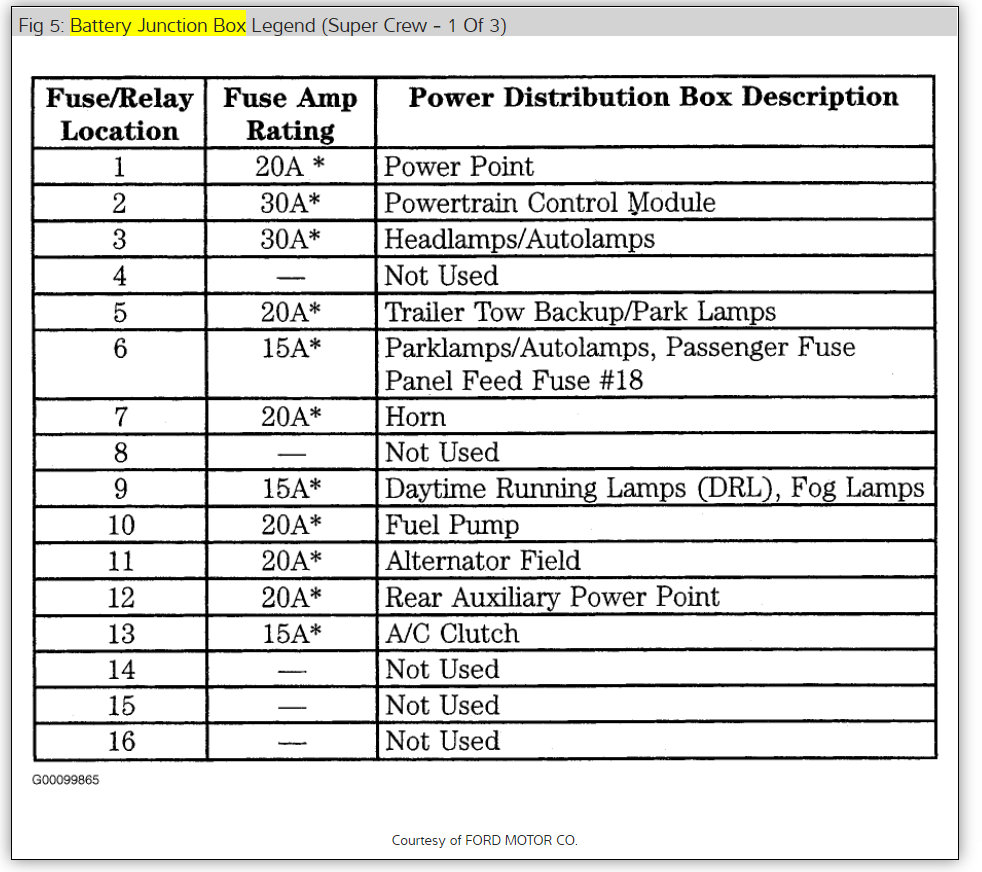

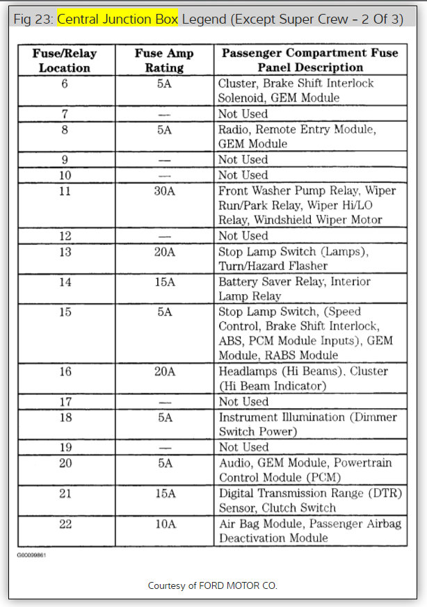

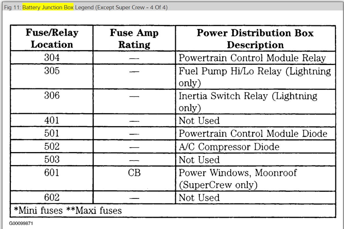

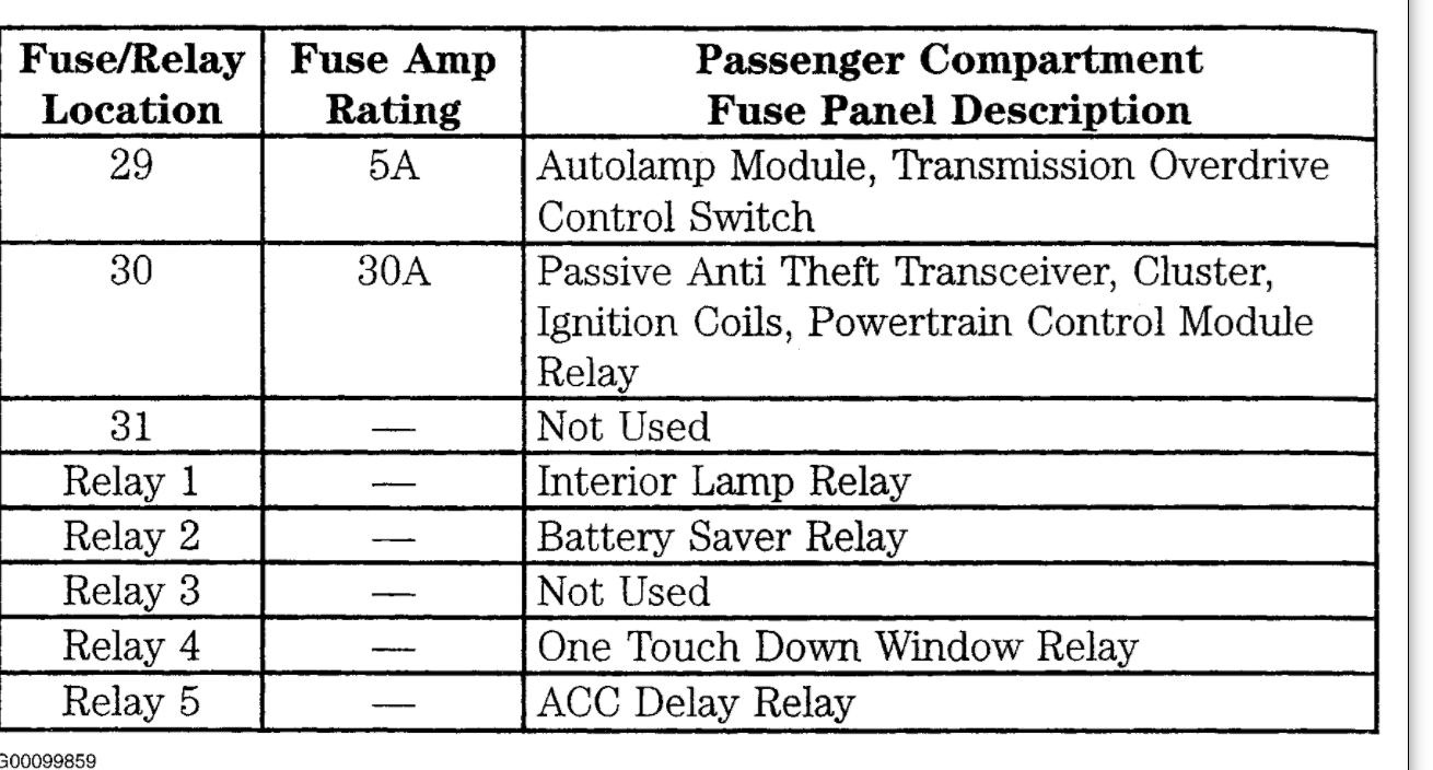

Below are the fuse locations.Check out the diagrams (below).Please let us know what you find. We are interested to see what it is.
