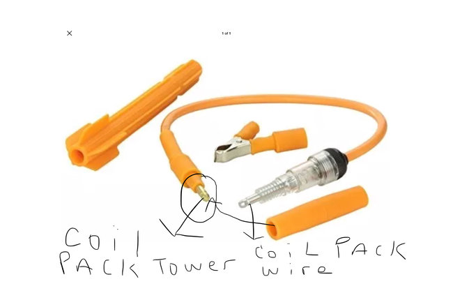

I was thinking about buying this to check the coil packs. Would this work? Steve you said use spark test to check each tower on each coil at a time for spark.
Apr 22, 2018 at 3:13 PM
STEVE W.
  • 15,200 POSTS
That will work. I use one similar to it all the time just to verify if there is spark while I turn turn the key.
