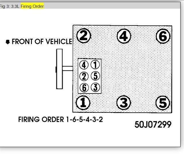

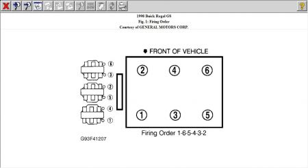

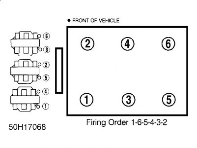

What is the proper firing order for the 3.8 liter v6

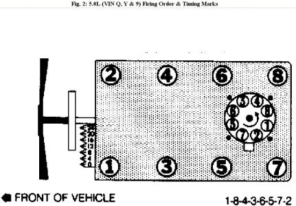

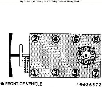

What is the firing order and wire to cap placement is it the same as all gm hei

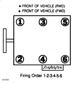

I need the firing order, three coils up front.

Here is the engine firing order. Check out the diagrams (Below). Please let us know if you need anything else to get the problem fixed.
Image (Click to make bigger)
