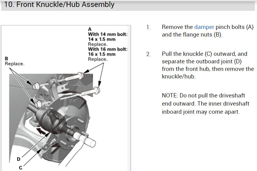

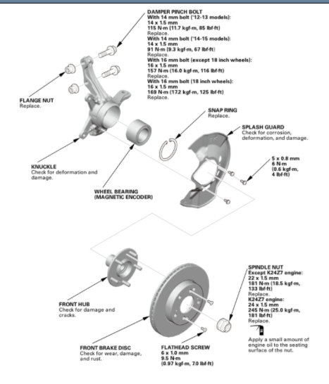

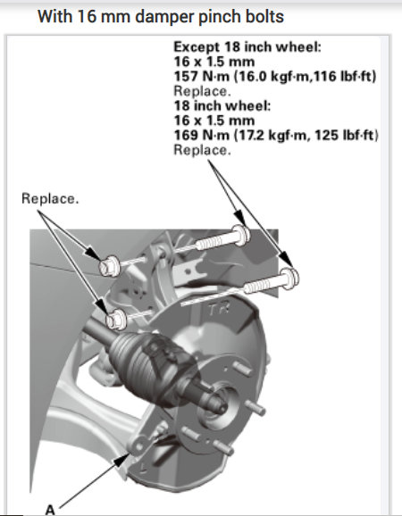

Hello, the noise I have been hearing has been getting worse. When I come to a stop under fifteen MPH, but the worst ten to fifteen MPH I hear a weird noise like a woo. When I am going slow around a parking low and turning I hear the same noise and a wo wo wo kind of. That noise is around six to eight MPH.
Mar 28, 2018 at 8:02 AM
DANNY L
  • 5,648 POSTS

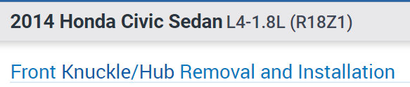

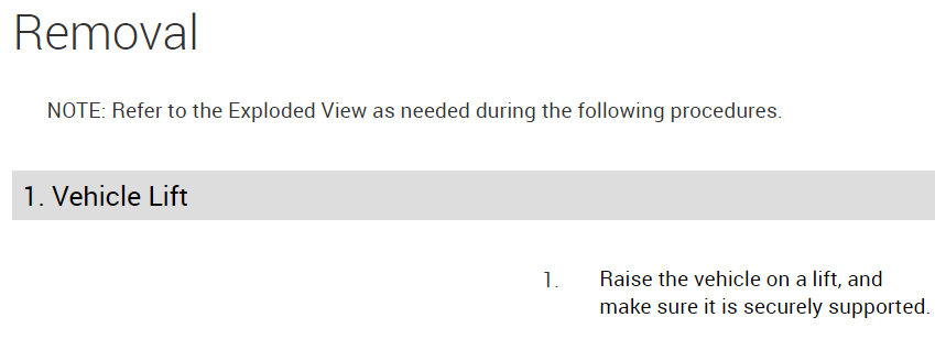

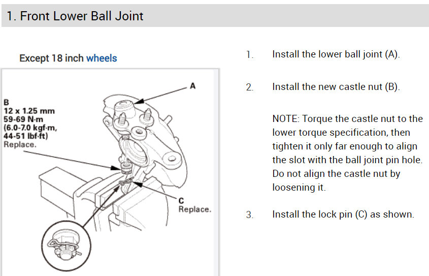

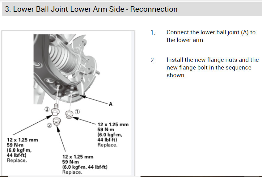

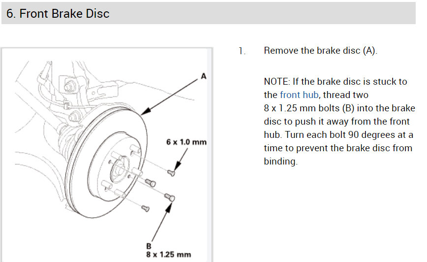

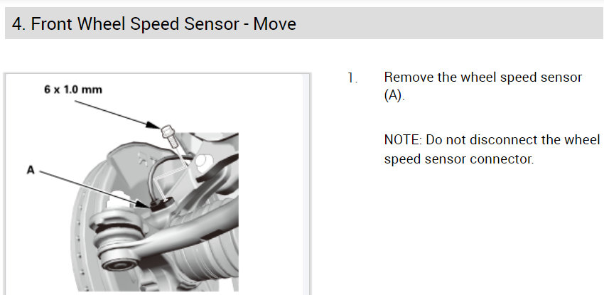

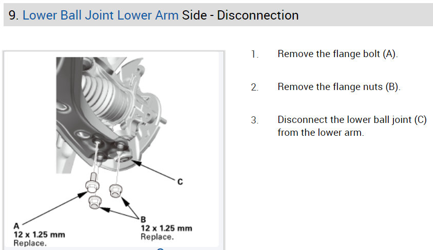

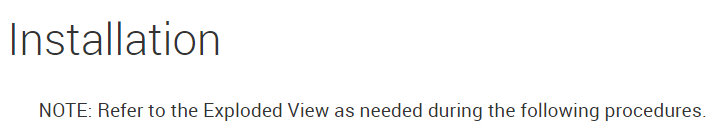

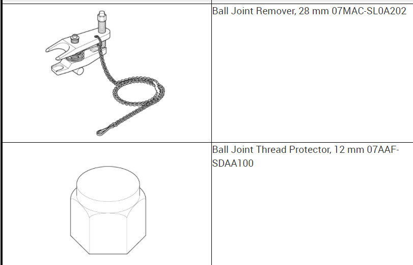

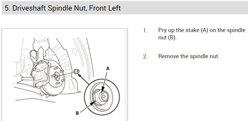

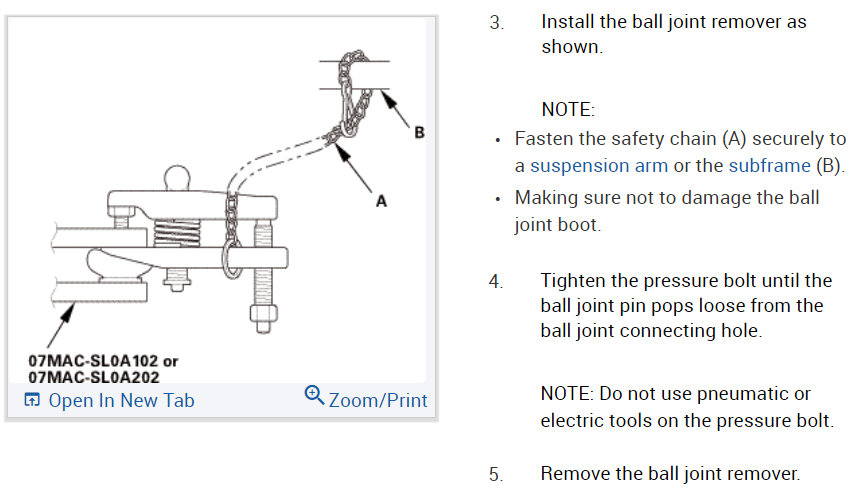

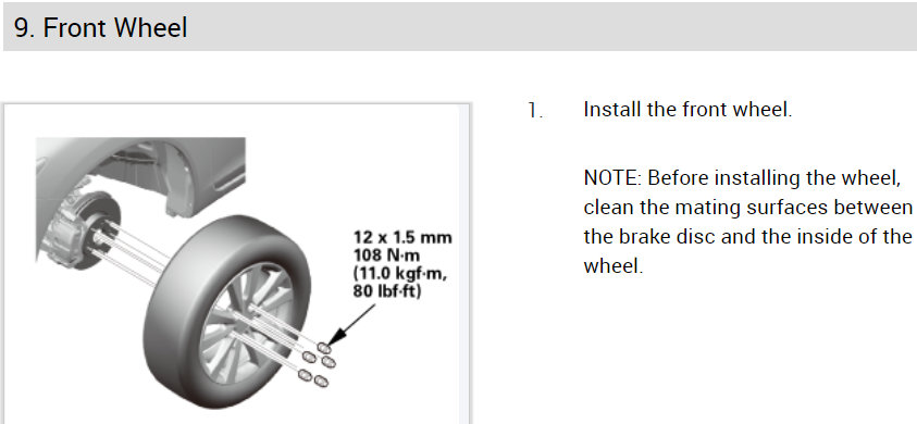

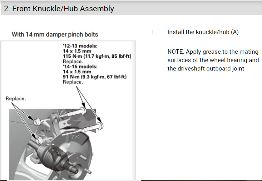

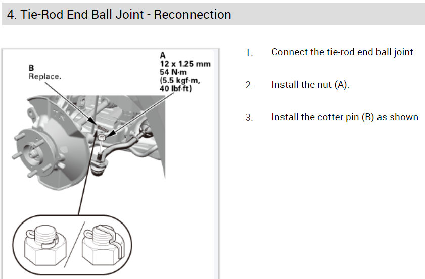

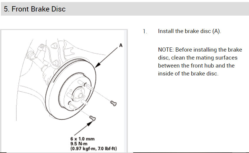

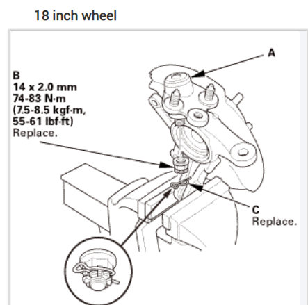

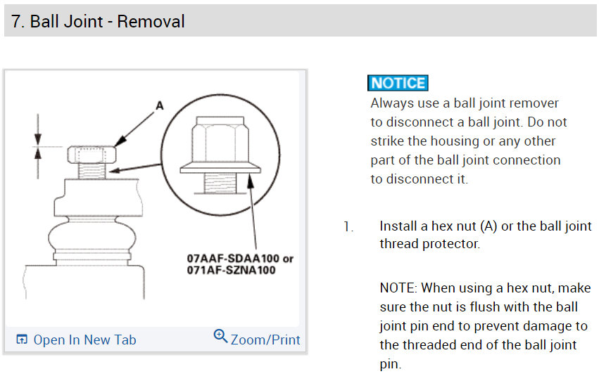

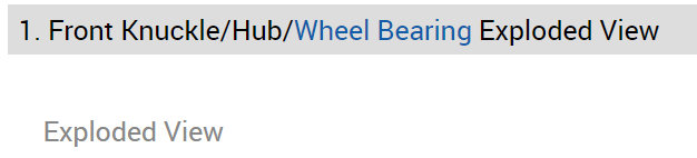

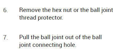

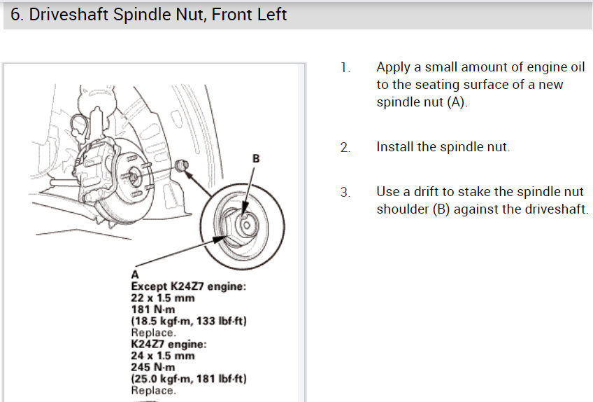

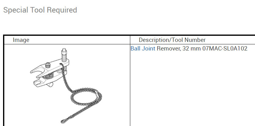

Hello, I'm Danny.

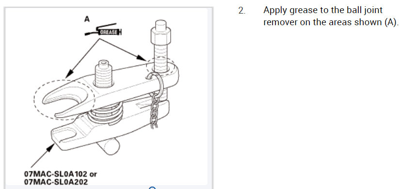

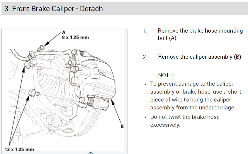

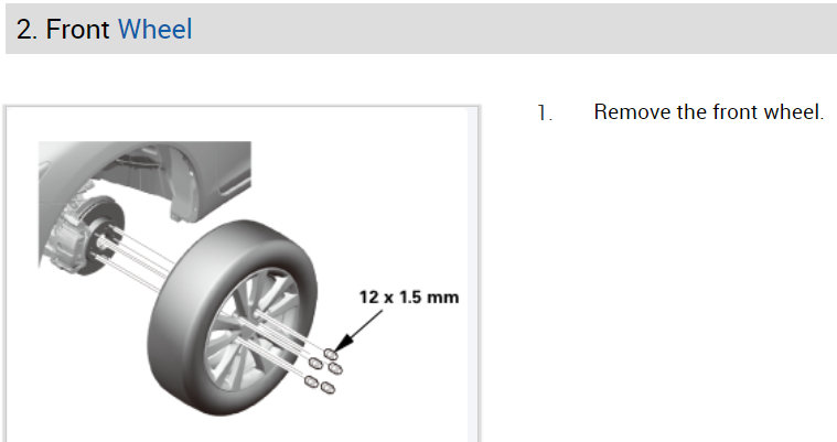

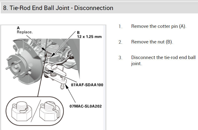

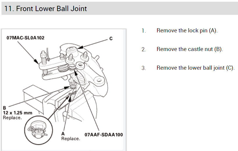

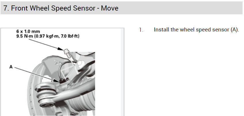

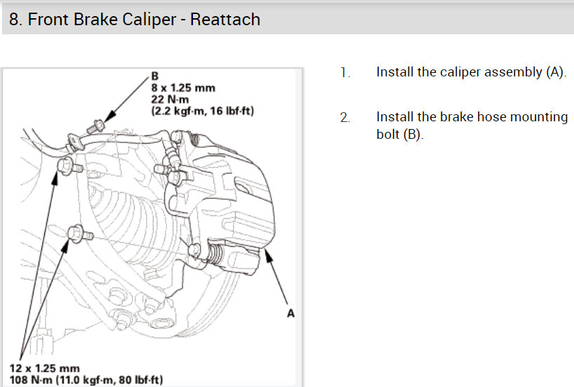

It sounds like you are having an issue with the front hub assembly. Here is a tutorial showing how to replace a hub assembly:
https://www.2carpros.com/articles/bearing-hub-replacement
I've attached picture steps below showing how to replace the front hub assembly for your car below. Hope this helps and thanks for using 2CarPros.
Dec 8, 2020 at 4:18 AM

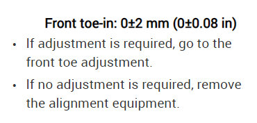

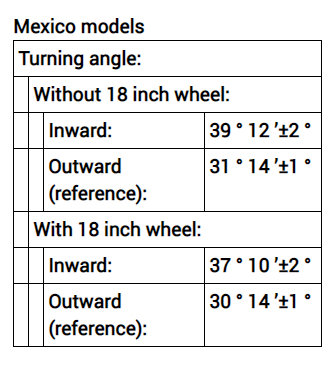

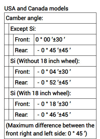

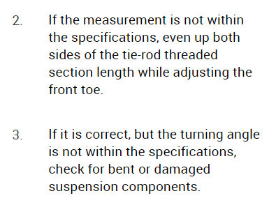

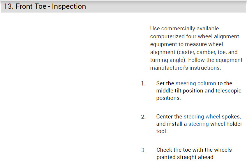

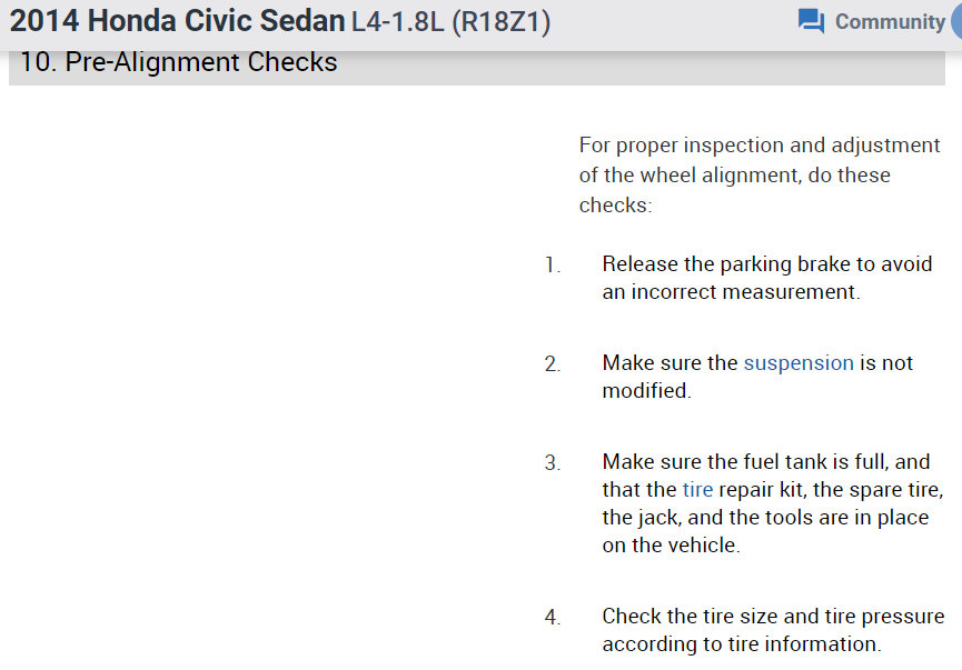

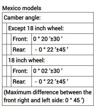

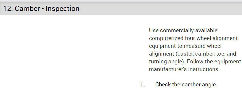

DANNY L
  • 5,648 POSTS

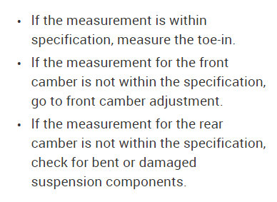

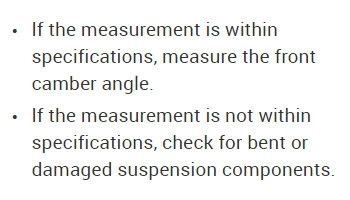

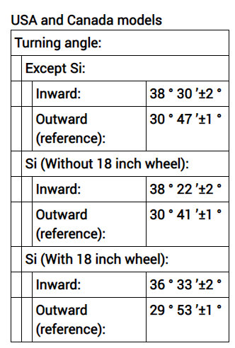

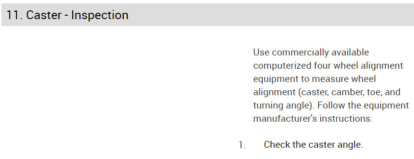

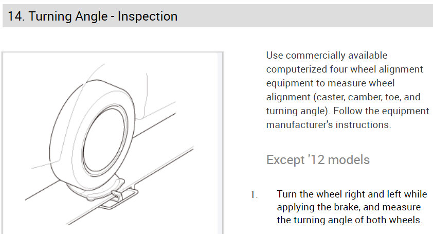

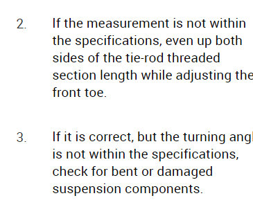

Hello again.

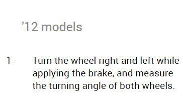

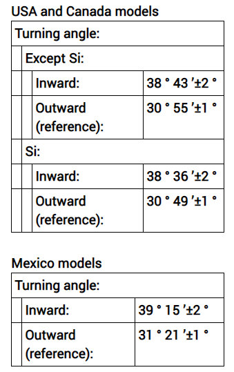

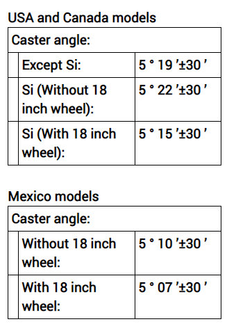

After completing the repair here it is suggested to have an alignment done. I've attached the Honda specifications below. Hope this helps and thanks again for using 2CarPros.
Dec 8, 2020 at 4:29 AM
