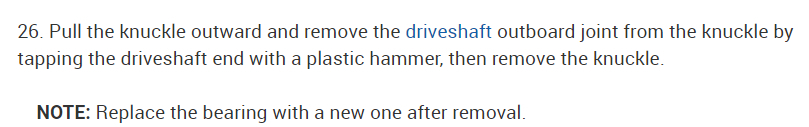

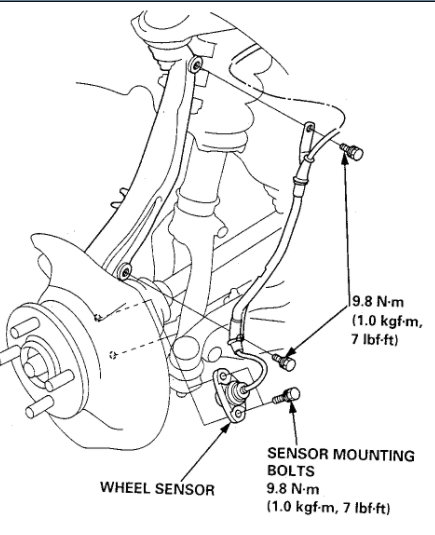

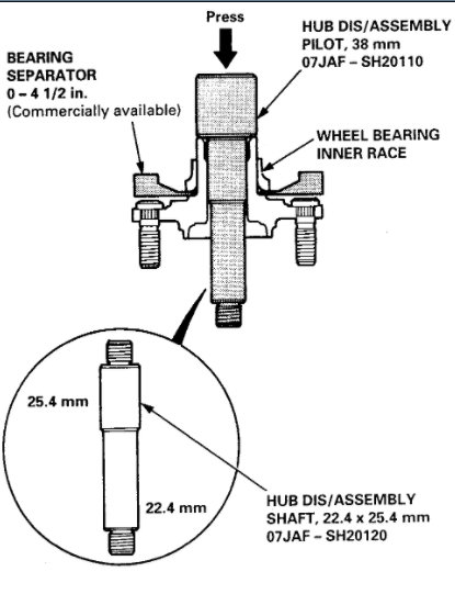

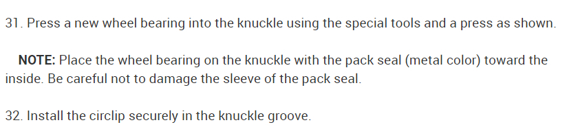

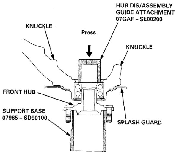

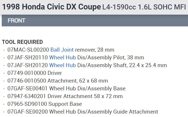

B1XAFE64
  • 1998 HONDA CIVIC

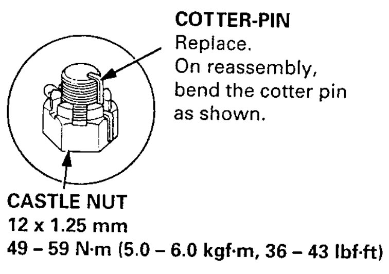

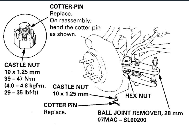

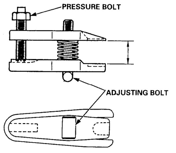

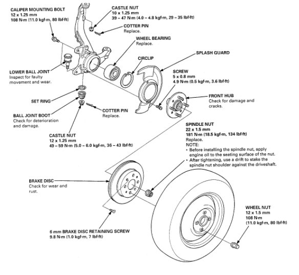

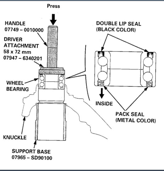

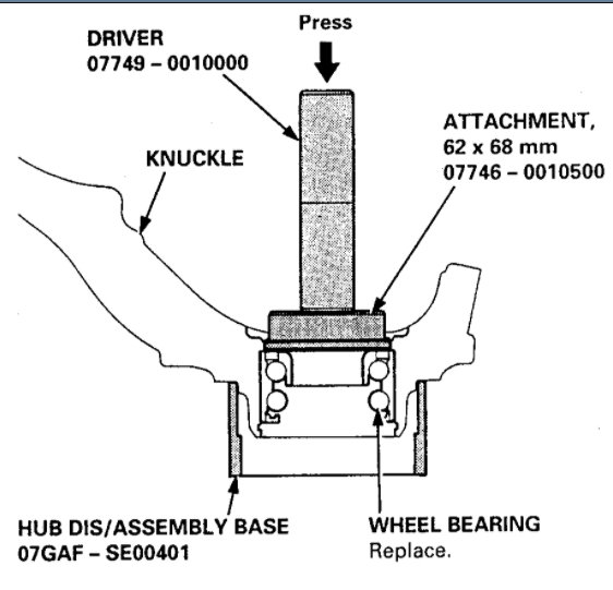

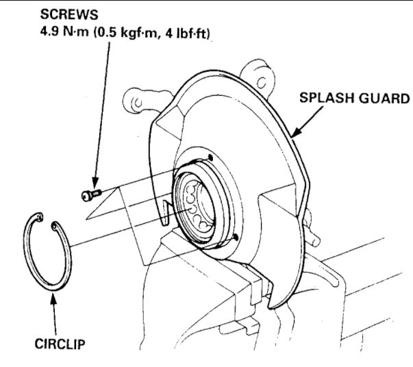

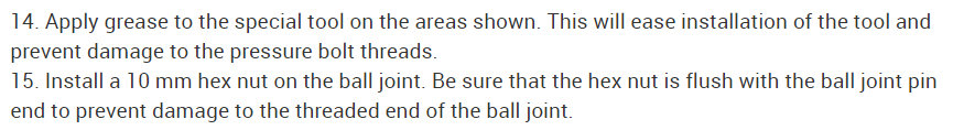

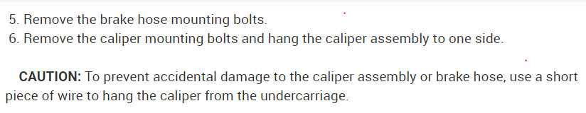

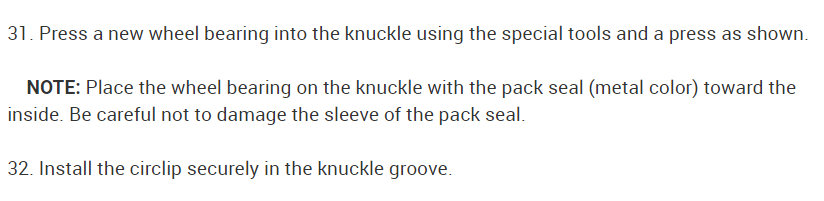

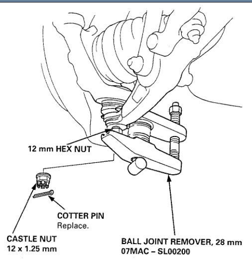

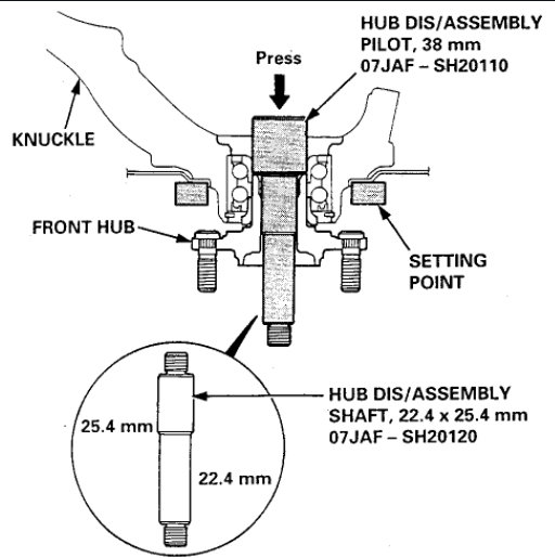

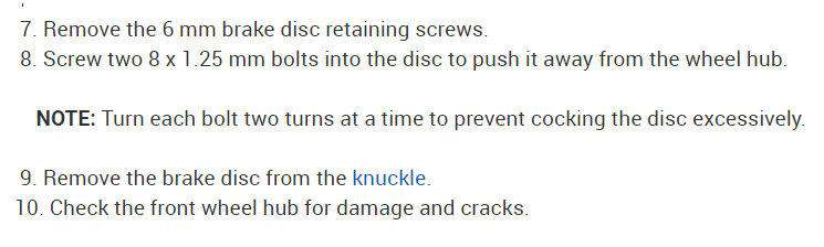

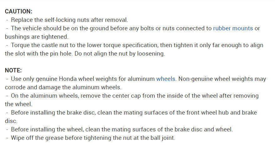

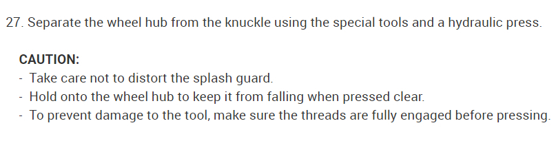

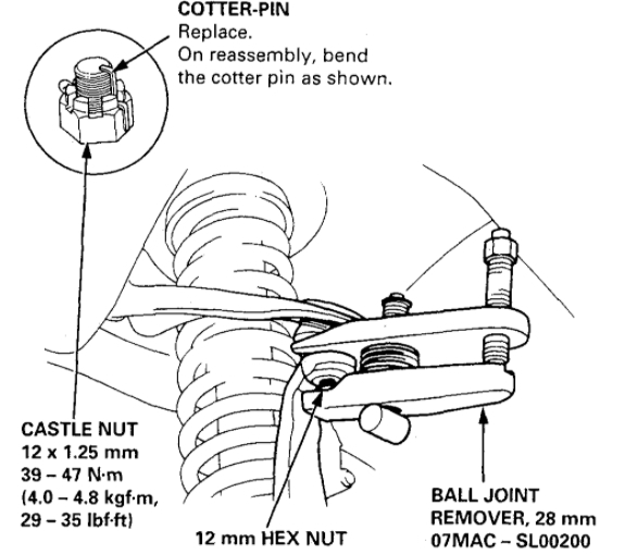

I have removed the front wheel bearing assembly and I am unable to remove the bearing from this hub assembly to replace the new bearing.
How do I go about separating this assembly?
Thanks 1.6 liter engine with ABS.
Friday, December 11th, 2020 AT 1:03 PM (Merged)
DANNY L
  • 5,648 POSTS
Hello, I'm Danny.

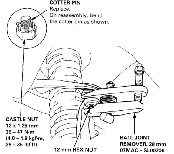

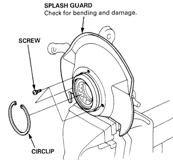

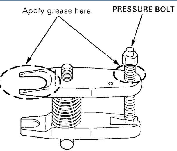

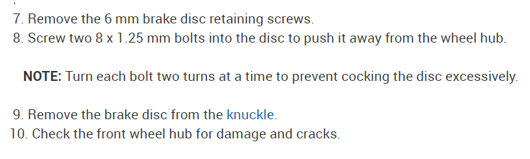

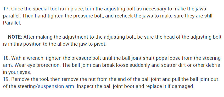

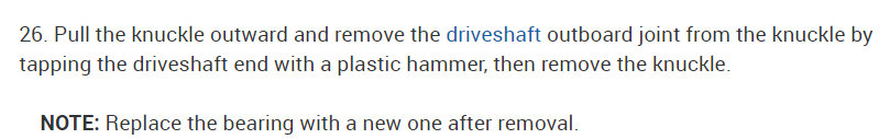

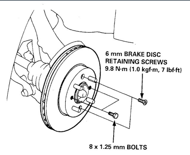

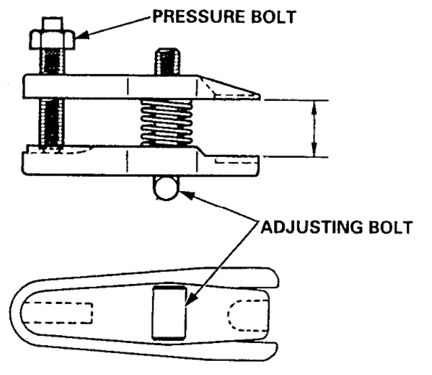

Usually the bearing in the front hub assembly is sealed and not serviceable. However, The bearing in the spindle-knuckle assembly can be replaced by using a punch to press it out and the new one back in. Here are a few tutorials for you to view that can help you during this process:
https://www.2carpros.com/articles/bearing-hub-replacement
https://www.2carpros.com/articles/bearing-press-how-to-use

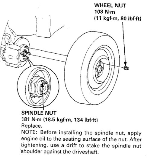

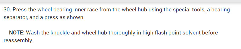

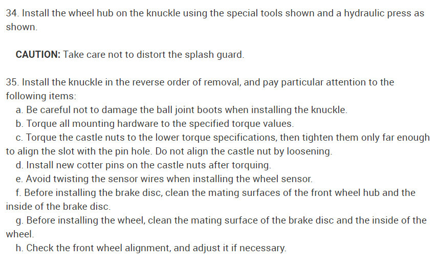

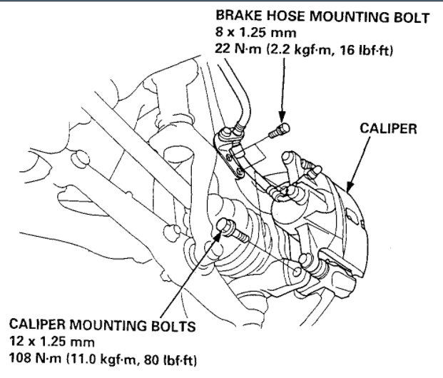

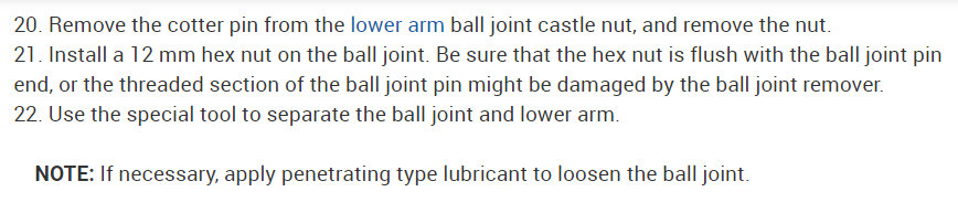

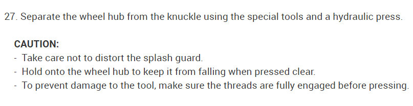

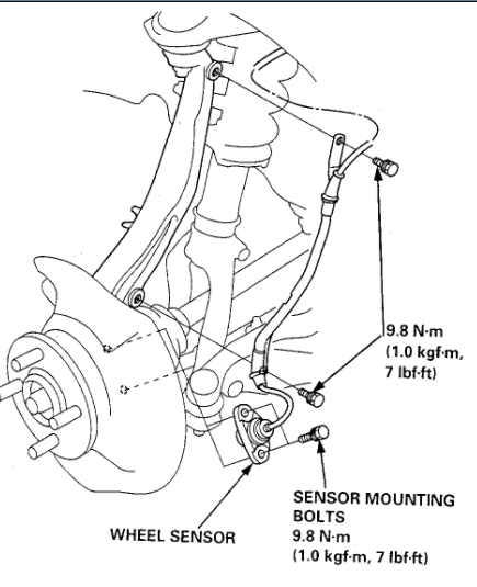

I've attached picture steps below on the the front hub and spindle assembly for bearing replacement on your car. Hope this helps and thanks for using 2CarPros.
