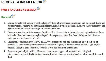

1994 Honda Civic front passenger wheel hub
1994 HONDA CIVIC
213,000 MILES • 4 CYL • FWD • MANUAL
BJANEZIC
i snapped 3 studs off, i got the hub nut off but cannot get the hub to budge, i must be missing something, how do you get that thing off of there?

BLUELIGHTNIN6
  • 16,542 POSTS
https://images.2carpros.com/forum/automotive_pictures/261618_Noname_880.jpg
https://images.2carpros.com/forum/automotive_pictures/261618_Noname2_231.jpg
