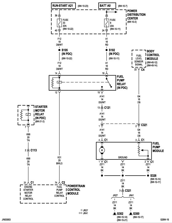

Hi, this is my daughter's car. it will not turn over with the key? I can jump a wire to the starter and it will turn over but not start. I cannot hear the fuel pump hum so I am guessing that is why it will not start. It ran fine until one day this just happened. She walked out and got nothing. All headlights, blowers, etc are working. I am assuming that the lack of power only to the starter and fuel pump happening at the exact same time are related. My question is what can cause this? And I checked all the fuses. Haha! The only other information I can add is that after switching the key on off multiple times I got a no bus under the odometer. Furthermore, it is not throwing any codes. Thanks in advance for your help!

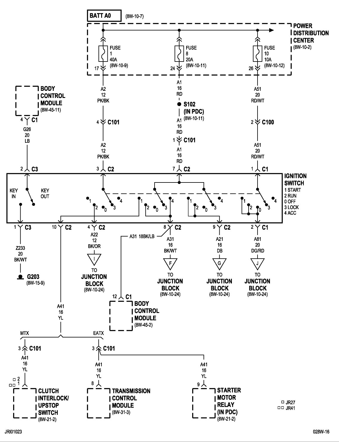

From the description it sounds like either a bad ignition switch or one of the various circuits powered off the switch is bad. If you could tell me which version she has please, we can see what the diagrams show.

Okay, first thing is to test the fuses using a test light to be sure you are getting power at each one. I like to test all of them simply because some are used for multiple power feeds not just what they are labelled.
Fuses 1, 8 and 10 are three fuses that send power to the ignition switch.

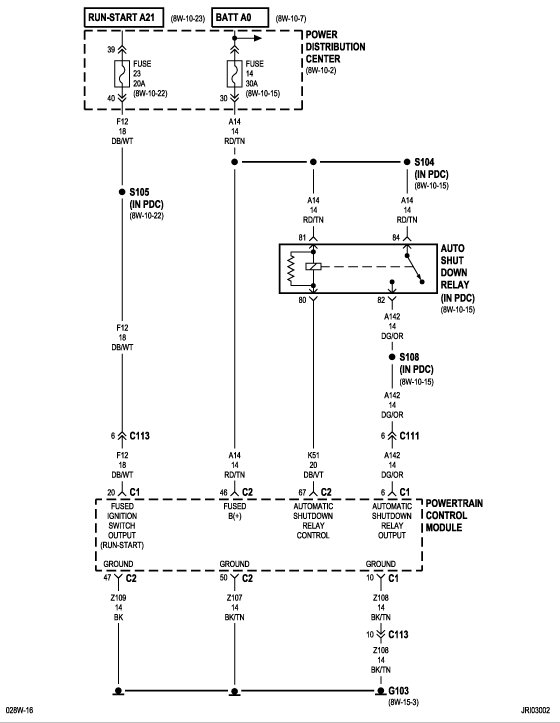

We will try the no starter activation first, then check to see if the ASD relay is okay. It sounds like the issue could be ground related on the PCM side.

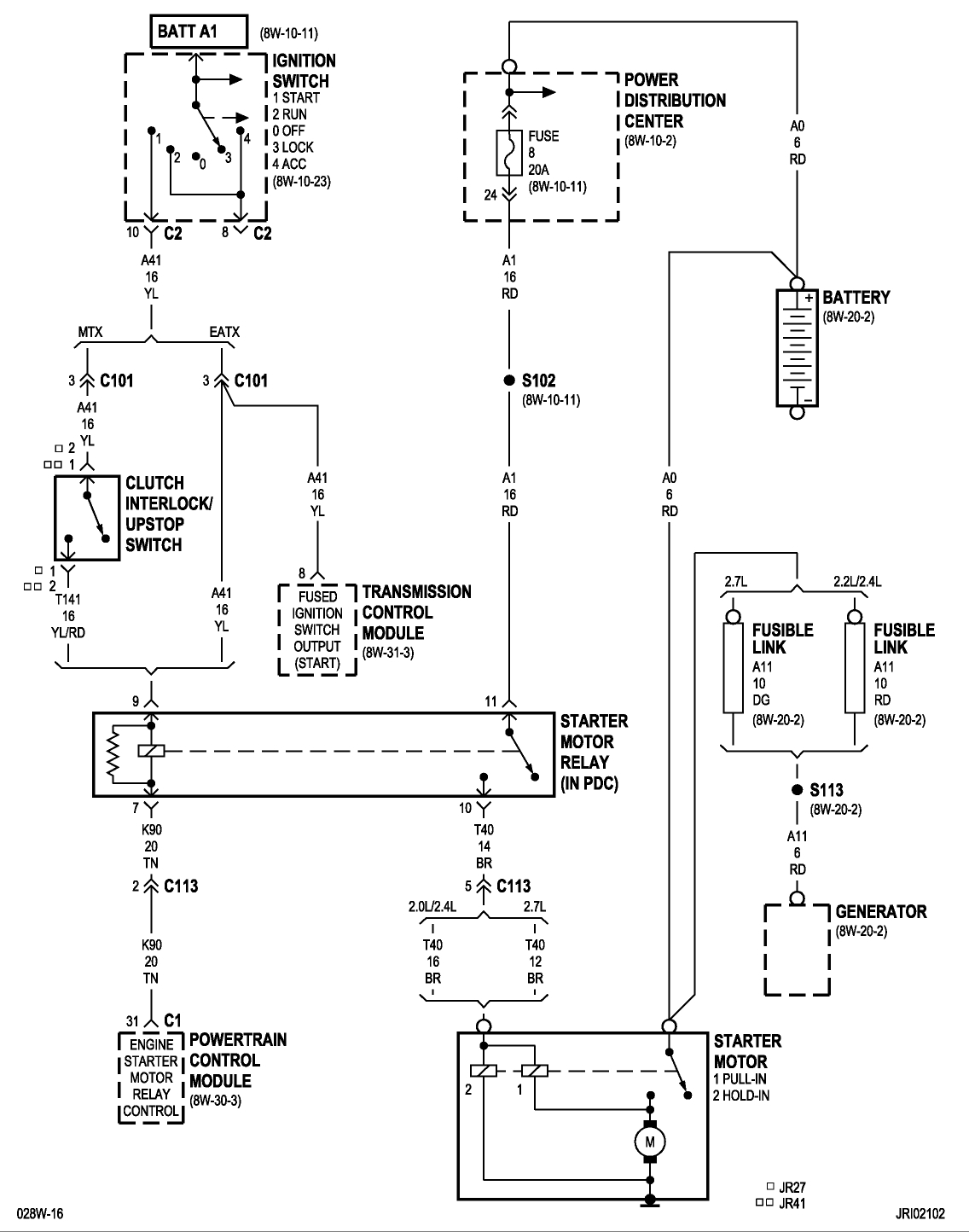

Next try moving the shifter to neutral while turning the key.
A bad transmission range switch can stop the PCM from activating the start relay.
Now using the test light, remove the start relay and probe the contacts in the PDC.
With the key held in the start position you should find battery voltage on two of the pins. If you do that part of the circuit is okay.
Next the ASD relay - It gets power from fuse 14. Remove it and you should find power on two pins there as well.
The attached diagrams show how the systems are interconnected.
