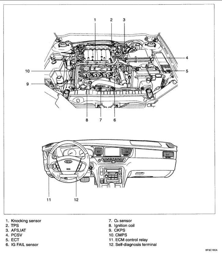

Starts fine when engine is cool but when reaches normal operating temperature and cut it off will not start until engine cools down again then starts fine, turns just will not start until engine gets cool, only problem it has is no start when hot.
Mar 25, 2021 at 3:09 AM
61CHEVYIMPALA
Not starting when it reaches normal driving temperature is the only issue...runs fine I could drive it all day and not have any problem from it if I don't shut it off
Mar 25, 2021 at 10:33 AM

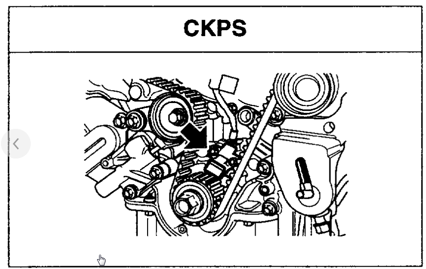

This sounds like a crank sensor has failed. Here are a few guides that will help with this in figuring out what the issue is:
https://youtu.be/dCjmRL3p4Cs
Below is the process from the manual that shows more info about this as well.
I would replace this and retest to see if it still cuts off. Let me know if you have questions. Thanks
