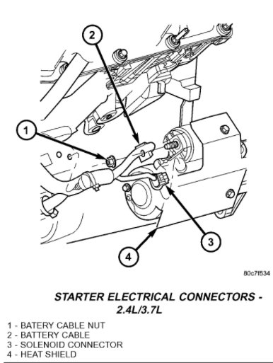

All of a sudden the car wouldn't start. have full battery power but car won't even try to turn over. Under the hood in fuse box it clicks when you try to start it. Tried to bypass relay to start car with starter motor and it tries to turn over but won't. Please help!!

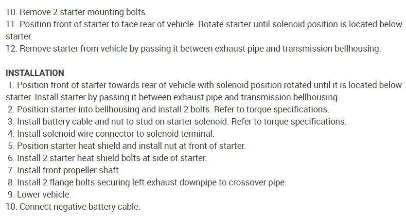

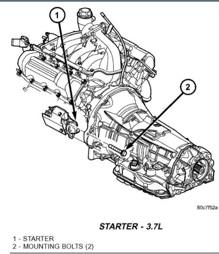

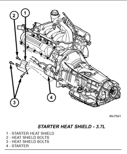

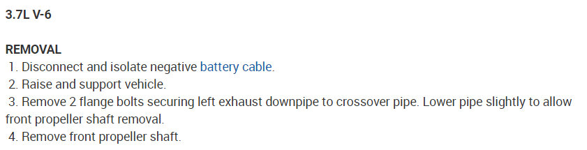

You might just be having an issue with the starter motor-solenoid assembly altogether. Here are a few tutorials on having starter issues and replacement:
https://www.2carpros.com/articles/how-a-starter-and-solenoid-works
After removal most auto parts stores will test for free.
I've attached picture replacement pictures below for your vehicle. Hope this helps and thanks for using 2CarPros.
