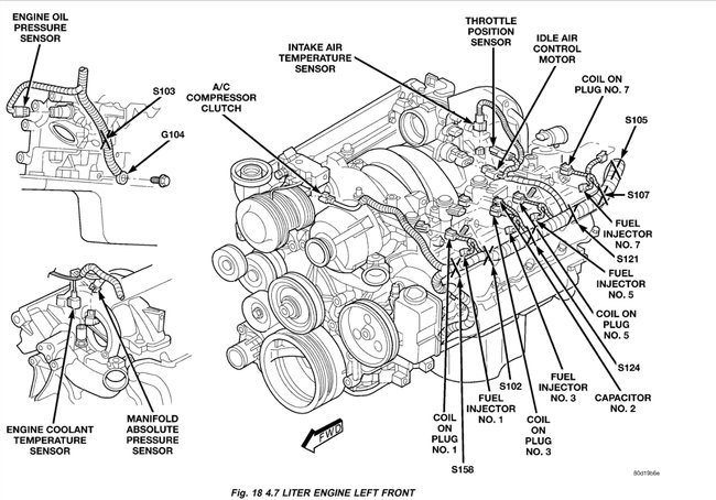

I drive about forty miles to pick up my son from school, if I cut the car off on a really hot day and come out to start it, it will not start for about thirty minutes. We drove to the beach and back with no problem. Have replaced battery, starter, alternator. What could it be?
Monday, June 21st, 2010 AT 3:53 PM
30 Replies
CARADIODOC
  • 34,047 POSTS

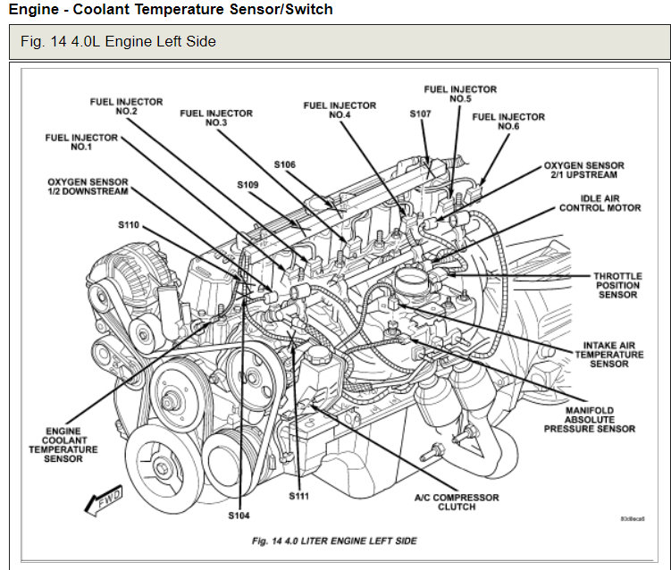

Hi Sunshine52377. Welcome. To relate it to high temperature and sitting with a hot engine for a short time suggests the engine cranks but does not start up and run. A heat-sensitive, (failing), crankshaft position sensor is a common suspect but they will usually cause a diagnostic fault code to be memorized in the Engine Computer which will turn on the Check Engine light. If no code is present I would replace the engine coolant temperature sensor. because it can cause these problems as well.
Here is a guide:
https://www.2carpros.com/articles/coolant-temperature-sensor-cts-replacement
Here is the location on your car I gave both engines.
Check out the diagrams (below)
Cheers, Caradiodoc

SUNSHINE52377
I just want to thanks you my mechanic could not find out the reason, then I replaced the coolant sensor and have not had the problem since. I love this site!
