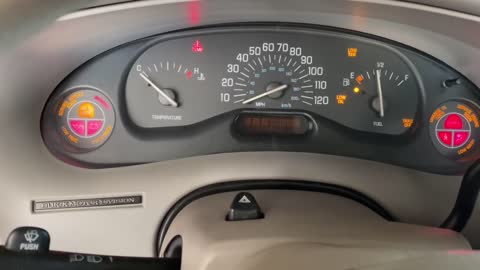

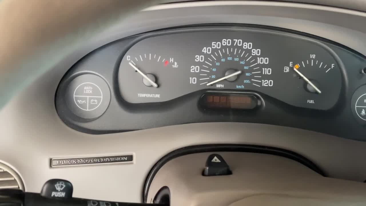

It only took a few days for this issue to arise again, and it only occurs on occasion, maybe 1 out of every 10 starts. Eventually it will start but lately it’s been several days with no luck.
Originally, we thought moving the steering up and down would be the cause and solution to getting it started but that doesn’t work anymore.
The starter was ruled out last year and the battery is relatively new.
I have a video of what it does attached.

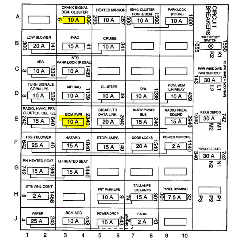

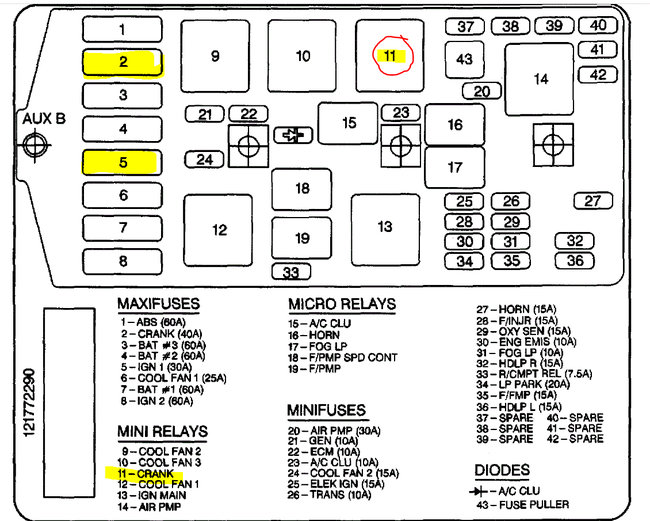

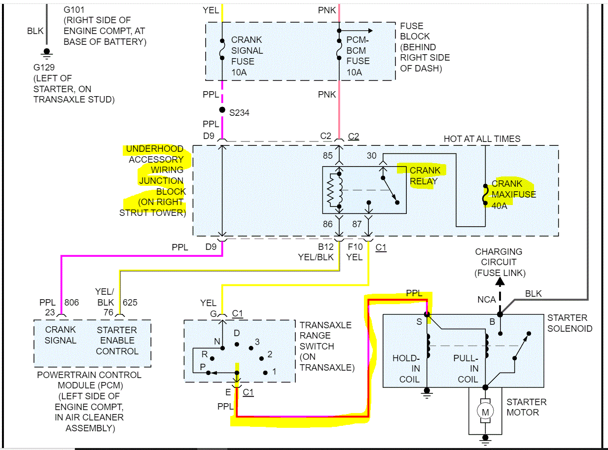

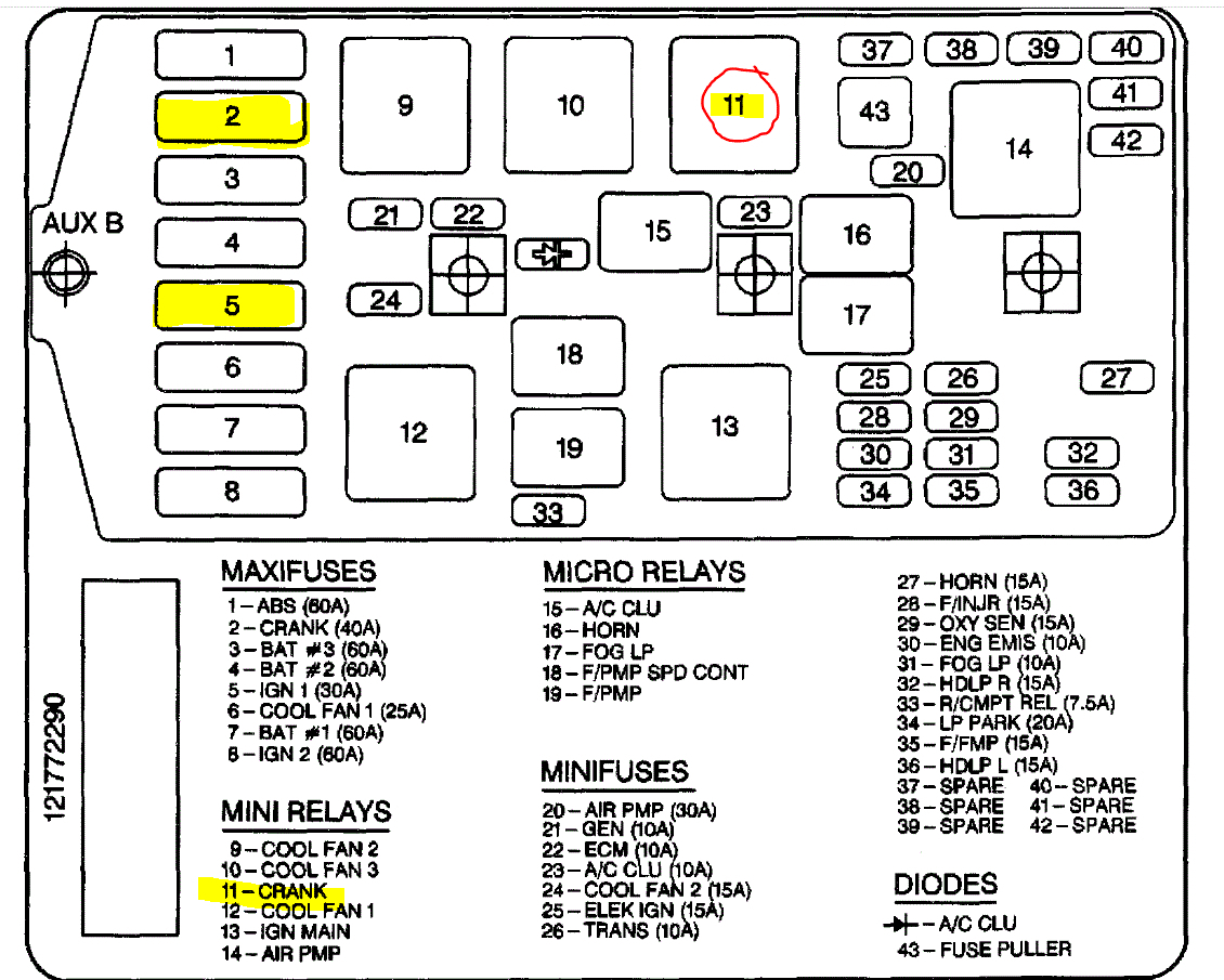

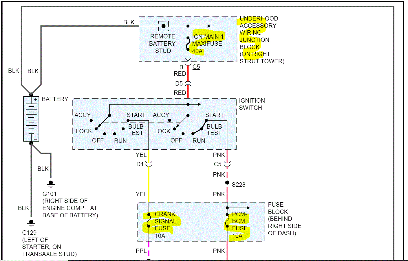

If that doesn't help, then we need to look at the wiring and power supplies. If you look below, I attached the wiring schematic for the starting circuit. Note there are several different fuses that are involved and a starter relay. Start by checking the fuses I highlighted. Note: In addition to checking the fuses, it is important to confirm there is power to and from them. Here is a link you may find helpful:
If the fuses all test good, then I need you to locate the starter relay. If there is a different relay in the box having the same part number, simply switch them to see if that changes things. If there isn't, here is a link that explains how to test a relay:
If the relay is good, then we need to check for power at the starter motor. If you notice in the schematic, there is a heavier gauge black wire that comes directly from the battery. That will always have 12v so be careful working around it. There will be a smaller gauge purple wire that goes to the S terminal on the starter. That wire will only have power when the key is in the start position and at no other time. Have a helper turn the key to the start position while you check for power to that wire.
If there is power, replace the starter motor. If there is no power, then we need to consider the switch. We will work through that as needed. Try these things first.

See pics below. Note: I had to cut the page in two, so it is readable for you. I did overlap them so you can follow from one to the next. Also, pic 3 shows what to check in the under-hood fuse box and pic 4 shows the interior fuse box.
