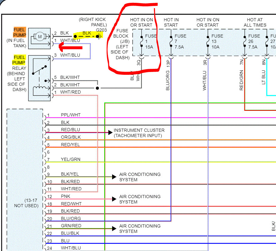

BNRBAILEY1
Starting having hesitation when going 40+ mph. Replaced fuel pump and filter but engine wouldn’t start. Have since replaced relays, fuel sending unit, vapor canister, distributor, plugs and wires. Getting spark and pump runs outside vehicle when power to it. I am stumped, what am I missing?

If the pump is good, then it's not getting power. See the attached pic. First, confirm fuse 1 is good and has power to it. Next, check power at relay pins 2 and 5 to confirm power to it. Last, make sure the ground is good to the pump.
Let me know what you find.

BNRBAILEY1
The fuse is fine but the relay female plug had no power on 2 and 5. What would cause this?

Trace the black and white wires back from the relay to the splice. I suspect that is where the issue will be. It could be loose or corroded.

BNRBAILEY1
The wires look fine, not loose or corroded. The truck ran okay and started fine before I changed the fuel pump. Is there something I may have messed up when changing it??

Honestly, if the wires are fine, we are losing power between fuse 1 and the relay. That should have power when the key is in the on position or run position. Is there power at fuse 1? If so, check to make sure there is power out from the fuse. You can use a test light for that process. Here is a link that explains how to do it if you need it. There is nothing between the fuse and relay, so chances are it is something simple you are just missing. It happens to the best of us. LOL
As far as installing the pump, you didn't do anything wrong. The problem is between the fuse and the relay. Exactly what is happening, I'm not sure. But, the idea that the fuse is good and providing power but not making it to the relay has me stumped. It has to be either a faulty fuse not allowing power through it or an open in the wiring.
Just for the heck of it, run a jumper wire between the battery + and the black and white wires that should be powering the relay. Does the pump run?
