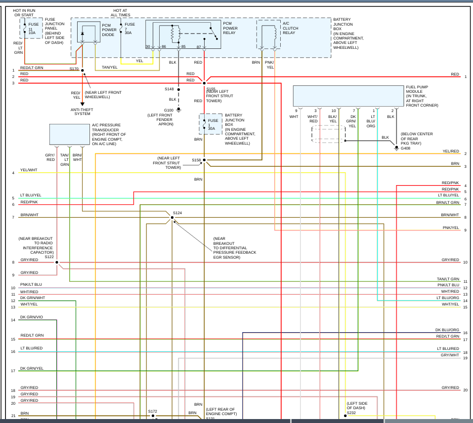

Will not start after removing battery for 48 hours.
Jan 23, 2020 at 4:36 AM
SCGRANTURISMO
  • 4,897 POSTS
When you turn the ignition key what exactly does your vehicle do? Nothing, click, sound like a machine going off, or? Please get back to me with the answer and we can go from there.
Thanks,
ALex
2CarPros
Jan 23, 2020 at 6:11 PM
PADAVE

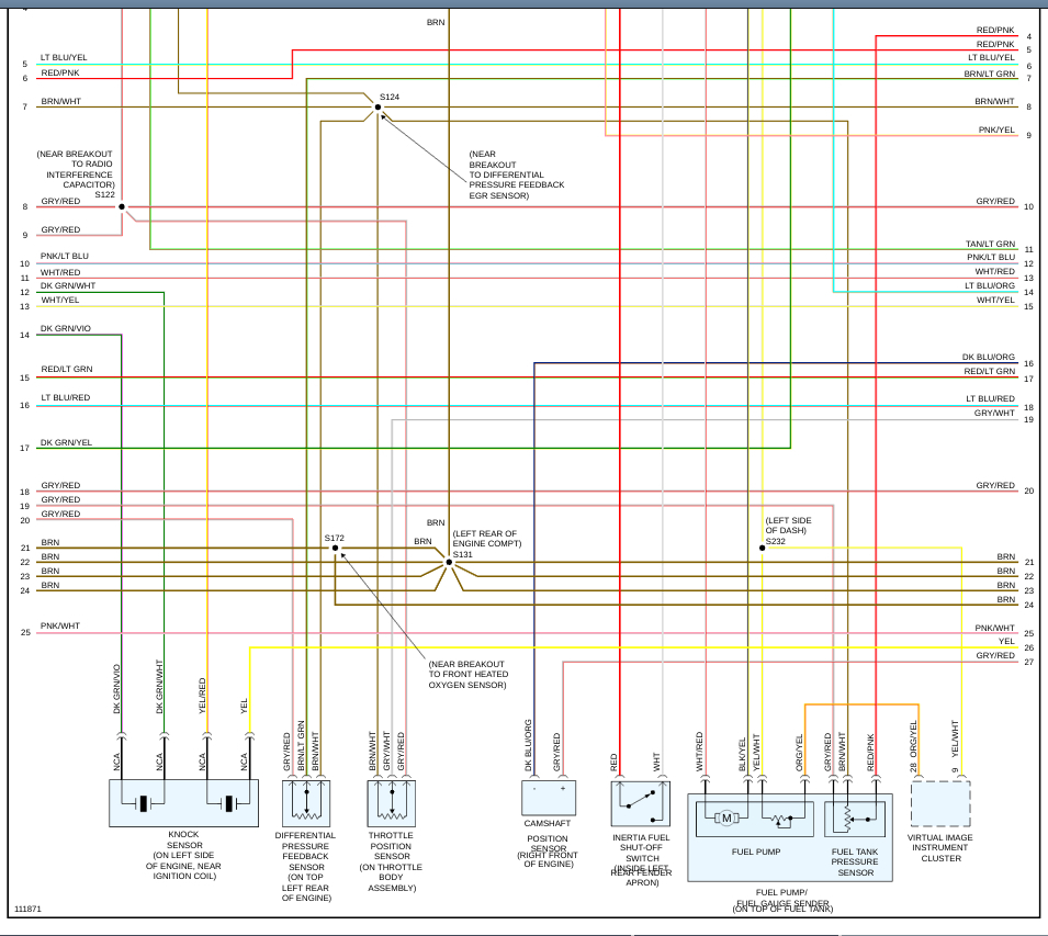

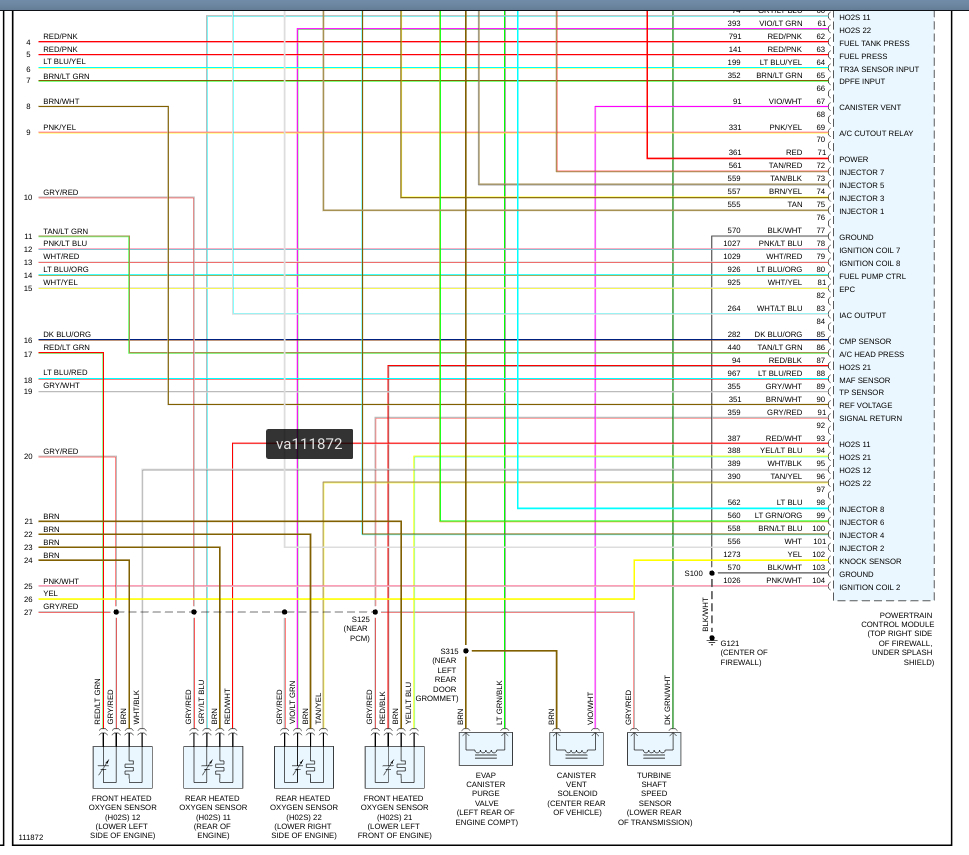

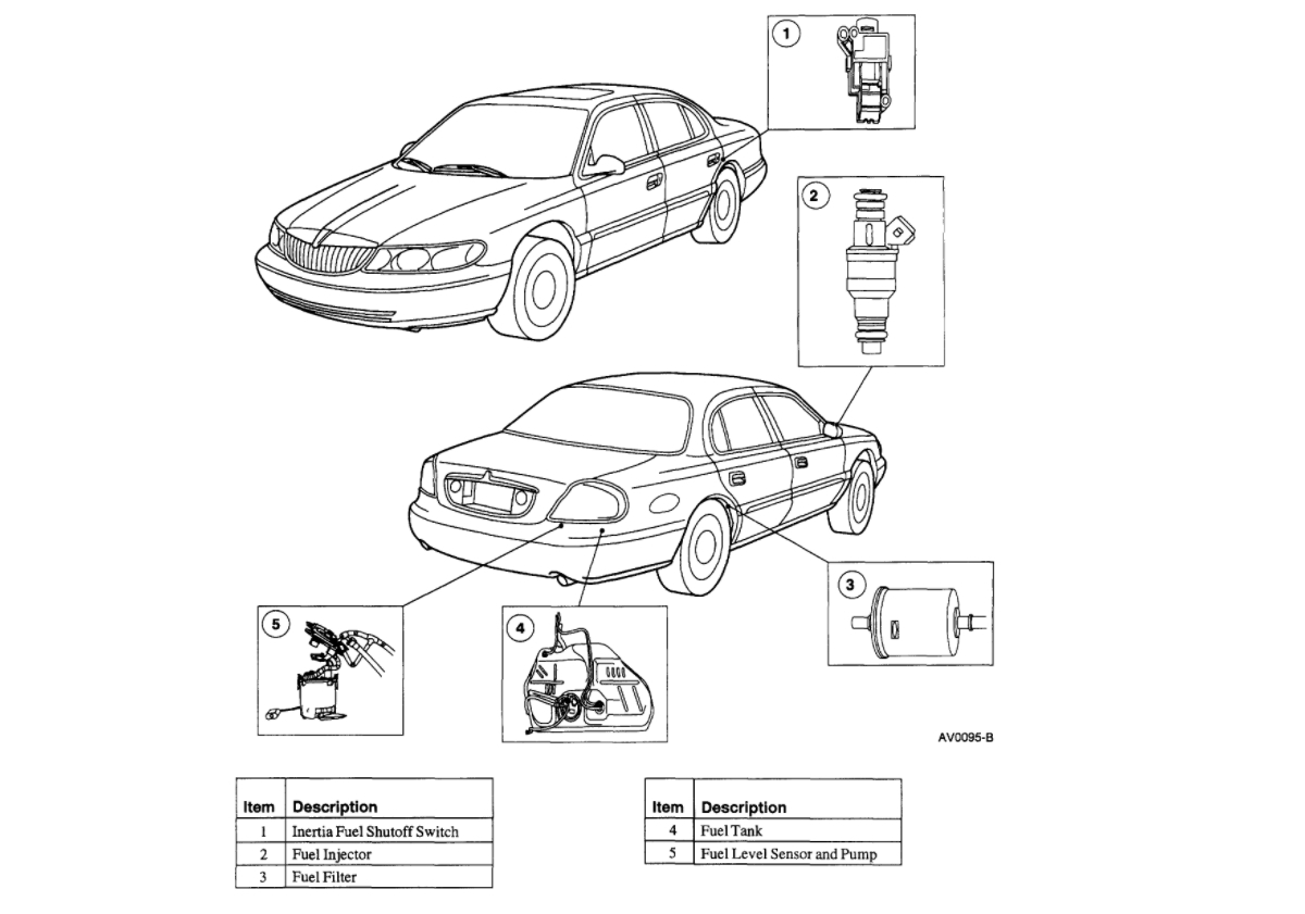

It cranks but no start. Checked valve on fuel rail and no presser.
Jan 23, 2020 at 11:26 PM
SCGRANTURISMO
  • 4,897 POSTS
Hello again,

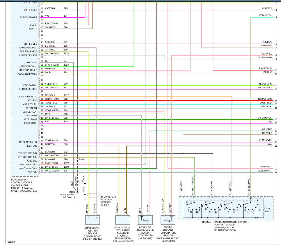

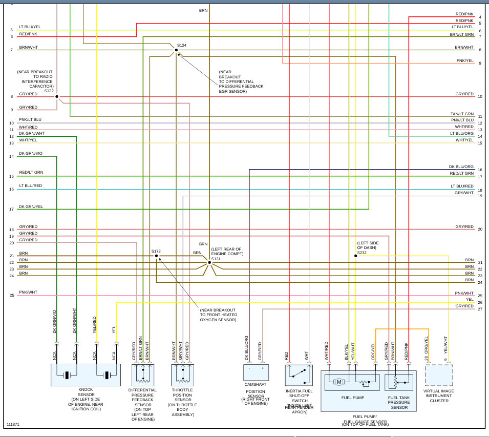

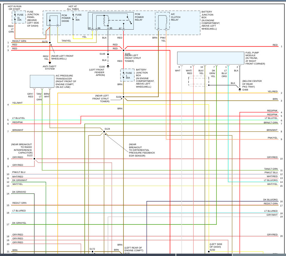

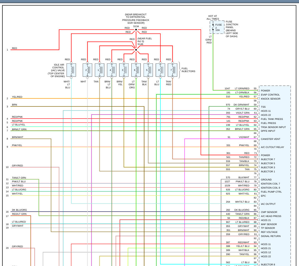

Okay, so first let's check the easy stuff. Can you please check your vehicle's inertia fuel shutoff switch and ensure that the red button is depressed down. I have included the wiring diagrams for your vehicle's engine management which includes the fuel pump circuit along with diagrams of the location of the inertia fuel shutoff switch. Please get back to us with what you find and we can go from there if needed.
