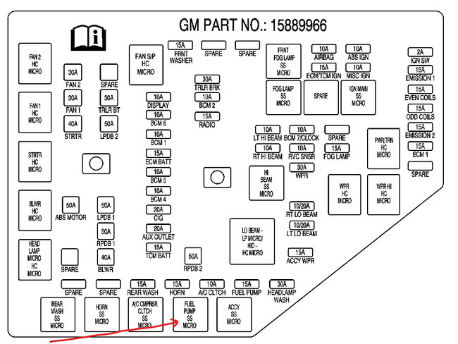

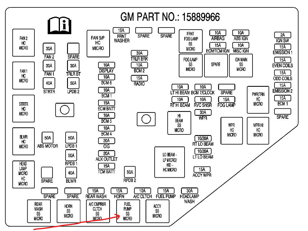

Driving then lost power. Waited about 10 minutes and it started up. Drove home parked and now won’t start.
Jul 17, 2023 at 11:14 PM
  • 55,456 POSTS

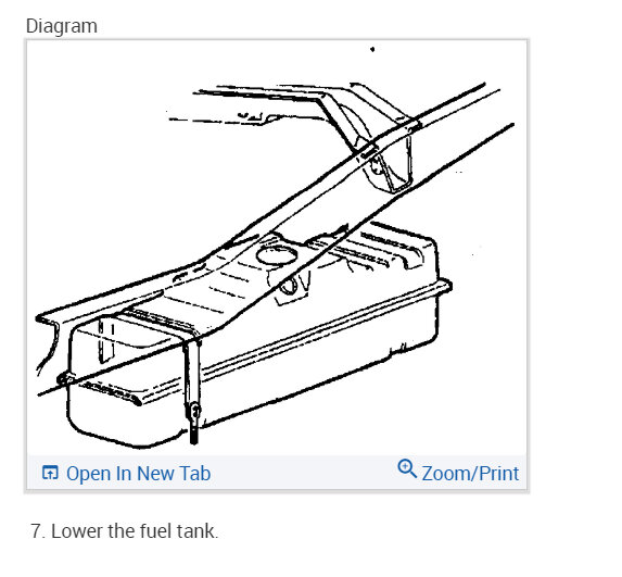

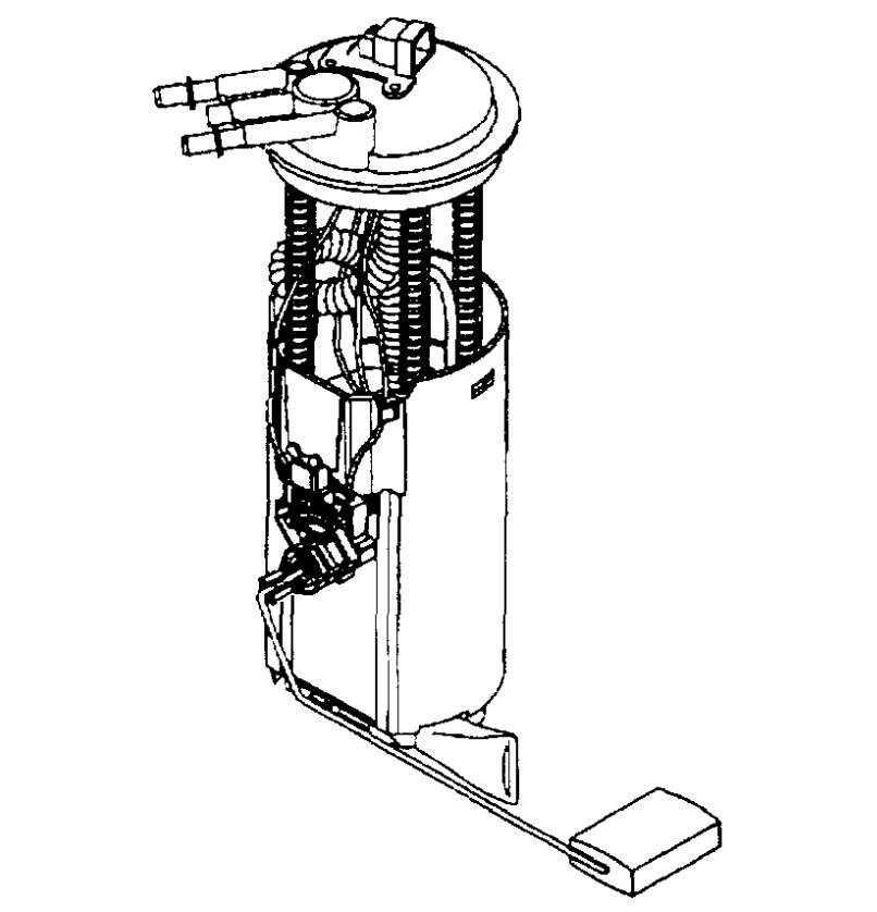

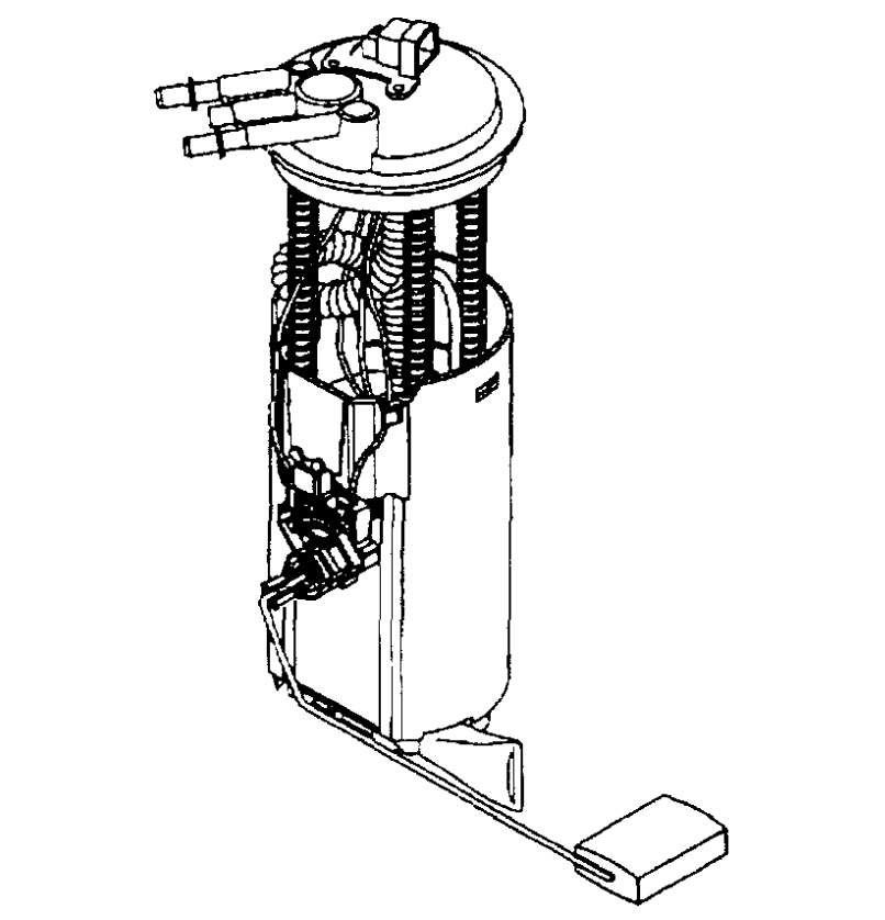

It sounds like the fuel pump has gone out, can you hear the pump running inside the tank if you turn the key on and don't crank the engine over? If not, chances are the fuel pump went out. Please go over this guide as well:
https://www.2carpros.com/articles/car-not-running-advanced

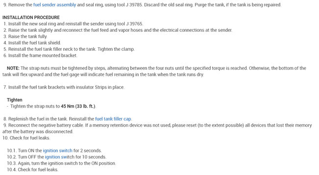

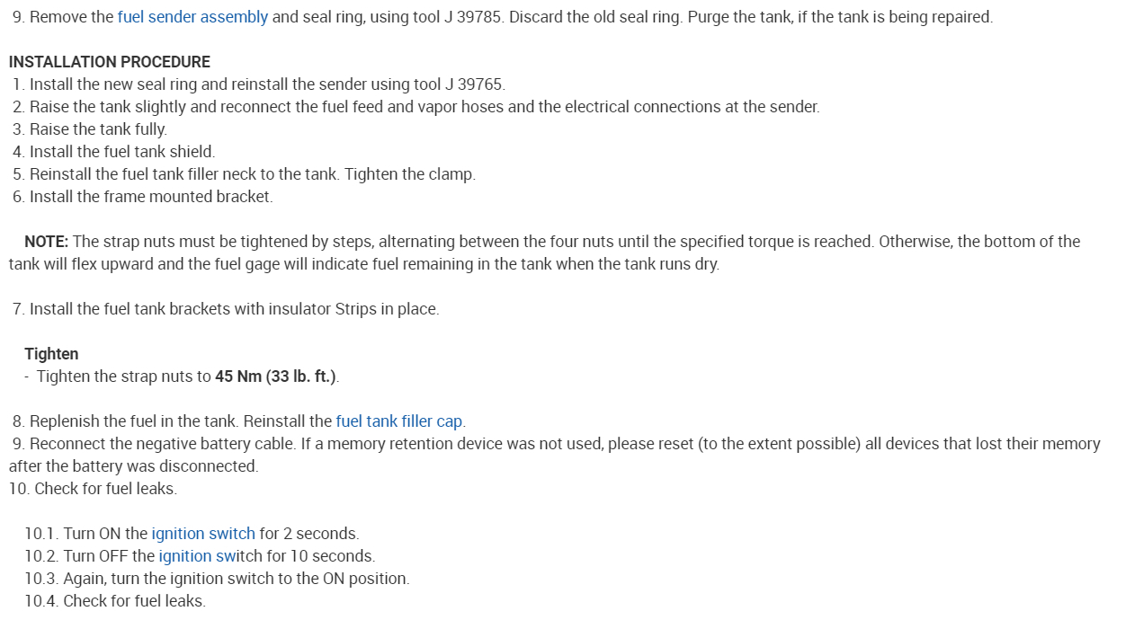

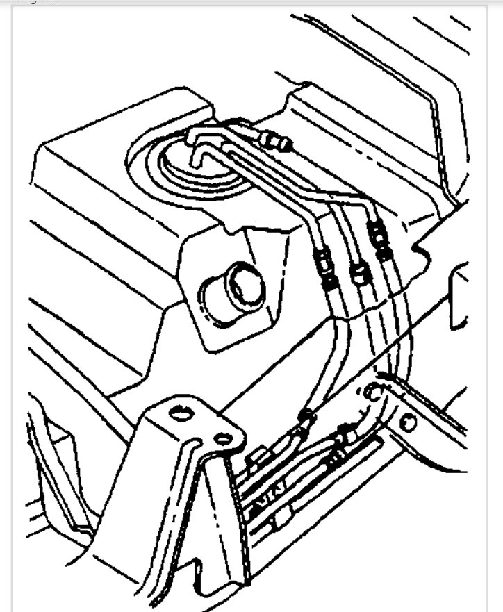

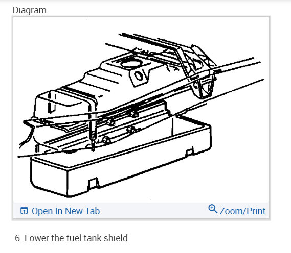

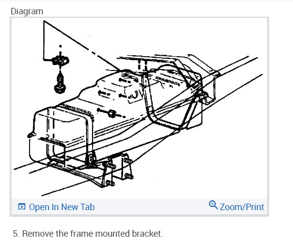

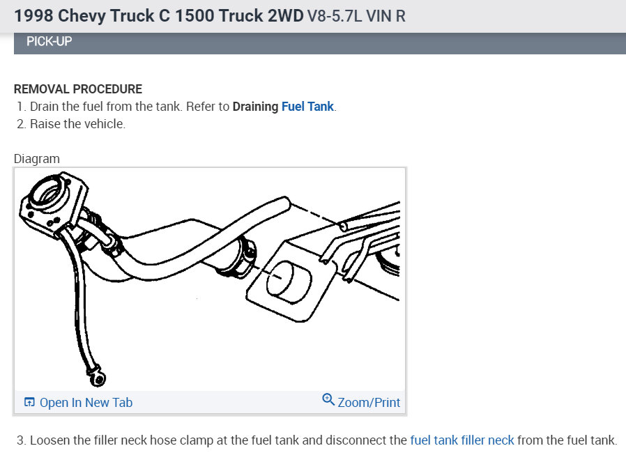

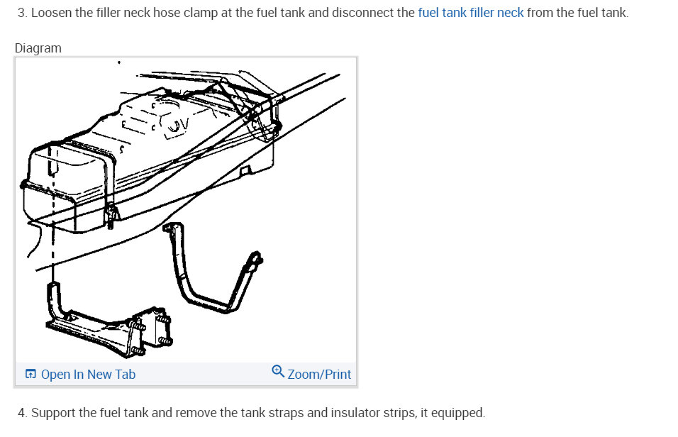

Here is how to change the fuel pump out in case you need it, I would swap out the fuel pump relay as well. It is located in the PCD under the hood. Check out the images (below). Let us know what happens and please upload pictures or videos of the problem so we can see what's going on.
