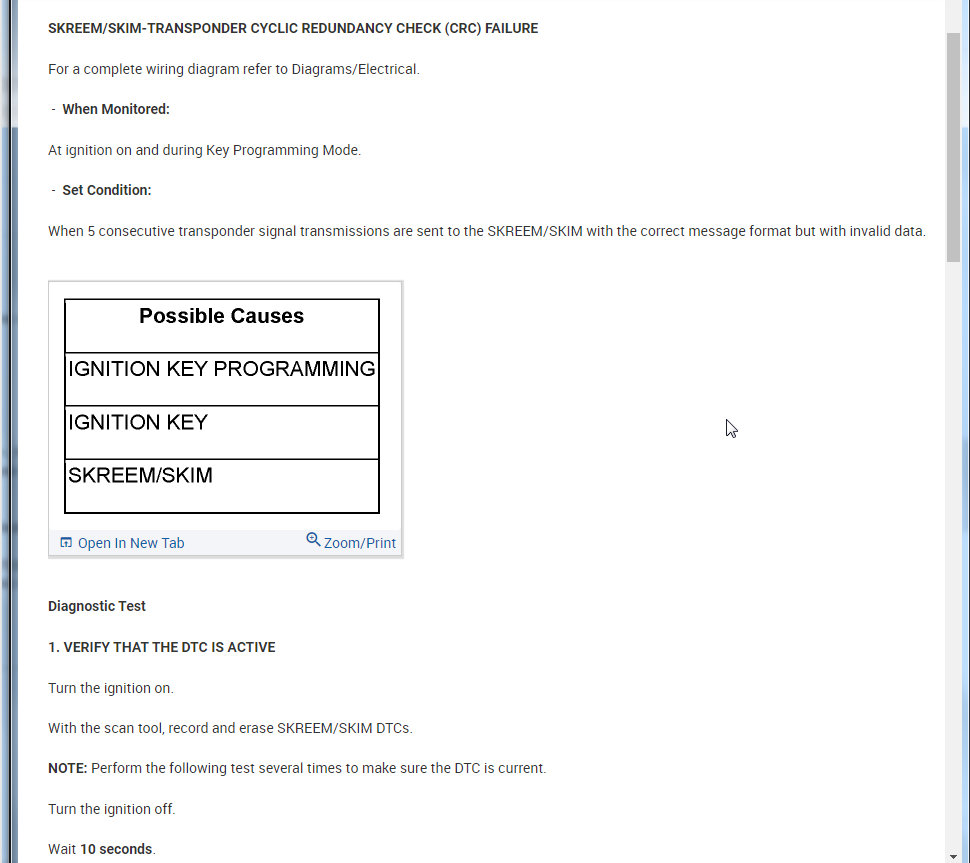

Invalid key or fob.
May 24, 2021 at 5:29 PM

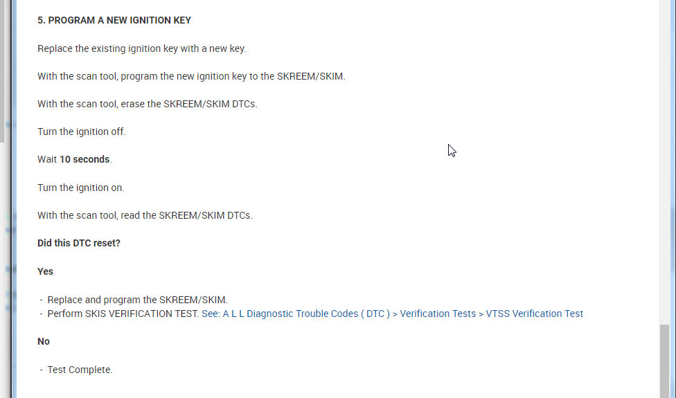

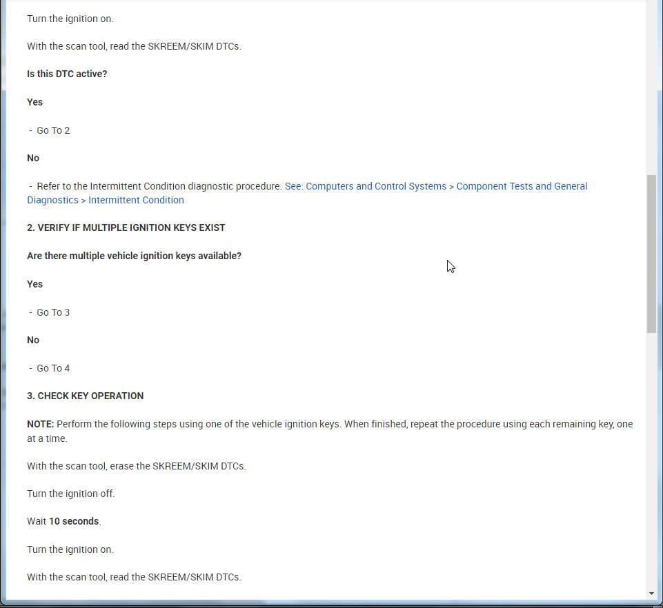

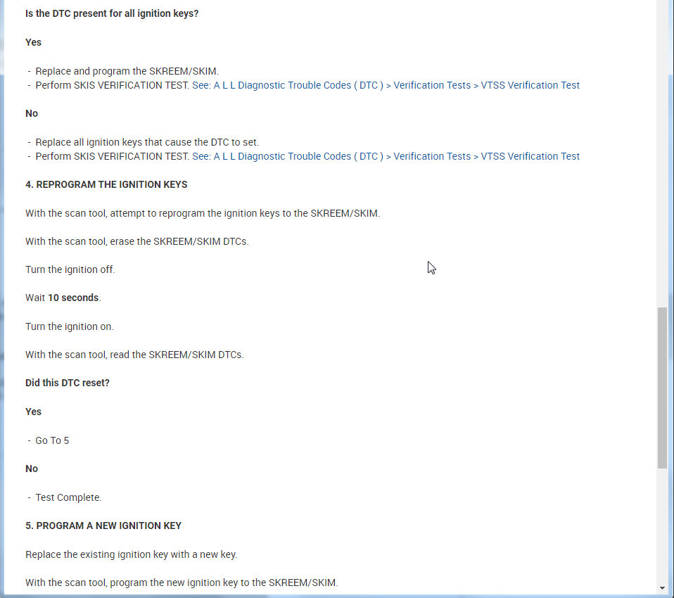

This issue is almost always due to a faulty key. However we need to start with running through this testing.
We need to run through it to determine if the key or the module is the issue.
The best way to try and tell is if you have another key. If you have a second key then that will tell us if the SKREEM module is operating.
Please let us know if you have questions or what you find with this.
