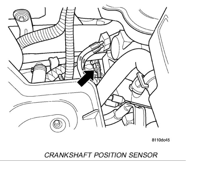

When I turn the ignition it will not start. The lights go on, doors unlock and lock, radio works and the ignition cranks. I had someone look at it and they said it looks like there is no spark to the plugs, no fire.

This sounds like a classic crankshaft angle sensor that has gone out. Here is a couple of guide to help you see what you are in for when doing the job and a diagram (below) that will show you what its like on your car.
and
