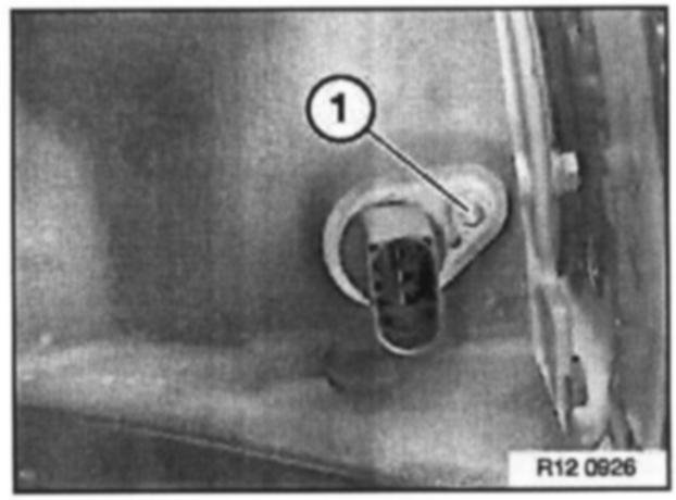

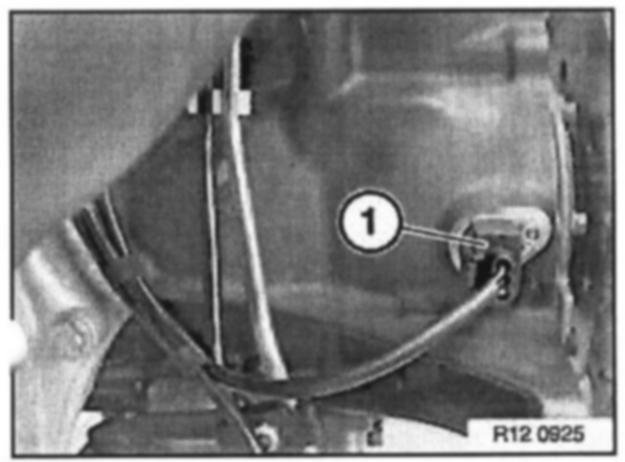

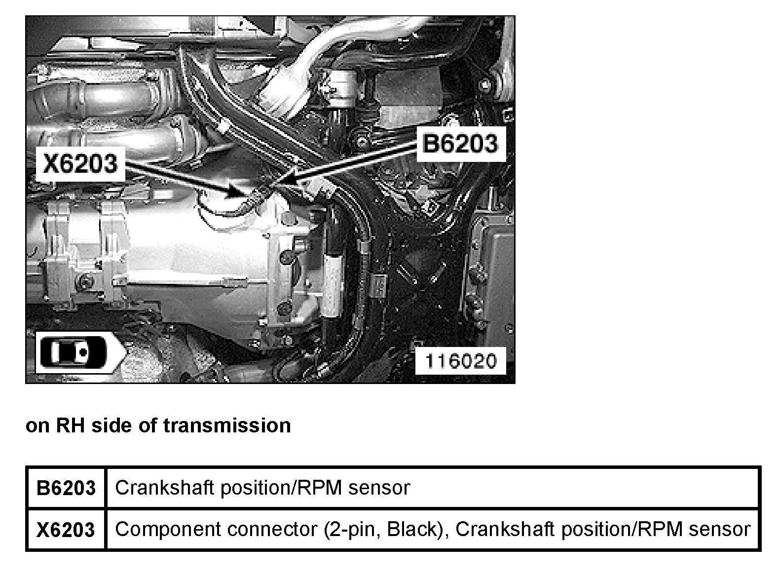

Car was over heating had to replace a bad heater inlet pipe under the intake manifold, but before that we tried the easy stuff; replaced water pump and thermostat and did a radiator flush. After getting all the new replacements on and now after the heater inlet pipe was replaced it does not want to start cranks fuel no spark. It ran before this I am just trying figure out what happened. :( Very desperate only vehicle I have.
Sep 20, 2018 at 4:16 PM
  • 110,248 POSTS

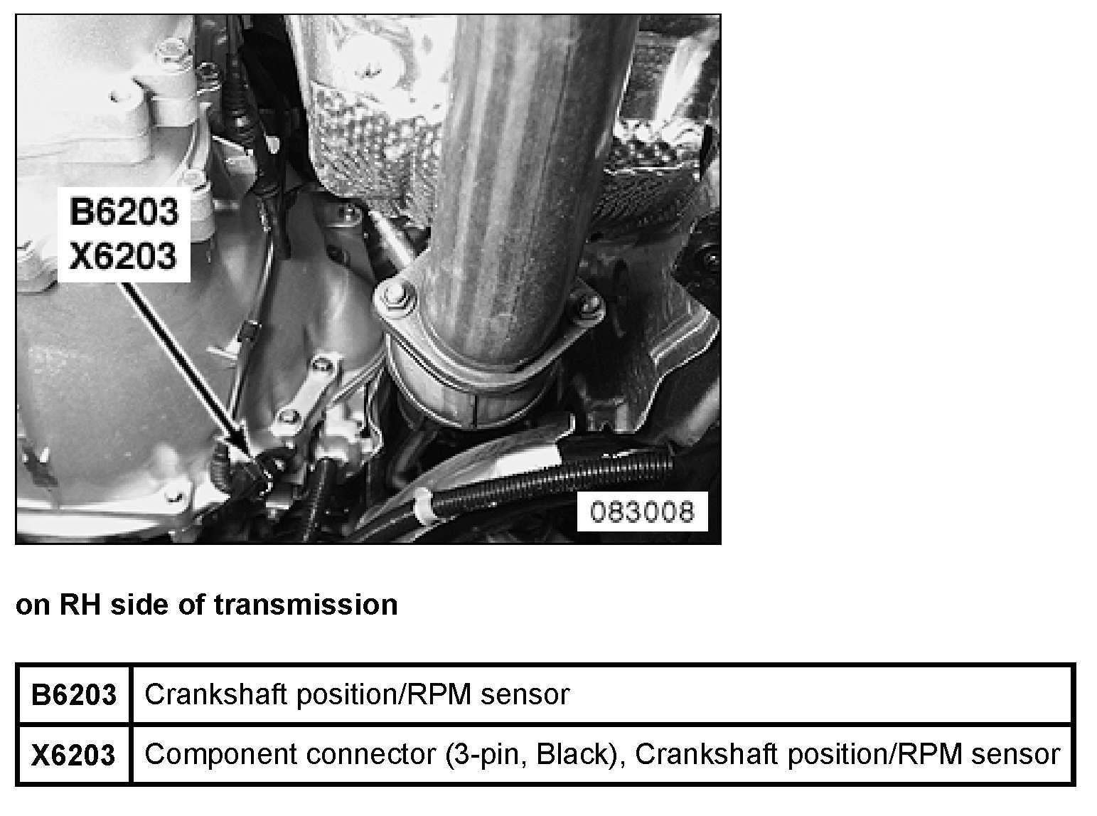

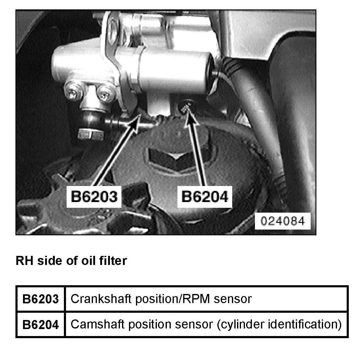

Since you were working on the engine, the first thing I need you to do is confirm the crankshaft position sensor is still connected. I have attached three different pictures. Each shows a possible location for your engine. Since you are getting fuel but no spark, this is my first suspect. The last two pictures show what the sensor looks like and it is most likely location (below the starter).
Note: If you have a live data scanner, check to see if there is an RPM/crank signal. If there is not my guess is the sensor is unplugged.
Sep 21, 2018 at 12:05 PM

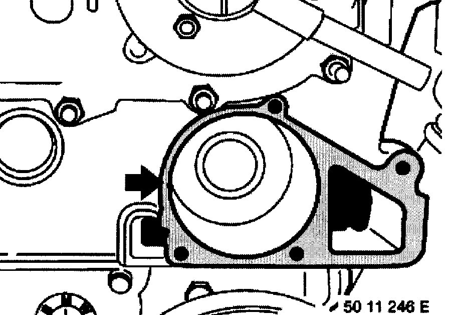

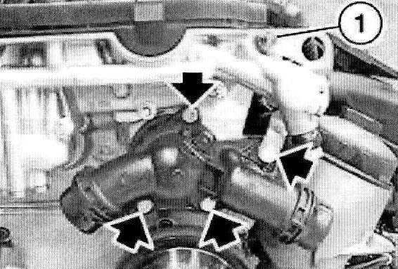

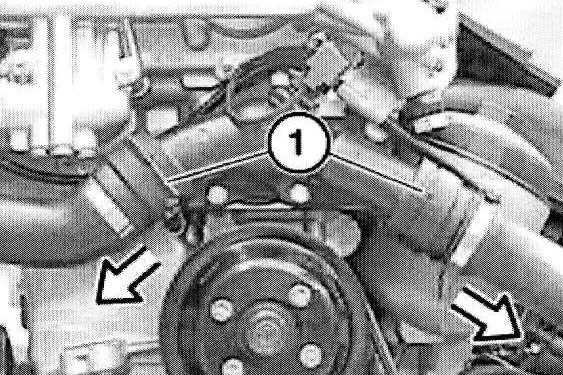

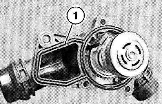

Okay so we got the intake manifold back on the car and had starting issues ended up being a 30 watt fuse under the hood inside ebox. So now it is running but still over heating. It has: new water pump, thermostat, heater inlet pipe line, and we have also done a radiator flush, and heater core flush. It sits at a idle forever normal temperature the moment you go around the block it is clear over the red hot marker. Running out of hope here.
Sep 22, 2018 at 4:39 PM
PATRICKWD79
I am in between a new $200.00 radiator or the thermostat I bought was a bad one. They say this happens often .
Sep 22, 2018 at 4:45 PM
  • 110,248 POSTS
Hi and welcome back.
It is possible to get a bad thermostat. However, when the engine is hot, are all the coolant hoses hot too?
If you want to check the thermostat, remove it from the vehicle. Boil water and drop the thermostat into the boiling water. You should see it open. If it does not open or open fully, it is bad.
Also, a bad radiator cap can cause an engine to overheat. The boiling point of coolant, water increases when its under pressure. Check that too.
Chances are you do not need this, but here are the directions for replacing the thermostat just in case. The pictures attached correlate with these directions.

REMOVING AND INSTALLING/REPLACING COOLANT THERMOSTAT
Remove fan clutch with fan impeller and fan cowl, refer to Fan Clutch, Service and Repair.
Drain and dispose of coolant. See: Coolant > Procedures
Note: The water drain plug is located on the exhaust side on cylinder 2 in the engine block.
Installation:
Replace sealing ring of water drain plug.
Tightening torque, refer to Specifications, Mechanical.
Vent cooling system and check for leaks, refer to Cooling System, Service and Repair. Pull locks and disconnect water hoses.
Installation:
Refer to general instructions for work on cooling system, refer to Cooling System, Service and Repair.
Loosen nut (1).
Release screws on thermostat housing, remove thermostat housing.
Installation:
Keep sealing faces clean and free of oil.
Note: Coolant thermostat is integrated in coolant thermostat housing and can only be replaced as a single unit.
Installation:
Replace gasket (1).
