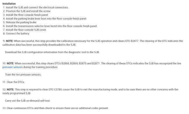

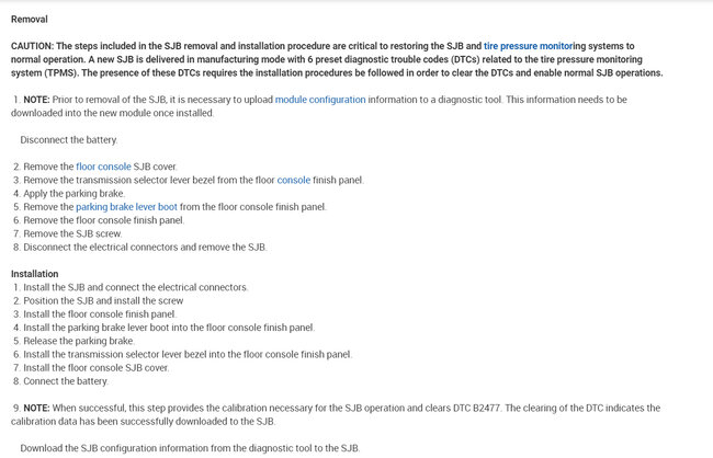

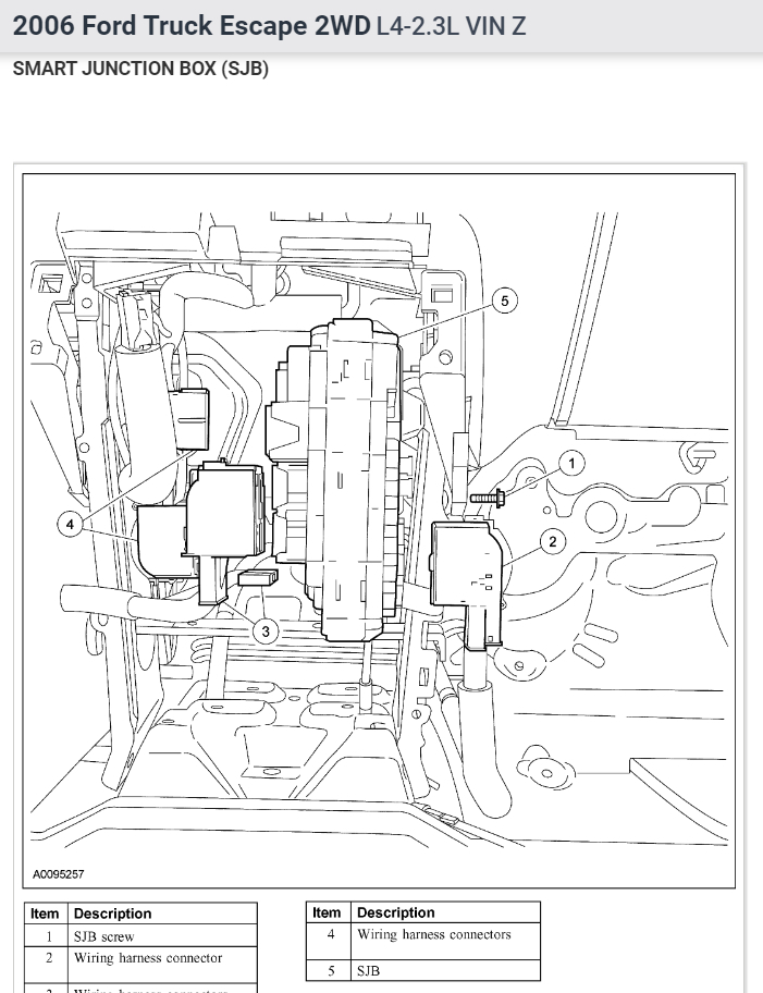

It's like it knows you are getting rid of it, lol just kidding, this happens when the SJB goes out but to be sure we should do a CAN scan. You can get a CAN scanner (Controller Area Network) which will work on most cars from Amazon.
https://youtu.be/u-4syLc-ifQ
You can get a preprogrammed unit by searching Google or Ebay. Check out the images (below). Please let us know what happens.
