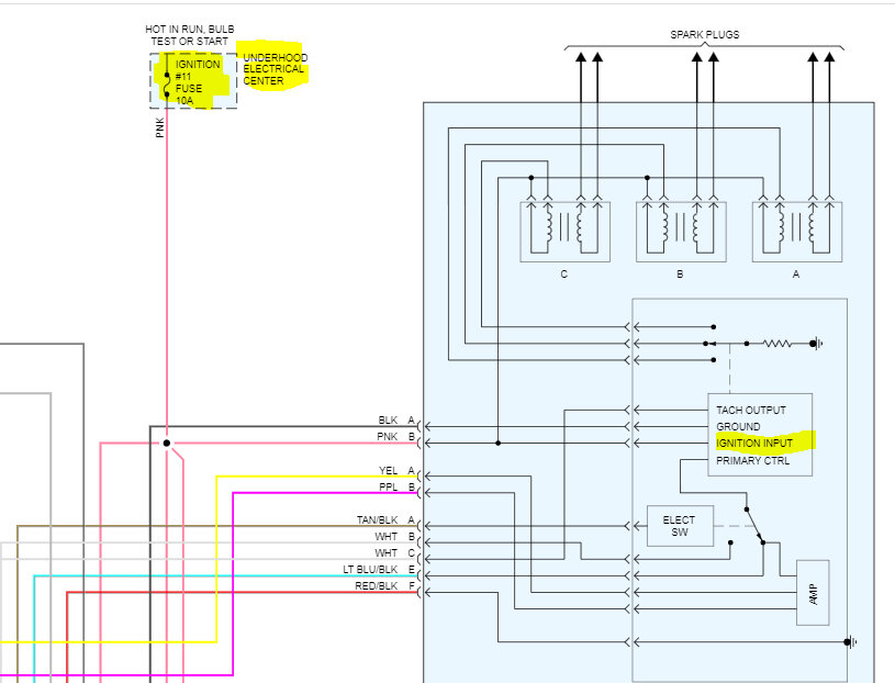

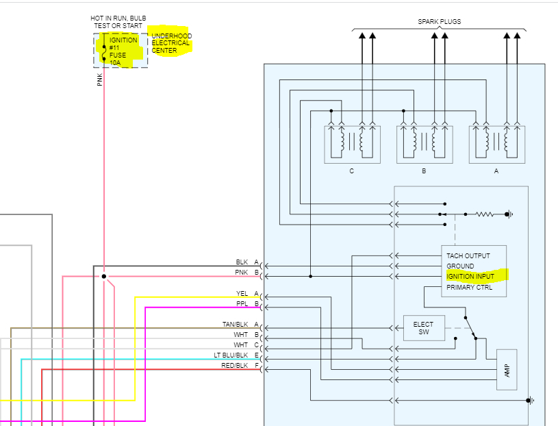

On the left side of engine i have a single white or grey wire, I do not know where it goes. i also have a female plug sort of heart shaped the wires appear to be black, red, blue, black. I do not have power from ignition to coil pack.
Oct 22, 2022 at 8:50 AM
  • 110,240 POSTS
As far as the wires are concerned, it's like looking for a needle in a haystack. LOL If possible, upload a pic of the connector for me to see. I may recognize it.
As far as the coils, have you checked the ignition 11 fuse in the under-hood fuse box? If not, do that first. In addition to checking the fuse, confirm there is power to and from it.
I attached a pic of the coils and fuse in a schematic, so you have a reference. If the fuse is good, go to the coil and locate the pink wire and check there for power. Note: The key needs to be on for the fuse to have power.
Let me know what you find.
See pic below.
