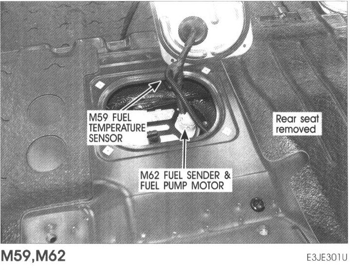

We need to check a couple things before we dig in. First, make sure the connection is at the fuel pump is in good condition and not damaged, loose, or corroded. I attached a picture for you to see its location.
If that checks good, see if there is power to the pump. Here are directions for using a test light:
For wire testing:
Next, confirm there is spark for sure. Here are the directions.
If there is power to the fuel pump and you have good spark, you need to confirm the fuel pump pressure is within the manufacturer's specs. Here is a link showing how that is done:
Here are fuel pressure directions specific to your vehicle: Pictures 2, 3, 4 correlate with these directions.

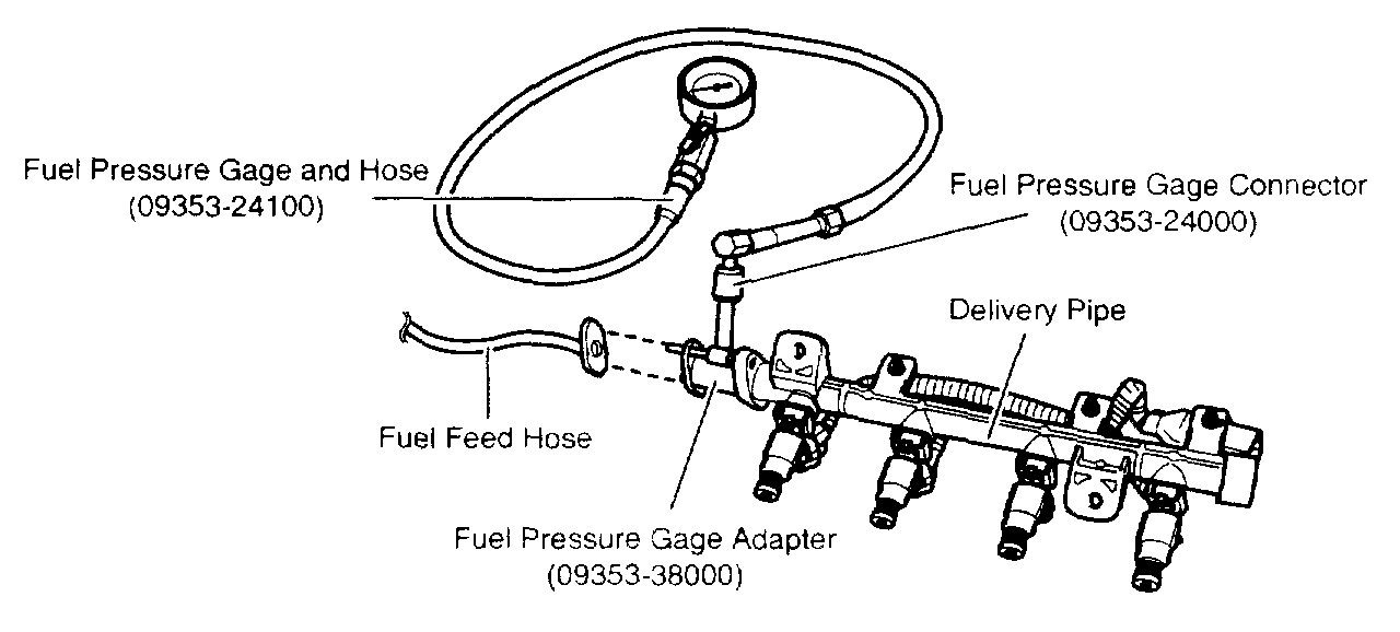

Fuel Pressure Special Service Tool
3. INSTALL THE SPECIAL SERVICE TOOL (SST) FOR MEASURING THE FUEL PRESSURE
1. Disconnect the fuel feed hose from the delivery pipe.
Caution: Cover the hose connection with a shop towel to prevent splashing of fuel caused by residual pressure in the fuel line.
2. Install the Fuel Pressure Gage Adapter (09353-38000) between the delivery pipe and the fuel feed hose.
3. Connect the Fuel Pressure Gage Connector (09353-24000) to the Fuel Pressure Gage Adapter (09353-38000).
4. Connect the Fuel Pressure Gage and Hose (09353 41 00) to Fuel Pressure Gage Connector (09353-24000).
5. Connect the fuel feed hose to the Fuel Pressure Gage Adapter (09353-38000).

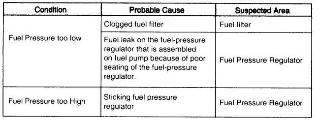

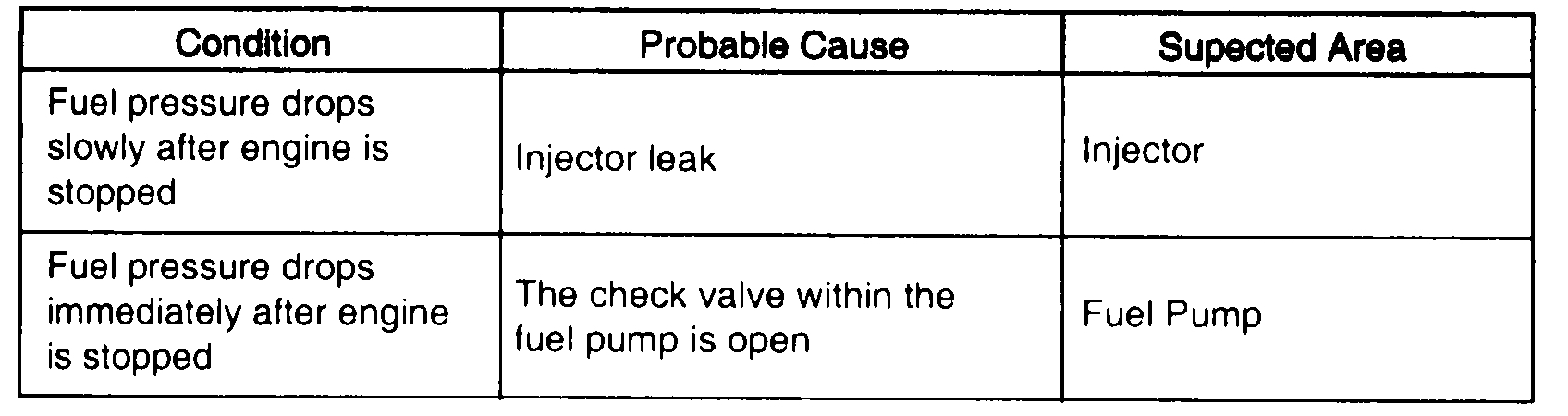

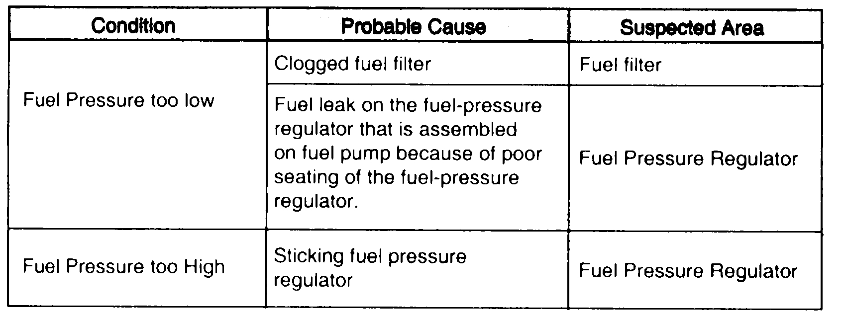

Incorrect Pressure
If the measured fuel pressure differs from the standard value, perform the necessary repairs using the table below.
Pressure Drops
5. Stop the engine and check for a change in the fuel pressure gauge reading.
After engine stops, the gage reading should hold for about 5 minutes
Observing the declination of the fuel pressure when the gage reading drops and perform the necessary repairs using the table below.

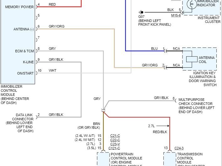

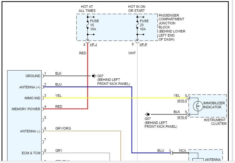

Found no spark. Does this version of the Santa Fe have an immobilizer?
Monday, September 17th, 2018 AT 11:08 AM
  • 109,867 POSTS
Hi again:

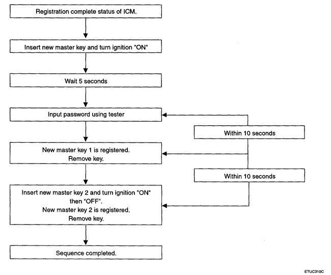

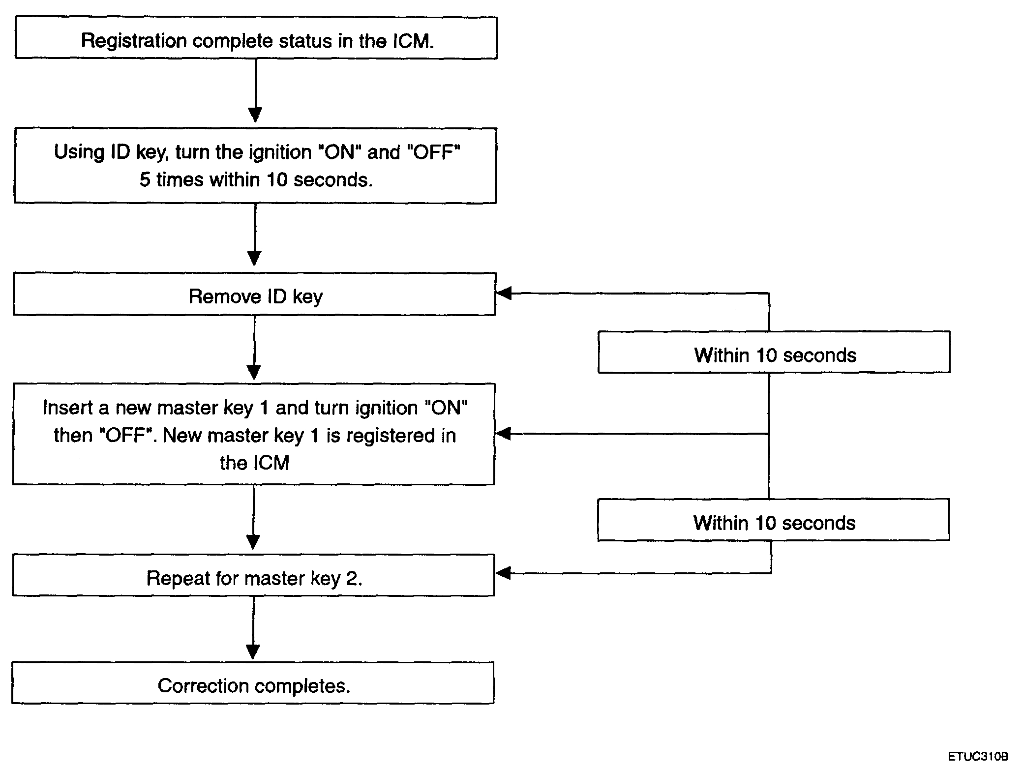

It does. I attached a wiring schematic of the system. Also, here are the relearn directions for the key and password.

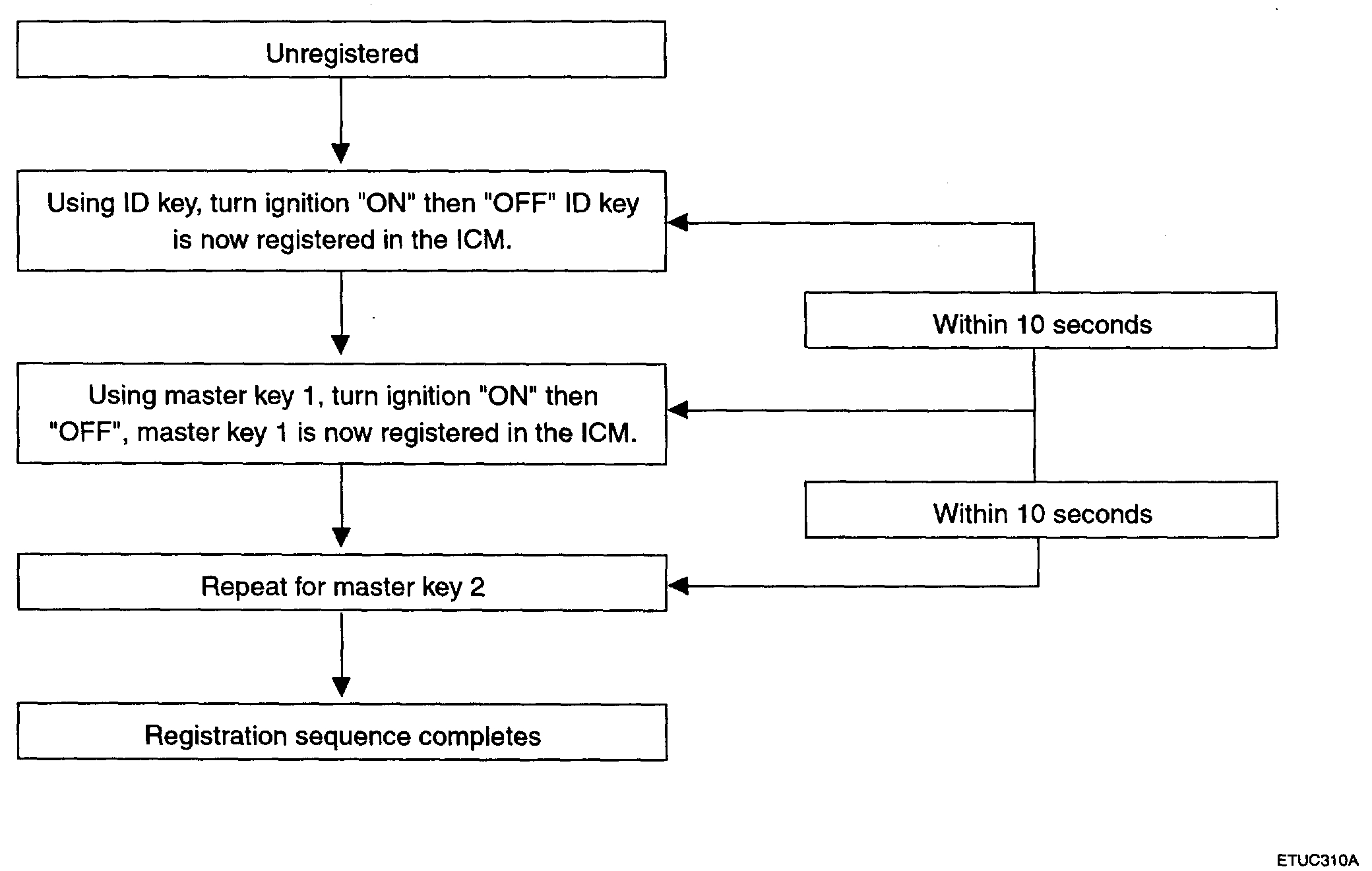

Key registration and correction. See pictures 1, 2, 3 which correlate with these directions:
KEY REGISTRATION AND CORRECTION
1. INITIAL REGISTRATION METHOD
2. REGISTRATION CORRECTION FOR MASTER KEYS
In cases when the master key is lost or where a new set of master keys need to be produced, it can be achieved using two methods.
1. Using ID key
2. Using password
When the customers lost the ID key, new master keys can be registered by using Hi-scan only. ID key can not be corrected and reproduced.
NOTE: Once the password is mis-registered, it is impossible to register new password during 10 seconds regardless of ignition ON/OFF.
When the new master keys have been registered, the codes for existing master keys are all cleared.
The password should consist of 4 numbers among ten (0-9) numbers
__________________________________________________
Pictures 4 and 5 are the wiring schematic for the immobilizer.
I hope this helps.

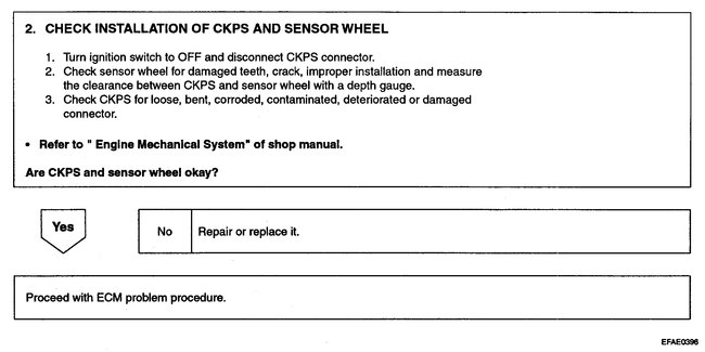

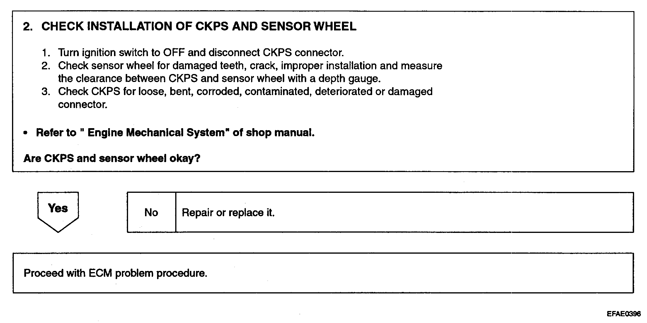

So I called up Hyundai and he told me to check the crank shaft positioning sensor when I checked it all the insulation was burned off the wire. So, I am going to try that $20.00 fix. First I will check the immobilizer.
Wednesday, September 19th, 2018 AT 4:43 AM
  • 109,867 POSTS
Hi again.
If the crankshaft position sensor is bad, you will not get spark. I missed that you mentioned it later because the first post said it had spark. In my mind, we still had spark. Sorry.

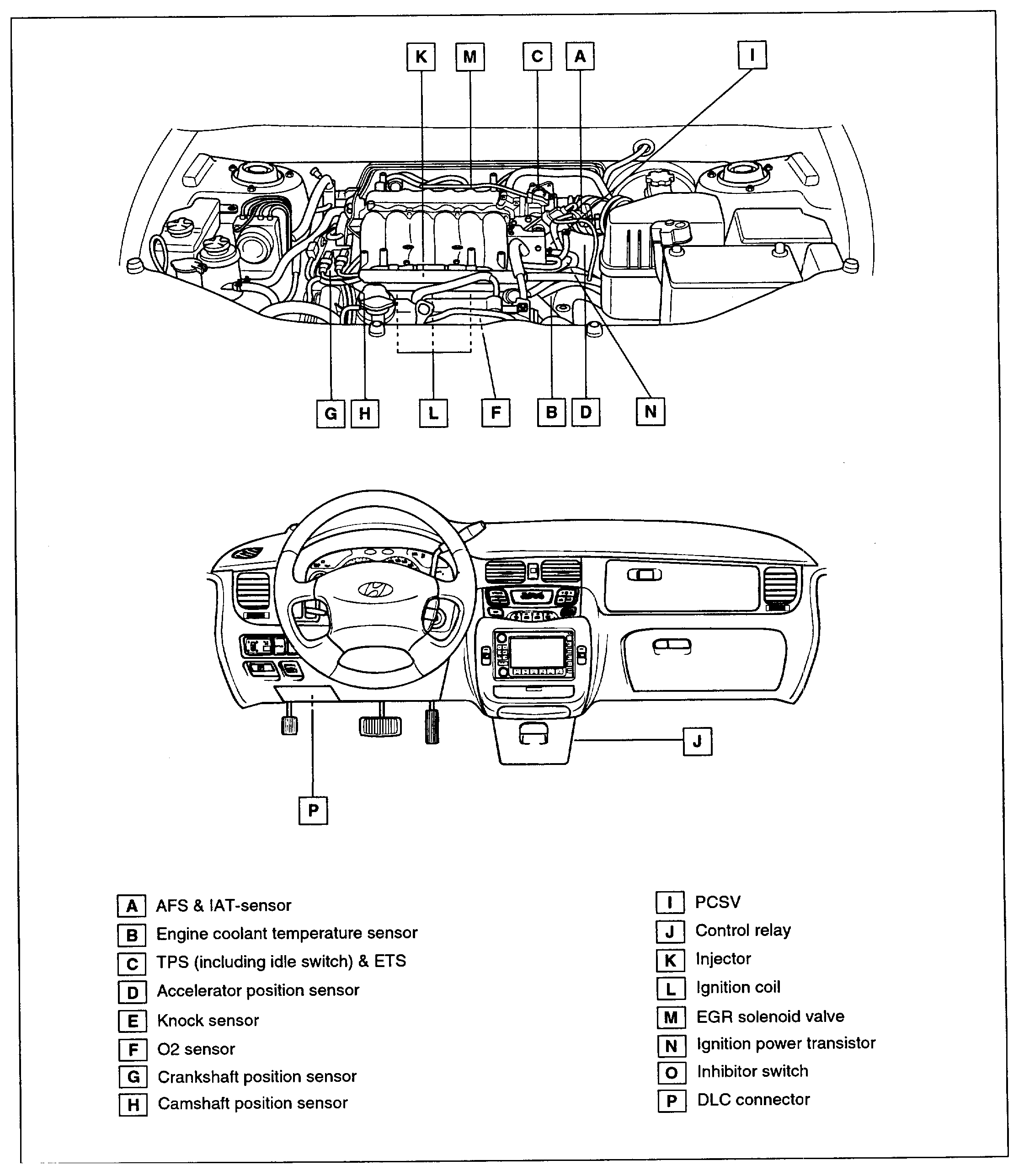

Okay, so I got the crank shaft position sensor fairly cheap. I find out where it is online it is a tight fit I get to eat all the wires are exposed I go to pull it out it breaks off in my hand. Took me days to just pull the rest of the sensor out. Finally get it out I have a tough time putting it in but once it's in the car turned over and started. Now I have another problem. Driving everything was fine all of a sudden the engine sputters a little now the car will not go over 3000 RPM's without a little bucking and loss of power. I have to drive manually shifting. This happened before but always cleared up now it's doing it constantly. It will literally not go over 3000 RPM's as per the tachometer. There is literally no passing gear if I try to punch it to pass someone and it goes over 3000 RPM's it shtus off keeps running I just have to slow down under 3000 RPMs. On top of that one of the hoses for the transmission cooler came off again and lost all my transmission fluid again.
Sunday, September 30th, 2018 AT 10:29 AM
  • 109,867 POSTS
Hi again. To be honest, that sounds like a camshaft position sensor issue. There are two of them on your vehicle. See attached picture. However, I wouldn't arbitrarily replace them until you are sure there is an issue. Has the check engine light come on when this happens?

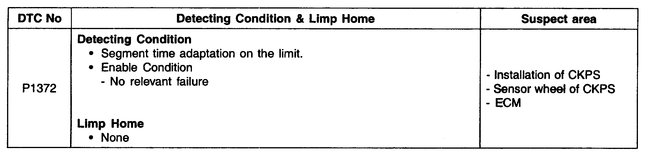

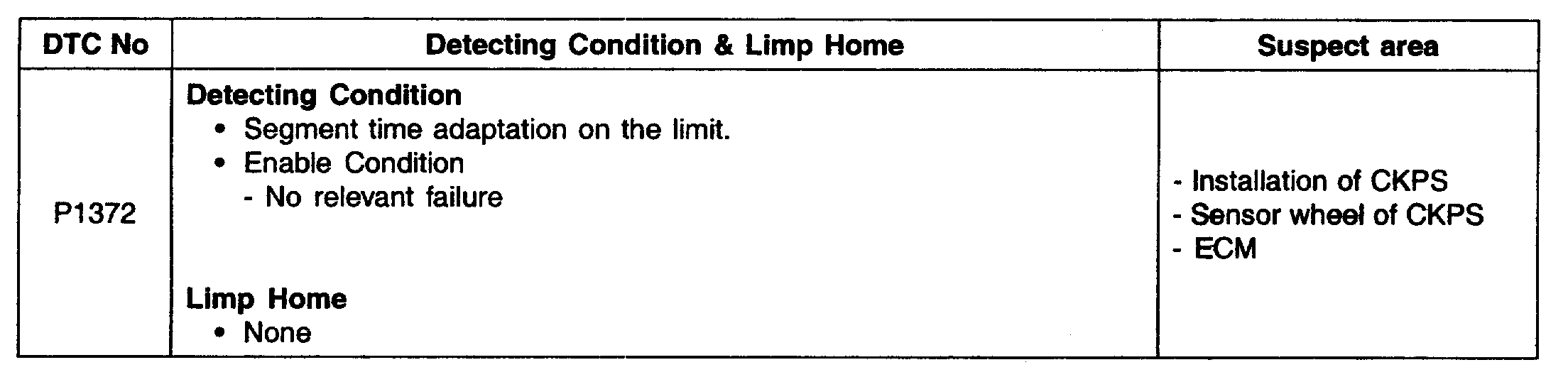

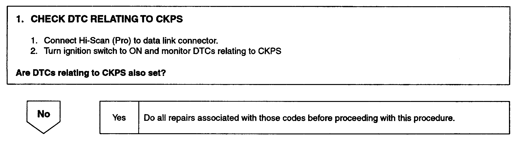

Okay, so I had to codes read one is a Hyundai specific code p1372 segment time incorrect the other code was P0335 crankshaft positioning sensor A. You said there were two sensors on the car I changed one. The one I changed his right above the starter in the engine block. Did I not put it in correctly or is it just a bad sensor? I bought it for $12.00 on Amazon. Any suggestions. They say if iti s not in all the way it will not read correctly.
Tuesday, October 2nd, 2018 AT 2:41 PM
  • 109,867 POSTS
Hi again. I read back through the posts. The sensors I am referring to are the camshaft position sensors. The one you replaced was the crankshaft position sensor. The 1372 indicates an issue with the crank sensor (the one you replaced). Either the sensor is not seated correctly or there is a wiring issue at the sensor. I have attached three flow charts that describe how to check the sensor.
DTC P1372 Segment Time Acquisition Incorrect
DESCRIPTION
Misfire induces a decrease of the engine speed and causes a variation in the segment period. Therefore misfiring detection is based on the observation of this variation of segment period.
