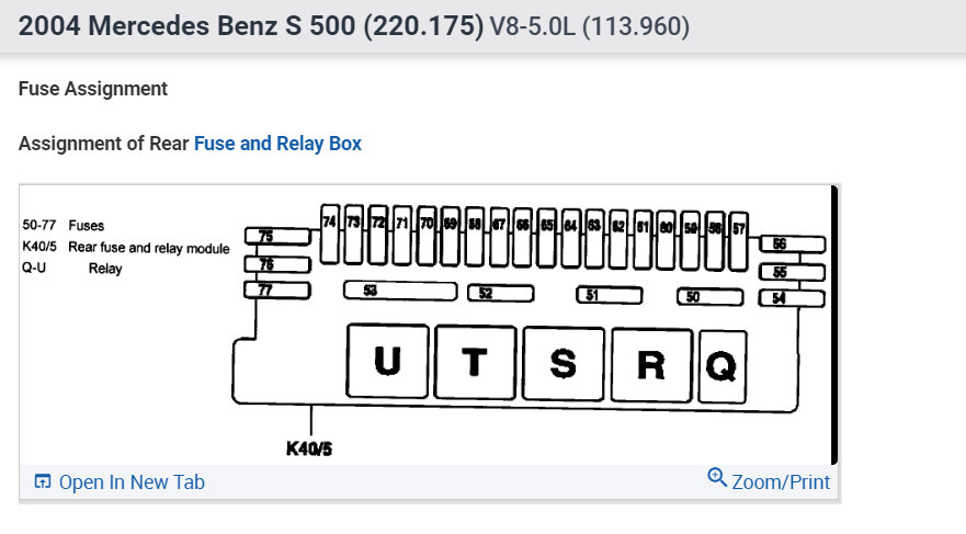

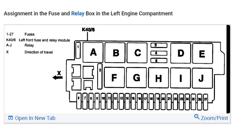

I've changed the ignition switch and got a new key. The previous keys and switch stopped working. the key fob turns, and dashboard lights up, but the car won't start. I replaced the battery and still car won't start, it doesn't even crank over. the ESP light is on and stabilizer light I believe it's parentheses with a I in the middle that stays on. I also replaced the starter also the steering wheel doesn't lock. I've always had an issue with the ESP but if I pressed it a number of times the car would start, I haven't been able to start it for a year now.

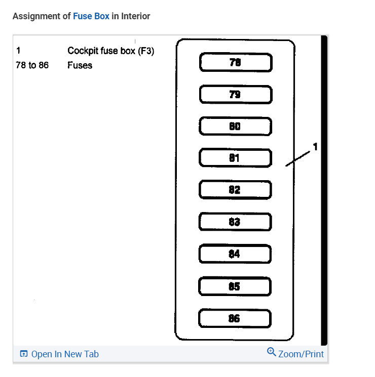

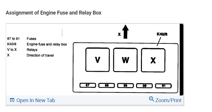

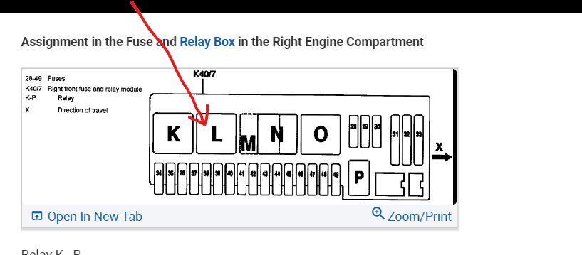

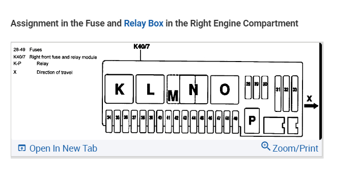

The first thing I would like you to check all fuses with the system on, here is a guide and the fuse locations in the images below:
If all fuses are okay let's run a CAN scan on the car. You can get a CAN scanner (Controller Area Network) from Amazon.

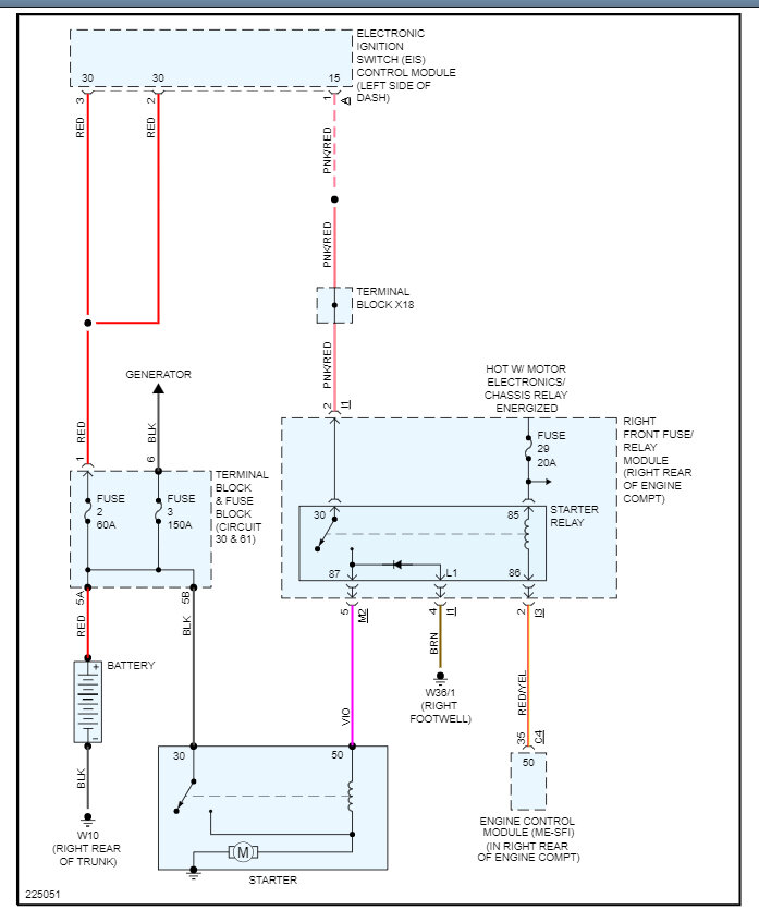

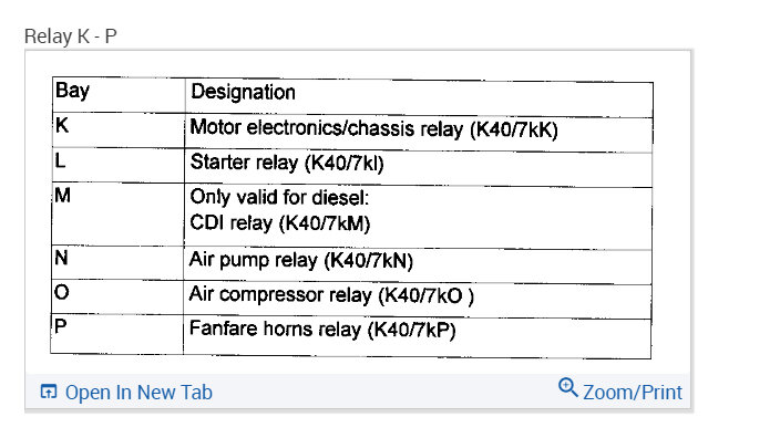

Also, I would like to try a starter relay here is a wiring diagram of the starter circuit so you can see how the system works. Check out the images (below). Please let us know what happens.
