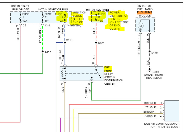

I was driving while not paying attention to my gas gauge and I ran out of gas. My car would not start after that, and I replaced the fuel pump. I have tested all my fuses and relays. Any idea what my problem could be?? Please get back to me ASAP. Thank you!
Jun 12, 2023 at 2:30 PM
  • 110,240 POSTS
Do you hear the fuel pump prime when you first turn the key on? There are two different fuses required for the pump to run. Did you check both? (See pic below)

See pic below.

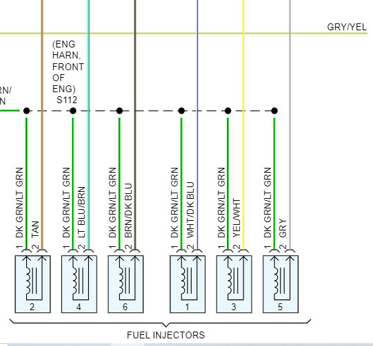

If the pressure is good, I need you to check for power at the fuel injectors. Each injector will have two wires going to it. One of the wires on each injector will be a dark green wire with a light green tracer. With the key in the run position, check that wire on any of the injectors for power. (See pic below)
If you have power, let me know. At that point, we will need to see if the PCM is providing a ground path for the fuel injectors.
Let me know what you find.
See pic below.
