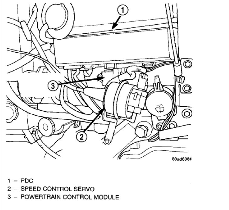

2000 Dodge Intrepid, V6, 2.7L, DOHC 24V. Cranks when tried to start. Sounds like fuel pump is running. Did the cycled key on off on off on and got code P1684 on the odometer. Trying to find out what needs to be done. Thanks in advance.

This code is because the power inside the PCM got interrupted when this has happened in the past we replace the computer and it fixes the problem. Here is the location under the hood you will need to have it programmed.
