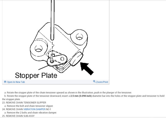

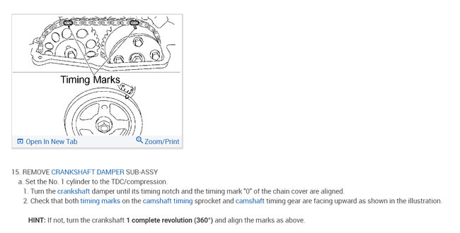

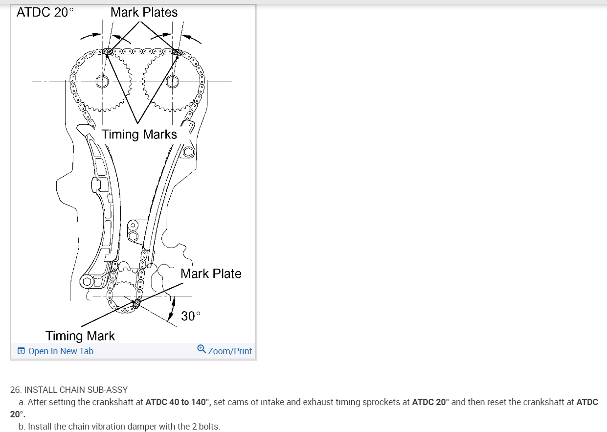

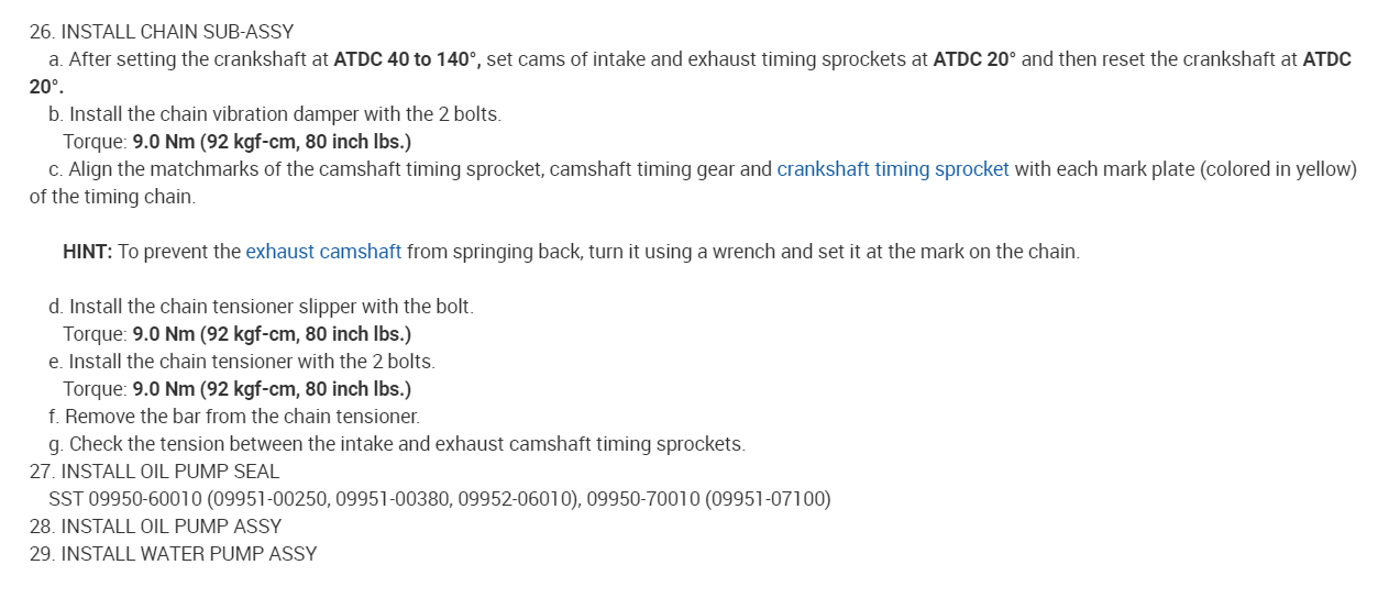

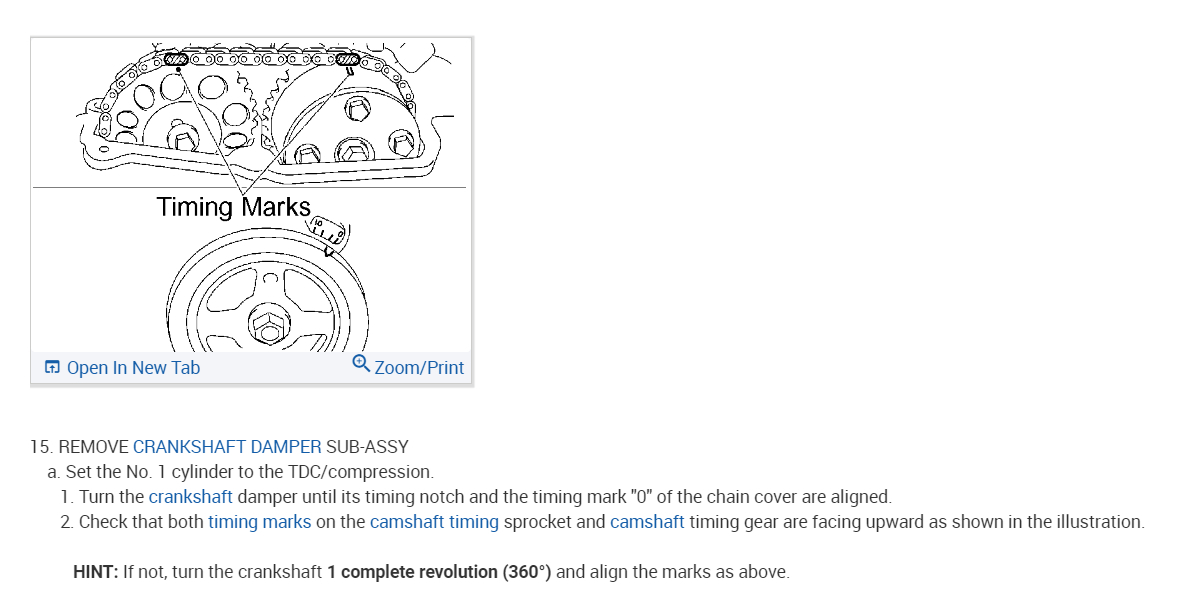

I took it to the shop they said the compression on number 1 75psi 2 80PSI 3 80psi 4 75PSI they wanted to remove the head to see if i had a burnt valve or head gasket. What weird is they said the car over heated. No such thing happened i drove the car home from work, it's only a mile from the house. The next day it wouldn't start.
Jun 25, 2022 at 8:24 AM
  • 55,423 POSTS

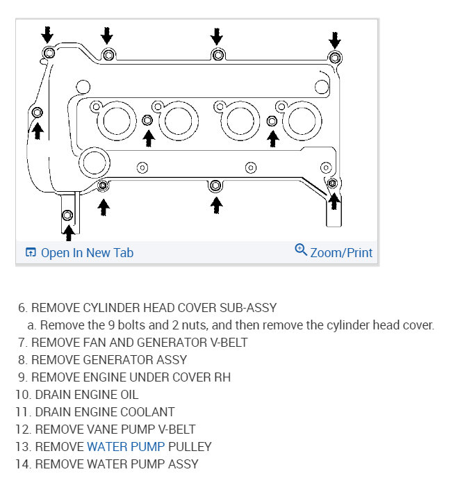

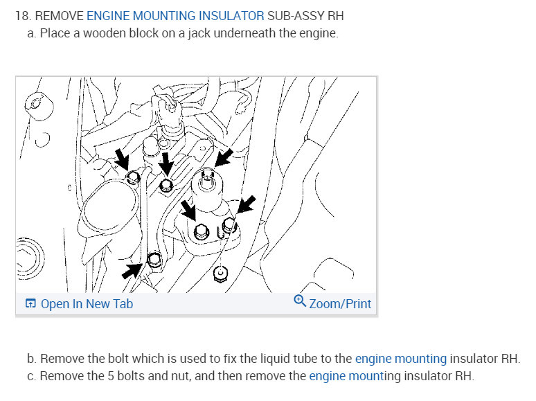

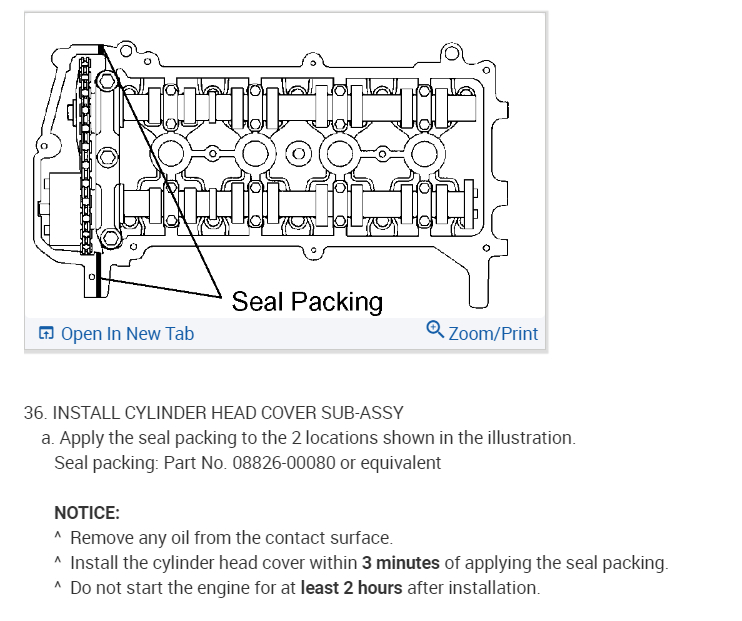

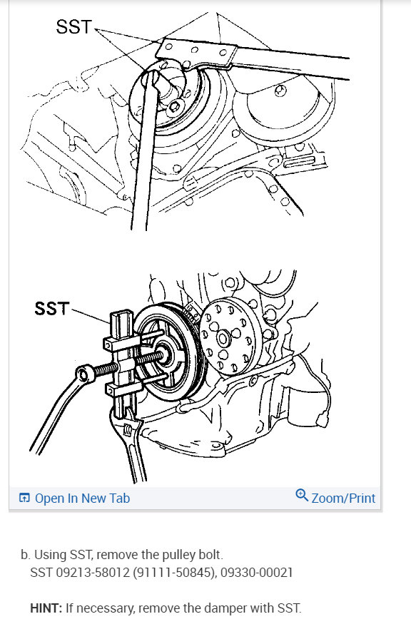

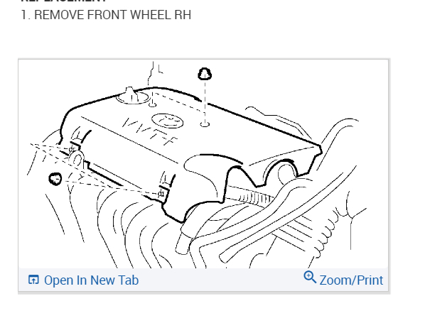

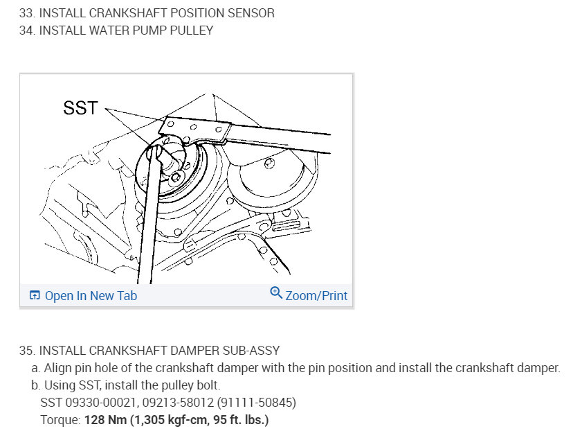

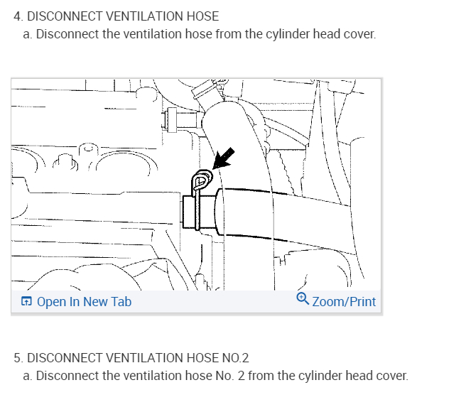

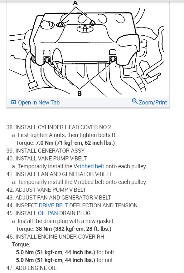

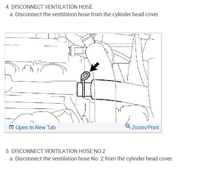

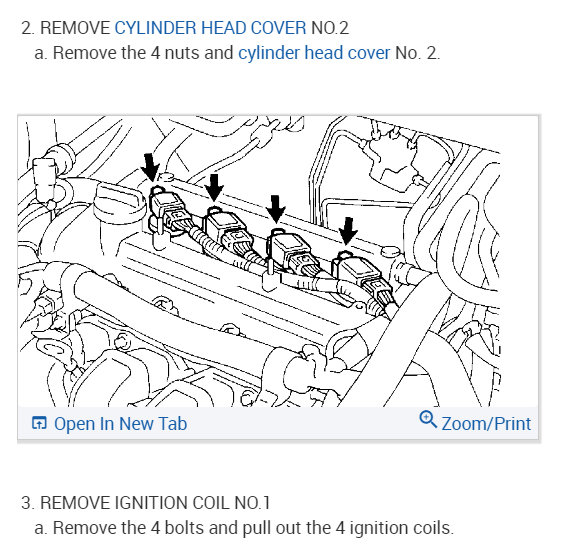

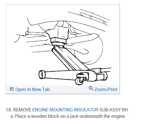

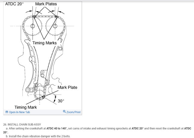

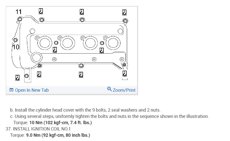

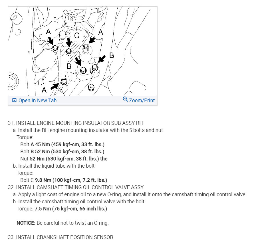

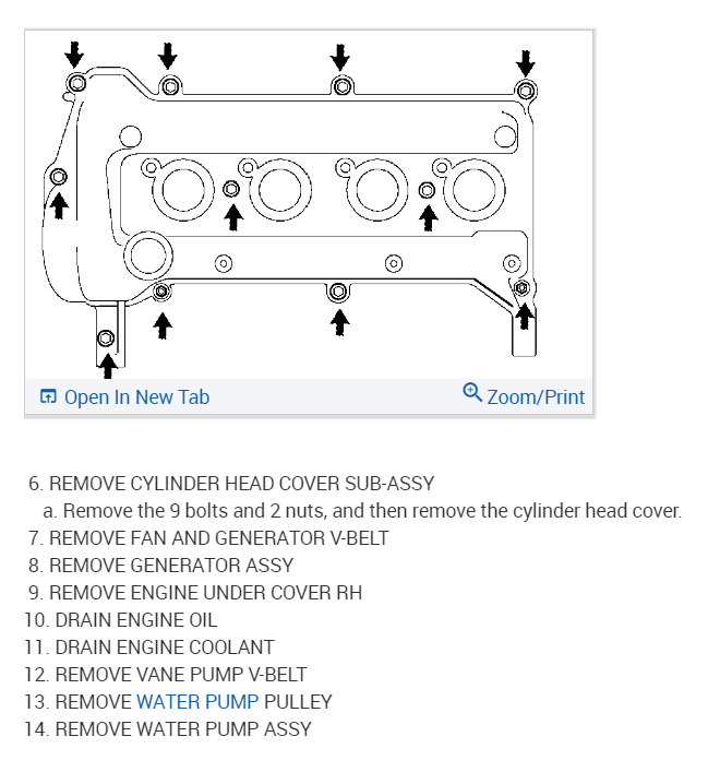

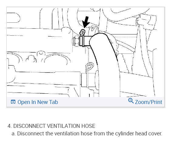

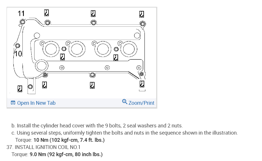

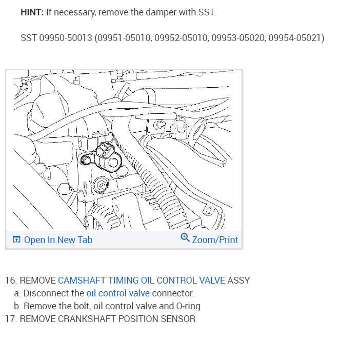

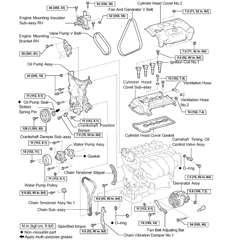

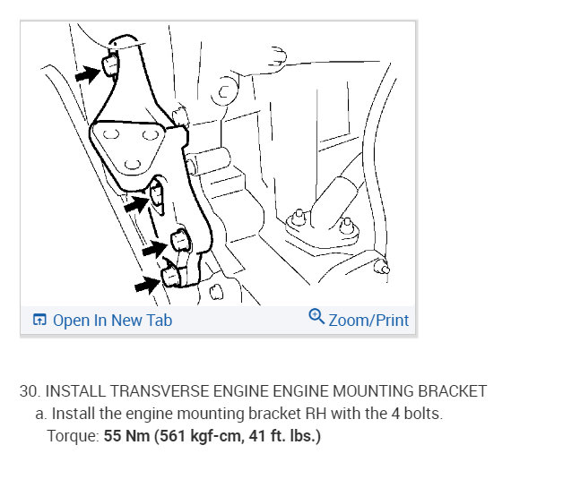

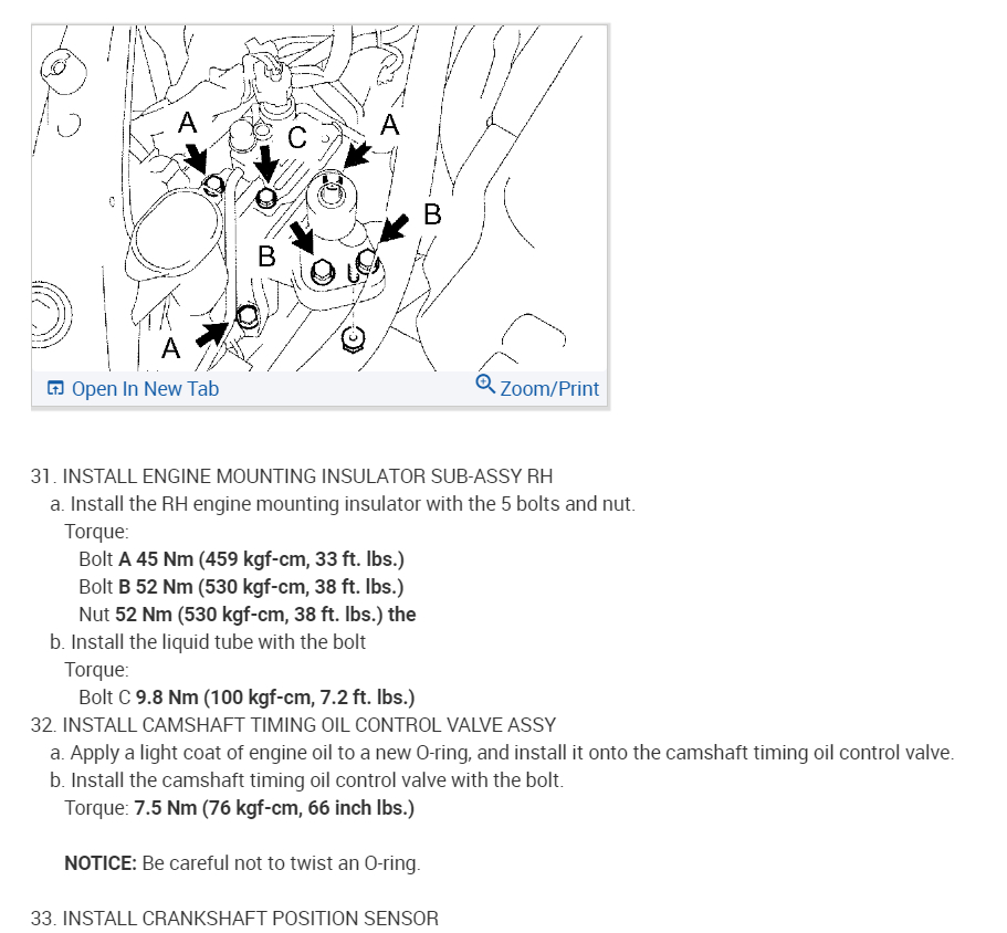

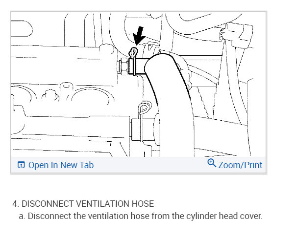

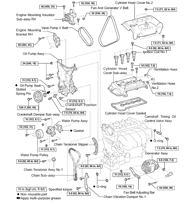

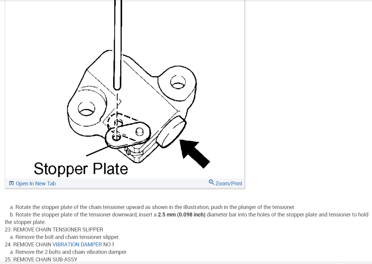

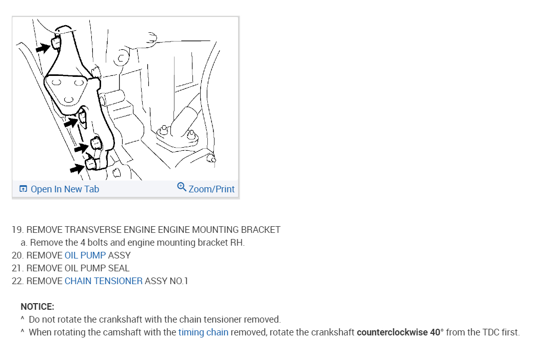

It sounds more like the timing chain has jumped a tooth or two. If it was a burnt valve or head gasket it would not affect all cylinders the same. Here is how to check the timing marks to confirm the failure. Also, was the engine making noise before the issue of not starting? You can check the timing marks by removing the valve cover. Here is how you can change the timing chain out in the diagrams below. It also shows how to change the timing marks.
