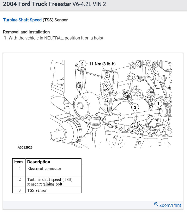

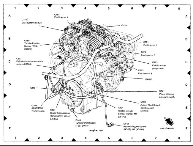

Transmission shifts from low gear to second gear but will not shift into high gear.
Aug 9, 2018 at 11:54 AM
  • 55,399 POSTS
This sounds like it can be one of two problems first how are the shifts from first to second? If it shifts late then you can have a plugged catalytic converter. Here is a guide to confirm the issue:
If that checks out it could be a input shaft speed sensor that is not reading correctly. Here is a video of a sensor getting replaced on another car and the location of the sensor for your car is in the diagrams below:
https://youtu.be/f3bETtCIdxM
