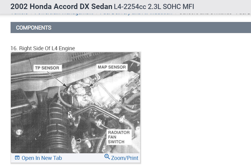

It is giving a p0122 code. I replaced the MAP sensor, and it still has the code. Where do I check now? it revs up a little and back to idle and eventually shuts off. I thought I overheated it. I pulled the head. replace timing belt, water pump, plugs, wires cap and rotor. Had the checked and resurfaced.

P0122 Throttle Pedal Position Sensor/Switch (TPS) A Circuit Low Input. so I would replace the TP sensor which is location on the side of the throttle body. Here is the location in the images below. Please let us know what happens.
