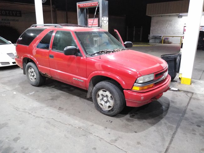

Okay, so here is my problem. It was running last week but rough backfiring in the cylinders and acting like it was not getting enough fuel. So naturally I looked at the fuel system pump seems to be turning on and working, no leaks, and seems to be getting to the injectors. Replaced the filter and it ran a little better but not much. Stopped and had the codes read and it had a few but I need to get a new reader to tell you them all I know that four of them where the knock sensor, mass air flow, and two o2 sensors. So I replaced the maf sensor, air filter, and tried to start it but now it only runs for a few seconds then fades out and stalls it will start up again but will not idle no matter what I do and I have looked at what I can think to look at so any ideas? I also know it is not the injectors since it also had no signs of that either.
Oct 30, 2018 at 5:16 AM
Good afternoon.
This sounds like you have a vacuum leak, dirty throttle bore or the IAC motor is not working but to be sure lets check out these guides to help us fix it.
and
and
if okay the first thing I would do is check the actual fuel pressure. Low fuel pressure will cause all these codes.
You can rent a tester at a parts store. There is a test port on the supply line back by the distributor. The tester just goes on that fitting for the test.

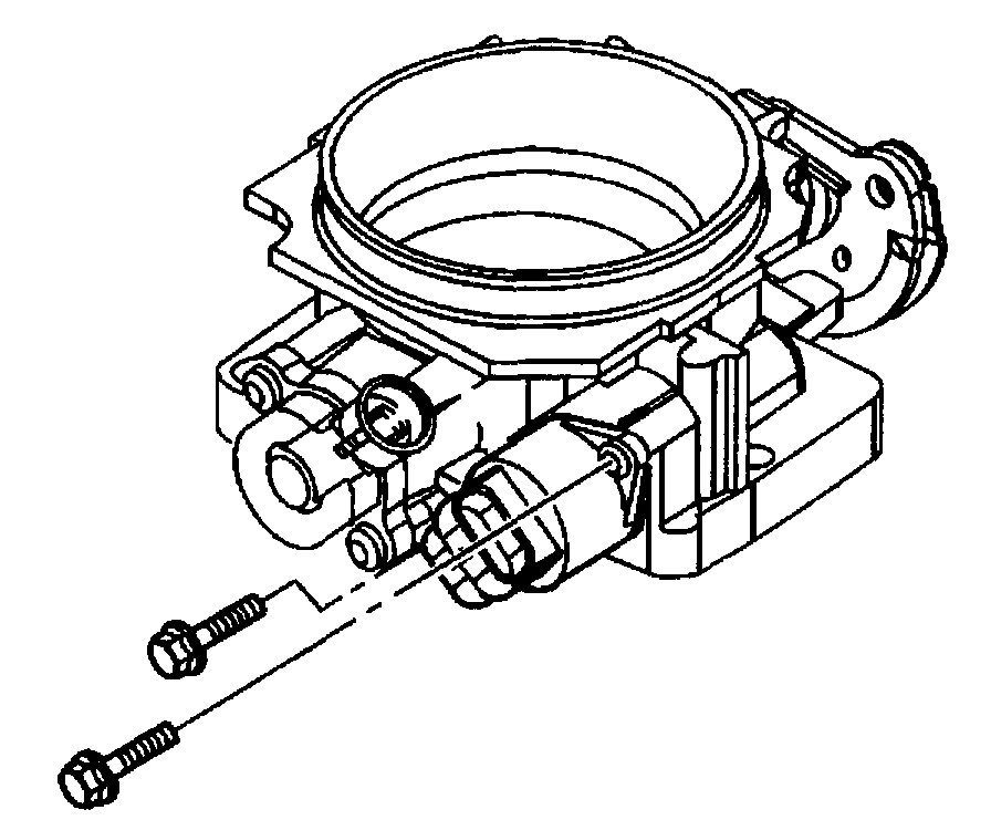

Here are directions specific to your vehicle for replacement. The attached pics correlate with the directions.
________________
2002 Chevy Truck S10/T10 Blazer 4WD V6-4.3L VIN W
Procedures
Vehicle Powertrain Management Fuel Delivery and Air Induction Idle Speed/Throttle Actuator - Electronic Service and Repair Procedures
PROCEDURES
IDLE AIR CONTROL (IAC) VALVE REPLACEMENT
REMOVAL PROCEDURE
pic 1

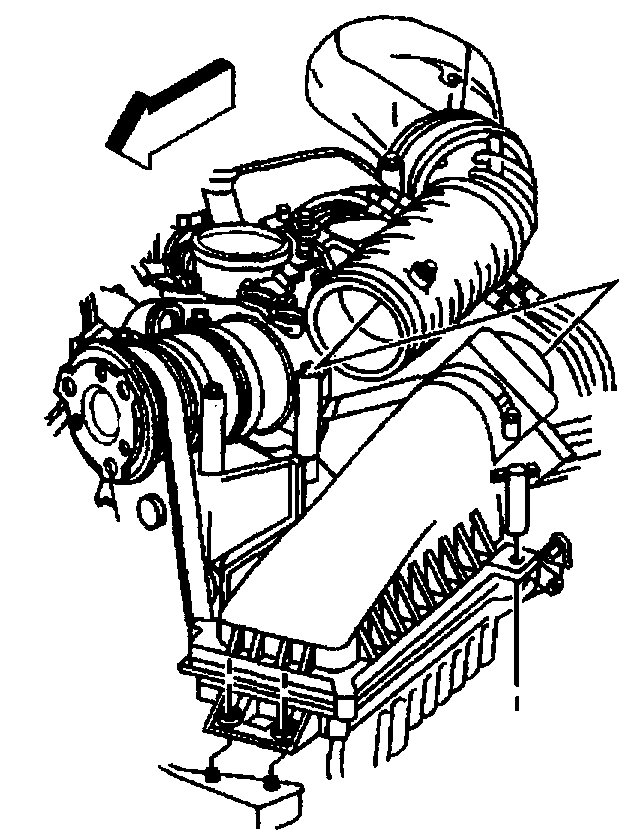

1. Turn OFF the ignition.
2. Remove the air cleaner outlet resonator.
3. Disconnect the idle air control (IAC) valve harness connector.

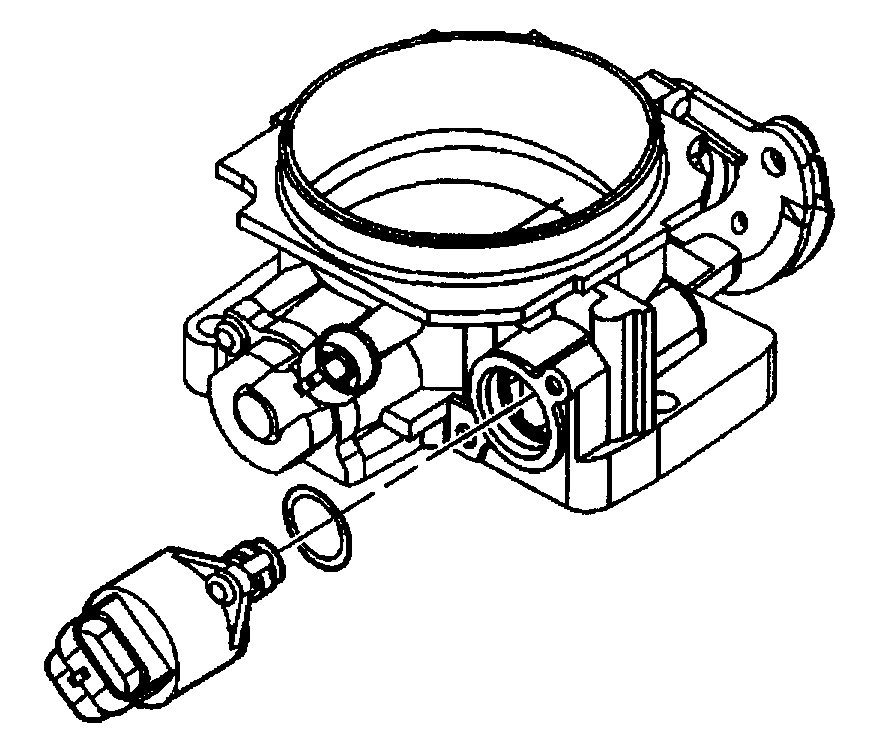

pic 2
4. Remove the IAC valve mounting screws.
pic 3
5. Remove the IAC valve and O-ring from the throttle body assembly.

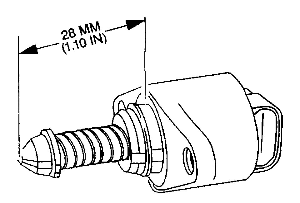

IMPORTANT: Use an identical pan when installing a new idle air control (IAC) valve. The IAC valve pintle shape and dimensions are designed for specific applications.
pic 4
1. On a new IAC valve, measure the distance between the IAC valve pintle and mounting flange. Use finger pressure to slowly retract the pintle if the distance is more than 28 mm (1 - 1/8 in).

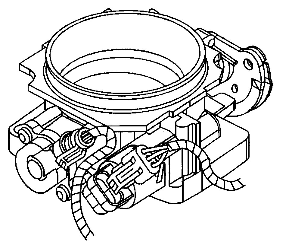

pic 7
6. Connect the IAC valve harness connector.
pic 8
7. Install the air cleaner outlet resonator.

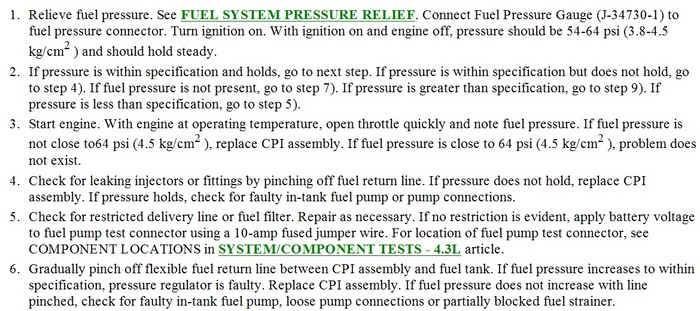

JDL
  • 16,098 POSTS
Some of my info says 54--64 psi. It also says, with engine running, quickly hit the throttle while watching the gage. Should be close to 64psi, if not, replace the spider system.
Jan 30, 2021 at 12:50 AM (Merged)

The problem is I can't get it to start and idle. My book says turn the key on and pump should run for 2 seconds then shut off, which it does. Then the book says after the pump shuts off the pressure should hold steady, which mine doesn't do. It jumps up to 63 when pump comes on but, as soon as the pump shuts off it drops to around 25 then slowly keeps dropping. It gets to 20 in about a minute, am I doing something wrong? I'm doing what the book is telling me to do...
JDL
  • 16,098 POSTS
Engine cranking, do you have spark at the plugs? Do you have an injector pulse, use a noid lite.
You should have pressure also with engine cranking? With fuel pressure loose, possibilities, pressure regulator leaking-- fuel injector leak-- pressure is leaking back through the fuel pump. Any applicable trouble codes? Are you fully obd1 compliant?

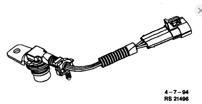

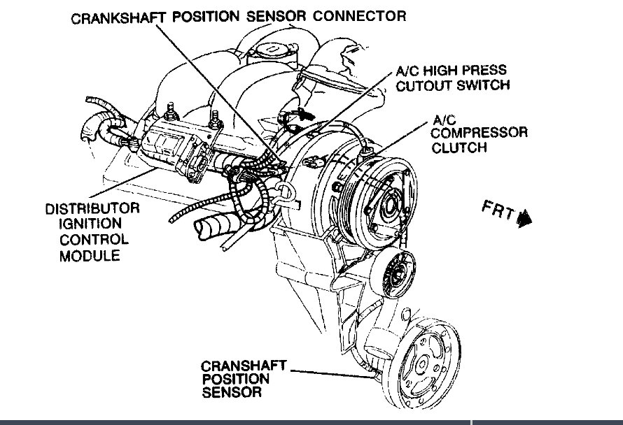

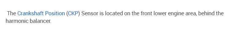

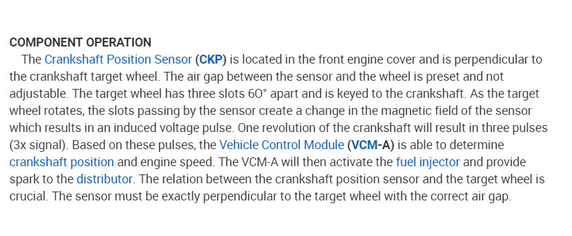

SCGRANTURISMO
  • 4,897 POSTS
This could be a problem with your vehicle's Crankshaft Position Sensor (CKP) starting to fail. The CKP sensor is used by the vehicle's Vehicle Control Module (VCM) to determine the rotational speed of the crankshaft and uses this signal to start both spark and fuel injector control. When the CKP starts to fail, it will fail when it starts to get warm. I have included a few links for you to go to below:
https://www.2carpros.com/articles/how-a-crank-shaft-angle-sensor-works
I have also included location and operation information in the diagrams down below for you as well. Please go through these guides and get back to us with what you are able to find out.
Thanks,
Alex
2CarPros
