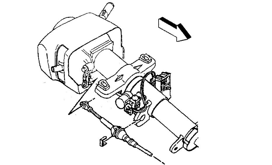

Hi guys! I have the van listed above signature series (automatic) and I have not been able to shift into park. The car turns on in neutral and I am able to remove the key.
The car drives without a problem, shifts into reverse, neutral, third and I believe second no problem but won't go into first or park.
The owner before me replaced the gear stick/ shifter less than six months ago.
The gear stick is not loose, the shift linkage is attached but I have no idea how to check if it is the problem. I have looked under the steering wheel to tighten bolts that people said could be the problem but couldn't find them.
I have tried to troubleshoot problems but had no luck.
I have disconnected the battery but need the car daily for work.
Any help is greatly appreciated!

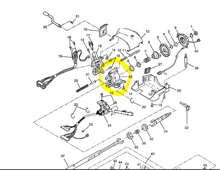

Do you have tilt column and does it feel loose when you move it up and down?

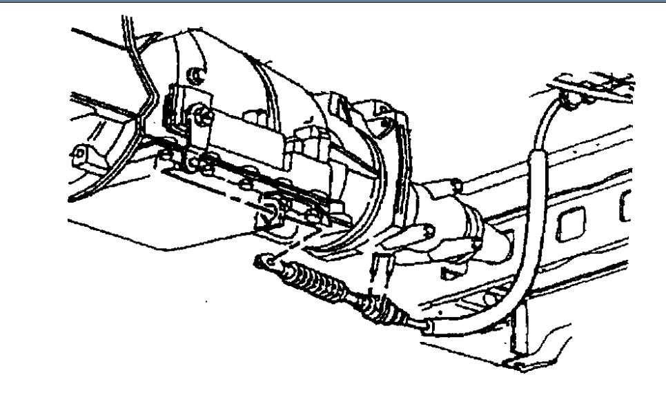

I would also go under the truck and disconnect the cable at the transmission. Then see if you have the park and first position. That will eliminate the transmission as the problem.
The piece that gets loose, I circled for you. You have to take the column apart to access the 3 bolts that get loose.

Thanks Roy, no tilt column.
I went under the car and disconnected the cable and the transmission shifts all the way to park and 1st no problem but as soon as I reattach the cable it won’t move again. Good to know it’s not the transmission..is it possible that the shifter cable is preventing me from shifting into park?
I believe I found the piece in the diagram but but it was secure, nothing loose.

Yes, very possible the cable is the issue.
I would replace the cable.

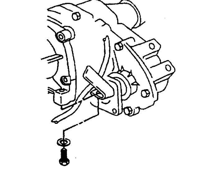

2. Remove the clip from the bracket that secures the shift cable to the transmission.
3. Remove the shift cable end from the transmission shift lever stud ball.

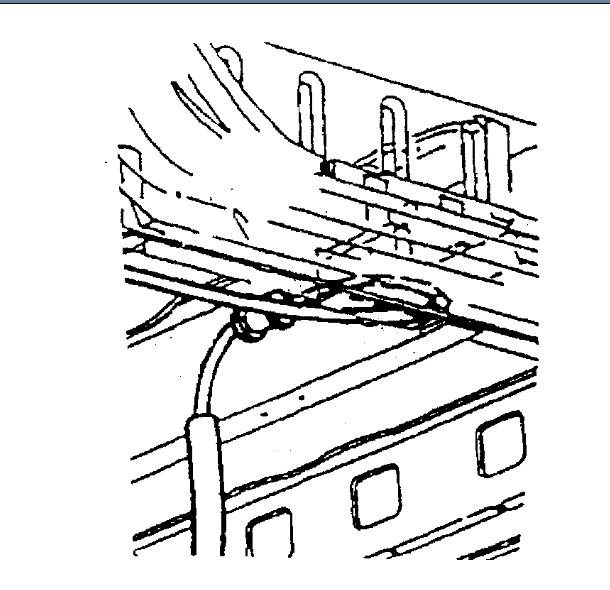

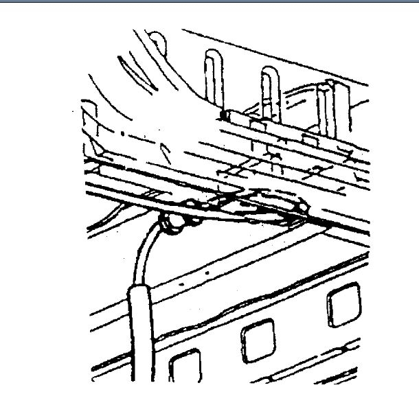

4. Remove the three shift cable clips from the body.
5. Remove the grommet from the hole in the floor panel.

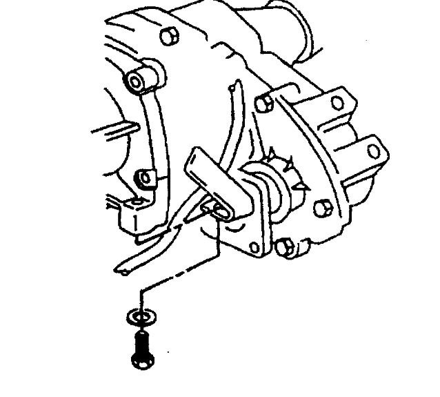

6. If the vehicle is equipped with a transfer cage, remove the bolt and washer securing clip and the shift cable to the transfer case.

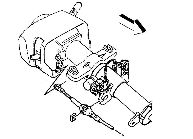

7. Remove the clip that secures the shift cable to the steering column bracket.
8. Remove the shift cable end from the steering column shift controller stud ball.
9. Remove the cable from the vehicle.
Pull the cable from under the vehicle.

3. Connect the shift cable end to the steering column shift controller stud ball.
4. Install the clip that secures the shift cable to the steering column bracket.
